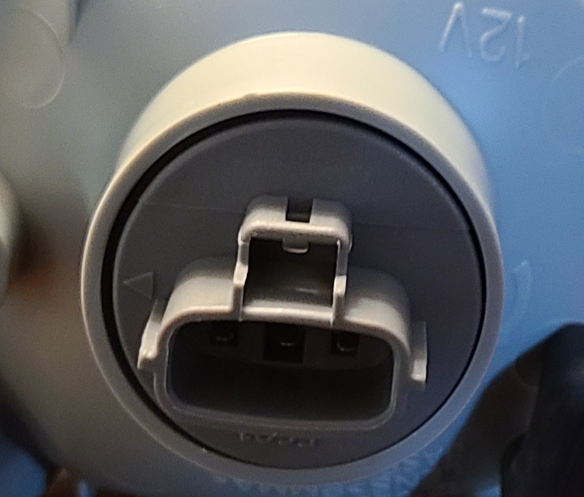

Need more information on front turn signal assemblies and bulbs for '05 SR5
I thought I had DRL, but when installing new front turn signal housings and LEDs today, I found that the new housing's bulb connector is larger than the old one, so I assume I do not have DRL.
I am having difficulty finding passenger and driver side front turn signal housings whose connectors are not for DRL bulbs.
Is there an adapter that will permit the connection between the old and new connectors so that I can use the new housings and LEDs I just purchased?
Here is the connector on the new housing.
