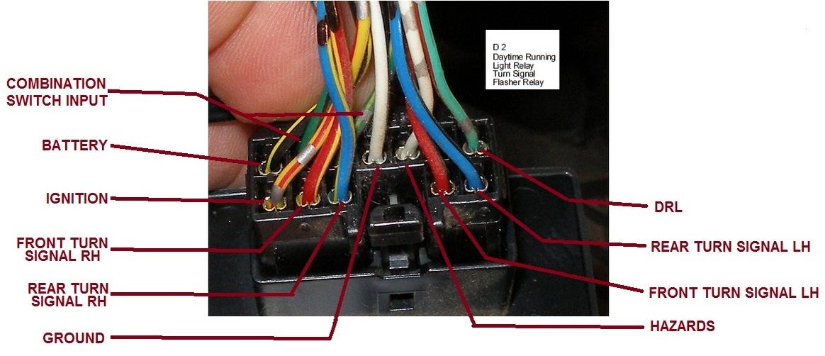

Check power TO the relay first, before ordering anything. Check the fuse, then check the power at the relay.
I made this little diagram for myself a while back. It should help you in this instance as well. The picture is of the DRL / turn signal relay connector.

thanks A/V1! That helps a lot for the future. I bought a new relay from the dealer and installed myself. All good now! Well except one burnt bulb that needs replacing. Thanks for the help everyone! :)
