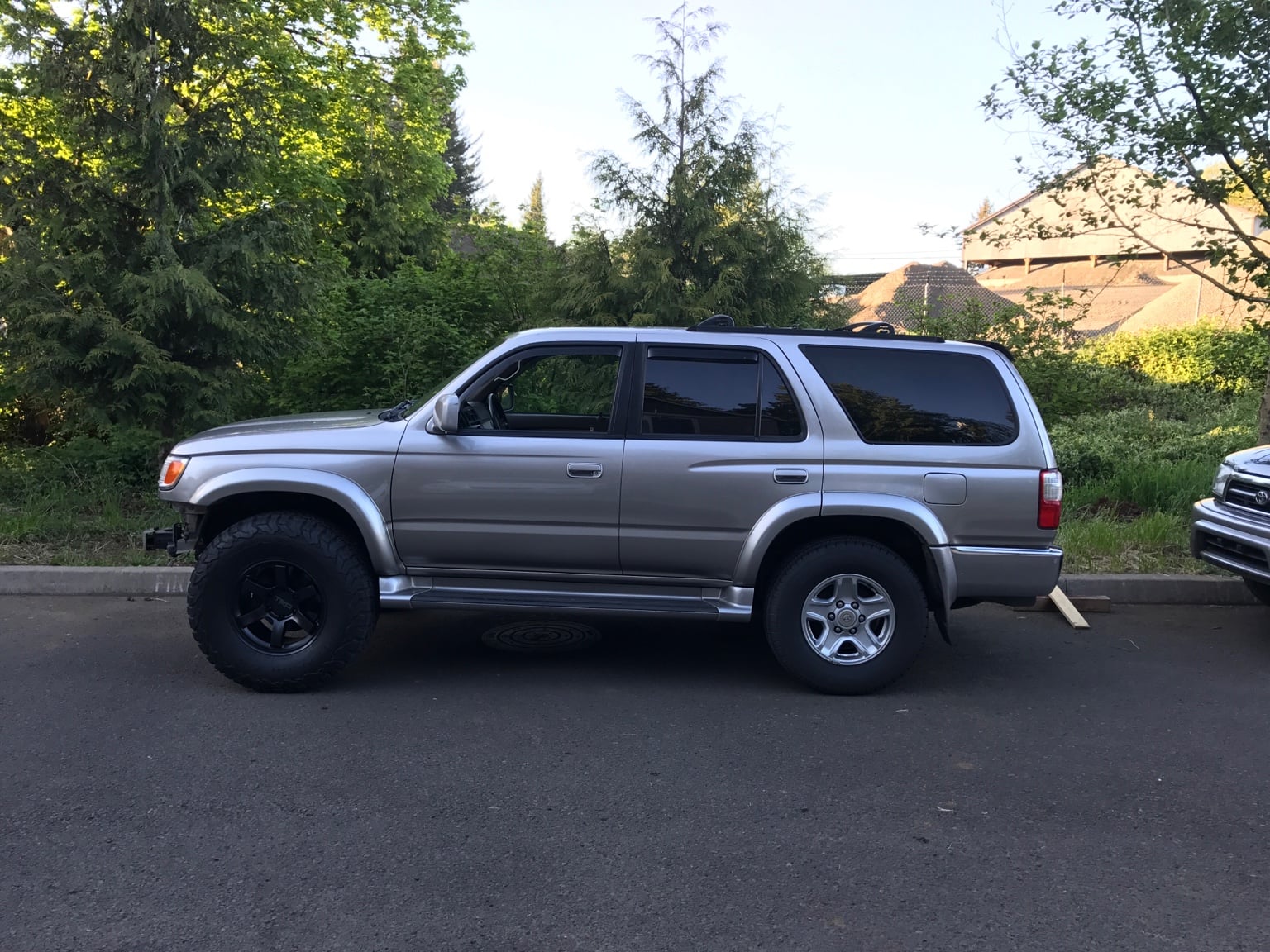

[MENTION=7105]Scramble[/MENTION] asked me "Are you building the ultimate 3rd gen?!", and I'm like "well, actually I am!". That is, of course, my own opinion. It's not going to be anything extreme, just my version of the "ultimate" 3rd gen 4R.
Like my '97, I'm going for OEM+ on this rig too.

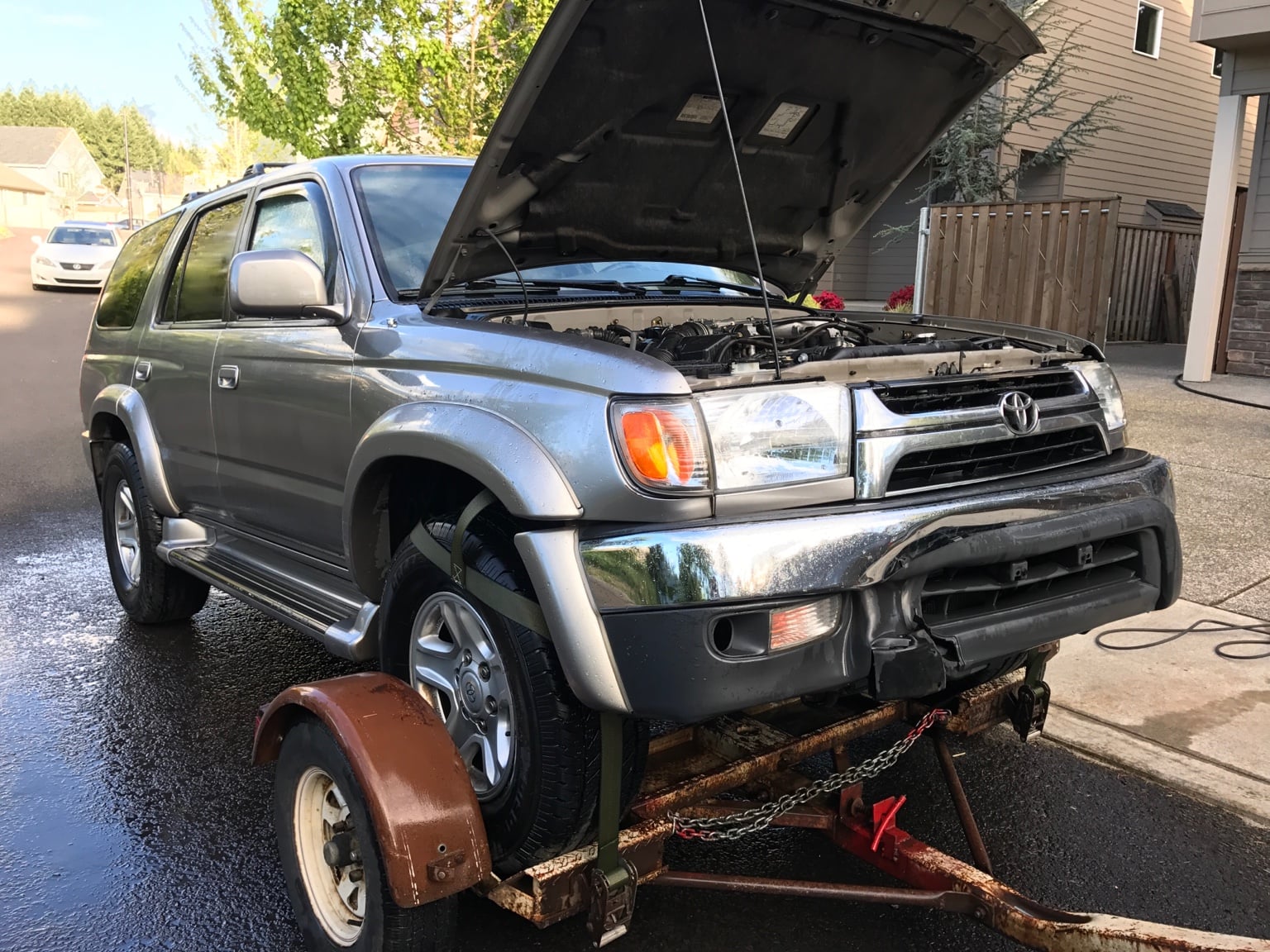

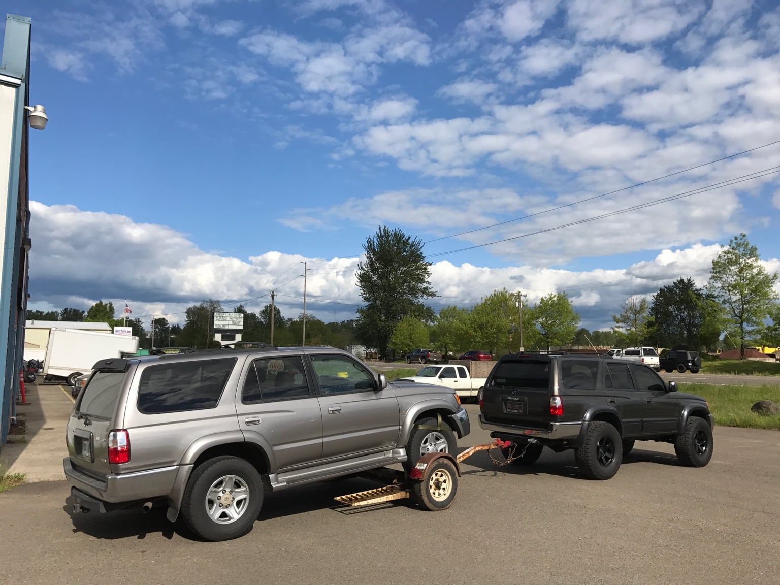

Here's the moment I picked her up-
Pretty nasty dirty inside, and more door dings than my '97, but that's okay. I'm good at cleaning nasty, and door dings can be taken out if I want.
When I picked it up, I started it- it ran super smooth- and put it in Drive to see what would happen. It was like the TC was locked up; it lurched forward and died.
Got it loaded up, got it towed home safely, and went to work cleaning it up.

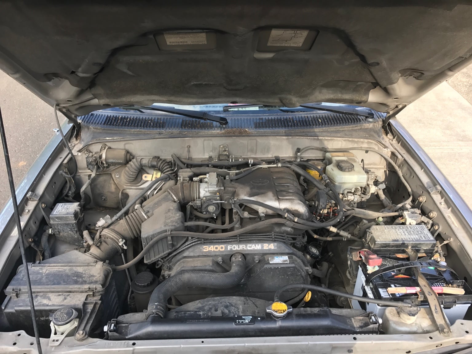

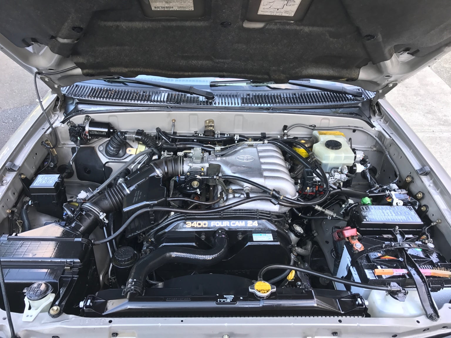

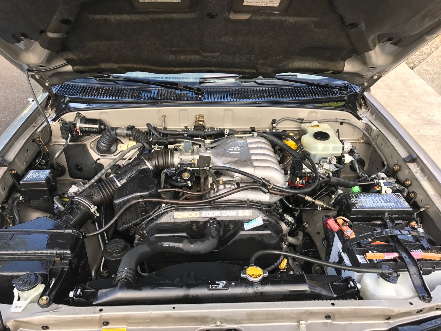

Started with the engine bay-
Time to unload it. I decided to try to back it off under its own power. That worked just fine [emoji15] Forward? Yeah; that worked fine too. Around the block? Shifted through the gears? Yup. So I'm not sure what's going on with the trans/TC, but I already have a trans from a '99 I picked up a couple years ago, so I'm gonna throw that in. Oh yeah- and it's a manual.

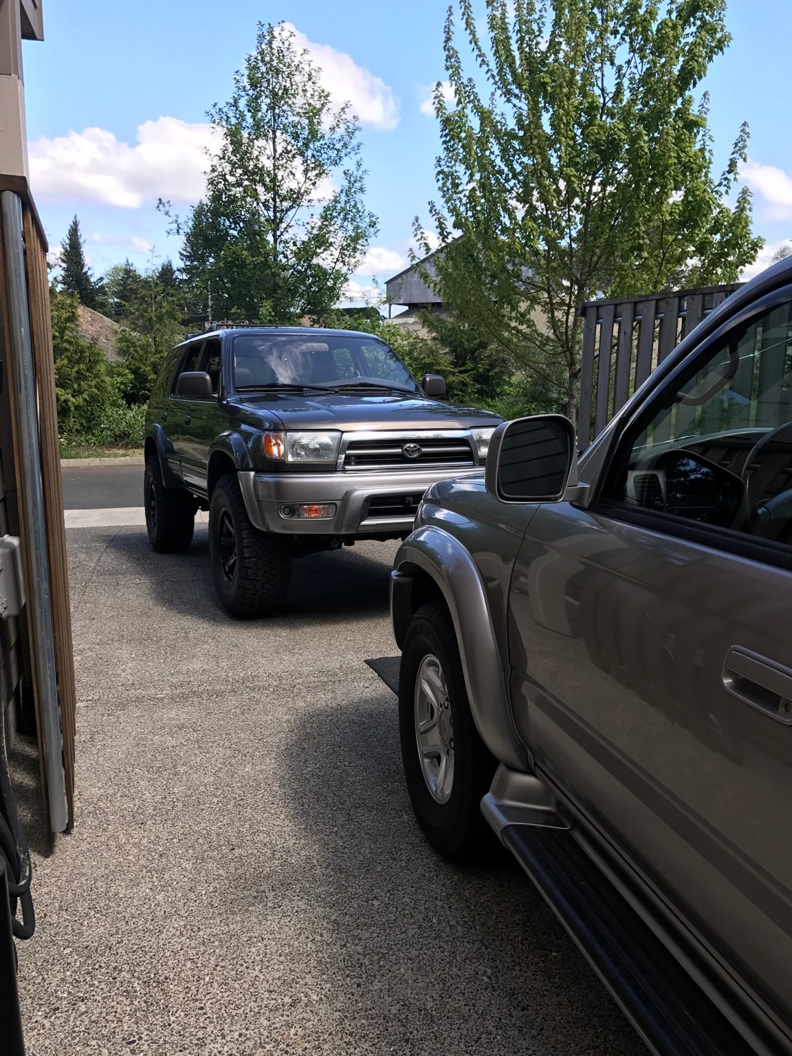

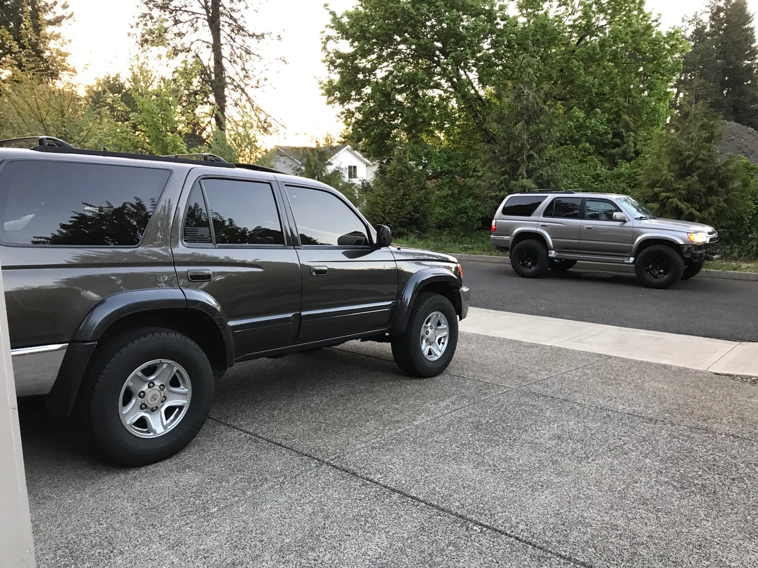

Picked the rig up Saturday, and spent most of Sunday swapping suspension from my '97.
That brings to my attention how awesome it is I never had the '02 Thunder Cloud bumper I got from [MENTION=124101]Chim[/MENTION] painted Anthracite or Dark Gray! [emoji1598]

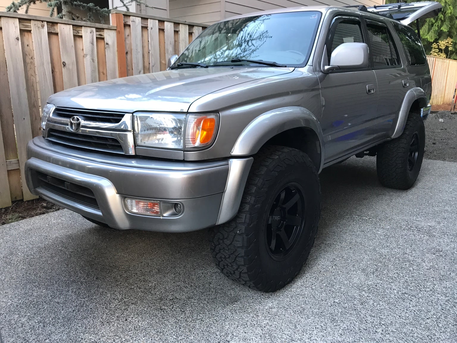

The bumper on the '01 was chrome, and also completely trashed-

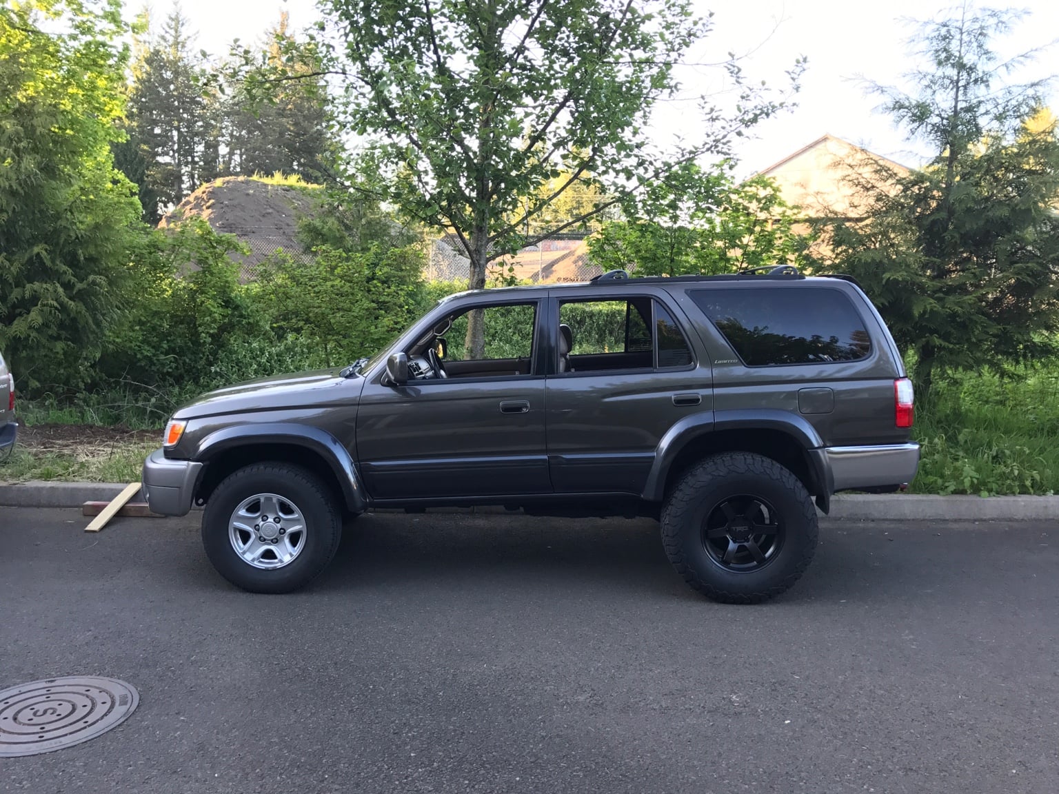

Spent a good 9 hours swapping suspension. Half way point-
It would have taken less than half as long, but I had to swap axles and knuckles too. I had 2WD knuckles on the '97 temporarily, and I- obviously- wasn't going to sell the '97 without having 4WD.
Swapped-

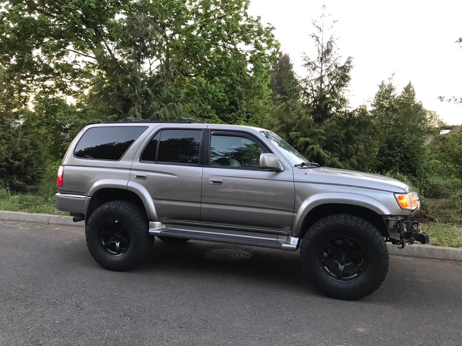

Took the running boards off, and got the front bumper swapped on to the '01-

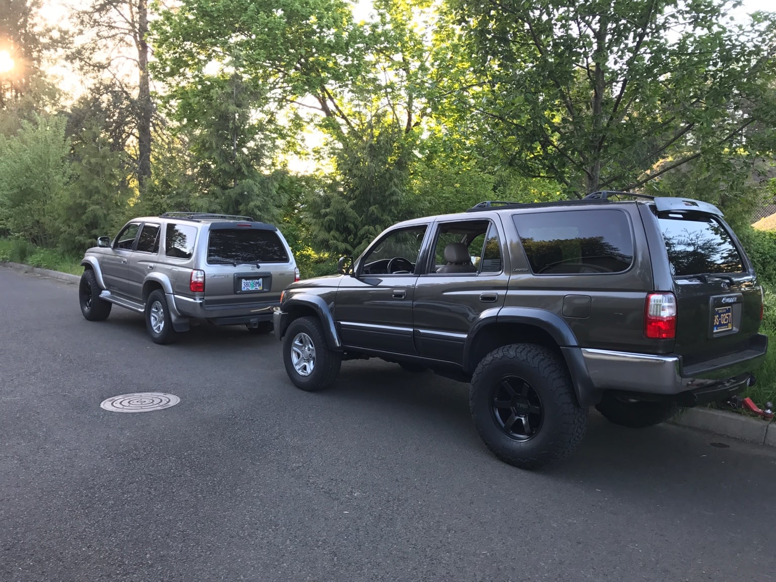

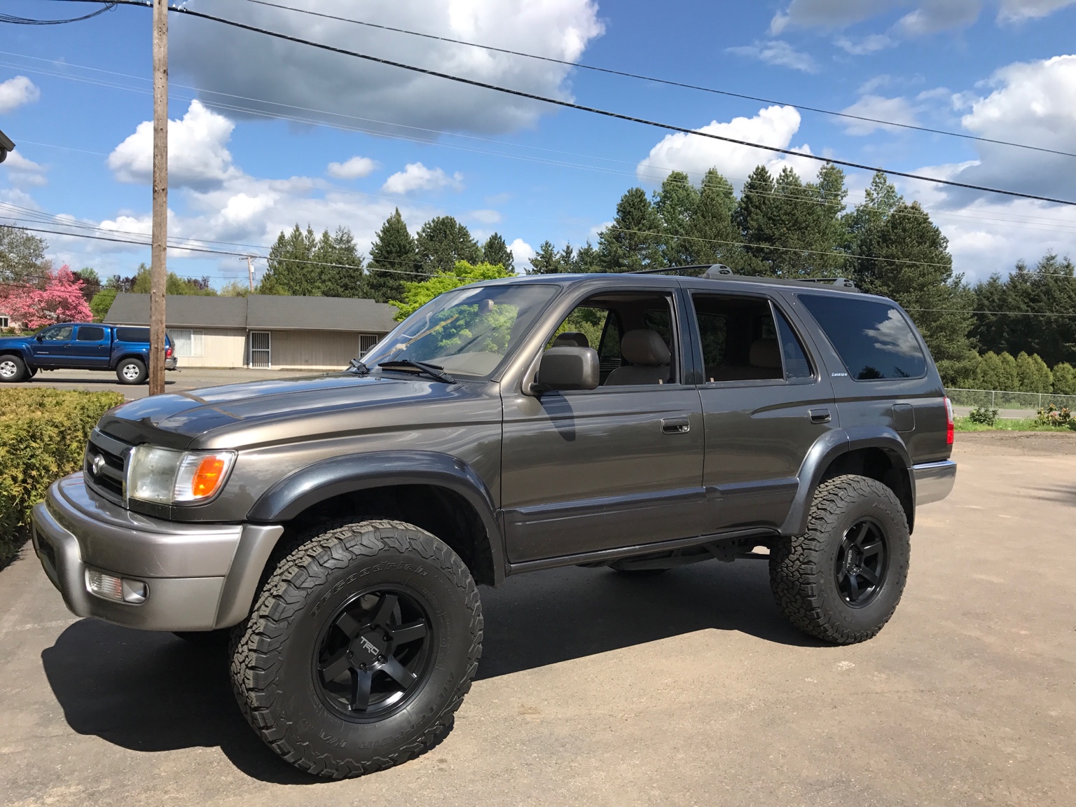

For those who may have have not seen it before, my '97-

I think I may have bugged you before on this, not sure but... what the hell do you clean your engine bay with!? beside hot water.
You should do a write-up on engine bay detailing, looks fantastic. I'm guessing a lot of armor all involved.
Thanks guys. I love a showroom-fresh engine bay. I try to keep the bottom side and interior as clean as I can too. I don't care if it gets muddy and dirty, because it's easy to clean if it doesn't get outta hand. I vacuum and clean the interior every weekend- it only takes 10 minutes or so. Starting the week with a clean rig makes my week start so much better.
Anyway, I just spray it down with Simple Green, let it sit for a minute or so, and pressure wash it with hot water. I use a microfiber to wipe down and dry off as much as possible. This is what it looks like after that-
After that, I use my favorite dressing- Stoner Trim Shine AEROSOL.I I coat everything I can get to. It makes it super easy to keep clean too.

Last question, do you do straight up hot water in the pressure washer and it's safe for both the washer and all the rubber/plastic without melting it, or do you mix in a little bit of cold? Asking cuz I have my water heater set to super duper hot setting.
I'm gonna get a valve put in on the side of the house as you have this summer.
I was always curious about the spray used for the engine compartment that you pretty much see for every car on a used car lot. Does it leave a sticky residue? Is it slimy like Armor All? I wonder if it would make electrical and hose connections harder to get off. It does make the engine compartment look really nice.
Related to this subject, one of the reasons why I shy away from buying a used vehicle from a used car lot or dealership is for the cleaning they do before they put it up for sale. I want to see what the engine bay and underneath looks like so I get a better idea of what I'm getting myself into fluid leaking wise. If it's all cleaned up and beautiful everywhere, you're not going to know if you have any major leaks until you own it. But, if you already own it, cleaning it up really good like you did will facilitate you finding any leaks which is a good thing. Anyway, you might have a second career in auto detailing.
There are a ton of different shiny products out there. Some are grimy, some are sticky, some are like a clear coat, etc. I use the Trim Shine because it's just a silicon spray. It isn't greasy, slimy, or heavy. I've used a ton of different shiny sprays, and this is- by far- my favorite. I completely agree about the used car lot quick-turn detailing being a turn-off.
Thanks for the reply man.
Well, my water heater isn't turned up super high, and I'm sure the 20' of uninsulated PEX pipe- to the spigot- dissipates a fair amount of heat. After that, it goes through the 50' garden hose. Once it hits the pump, it's probably much cooler than straight off the water heater spigot. I use full-hot sometimes, but it makes my pump cycle weird, so I keep it to a minimum. I'm not really worried about it damaging the pump, but I can't assure you it won't. It's DEFINITELY not hot enough to melt any plastic or rubber though! [emoji1360]
