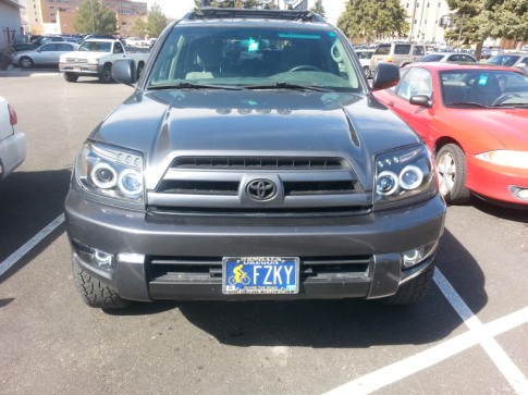

Black Halo Headlights
Removed Running Boards

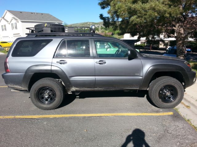

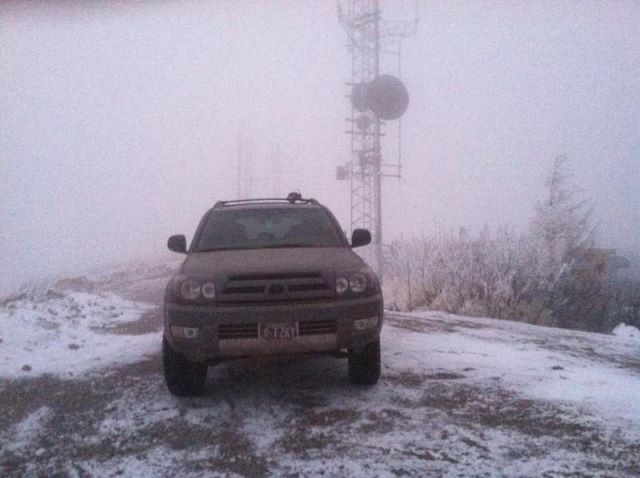

Here are a few photos of some recent activities of my 4Runner

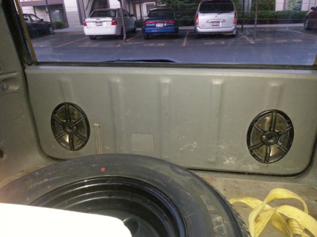

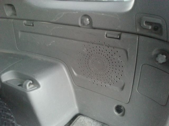

Here is a shot of my rear 6X9s installed in my back door panel

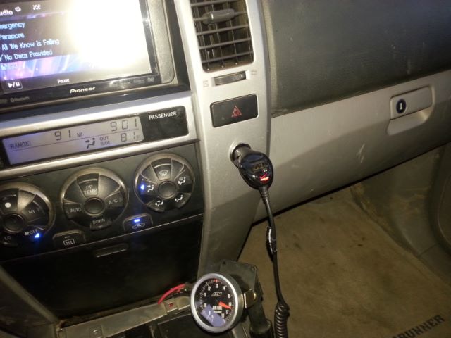

Constant 12V cigarette lighter installed

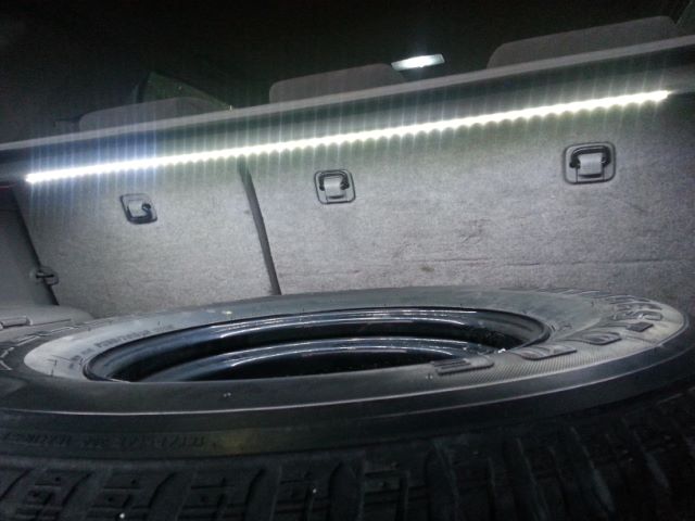

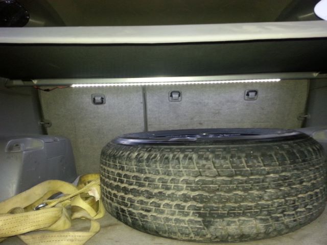

Cargo Cover LED light strip

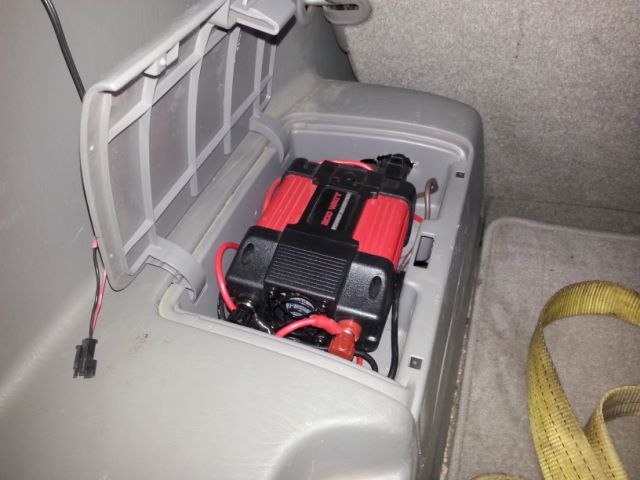

120V Power Inverter Installed in Cargo Compartment

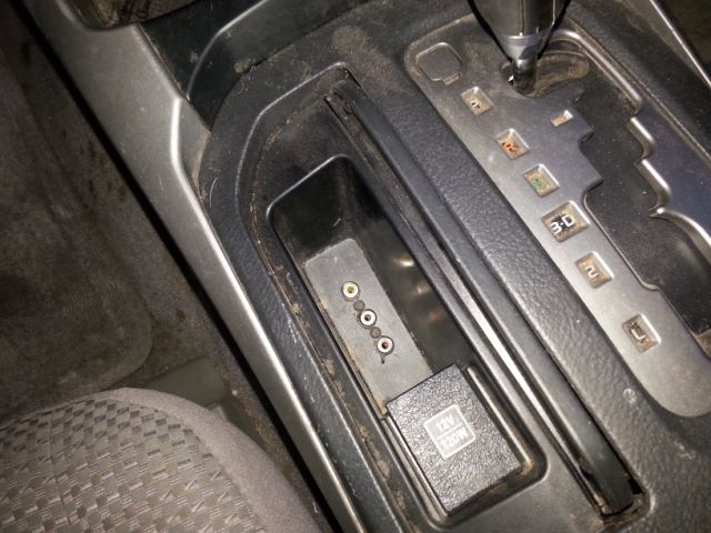

120V Power Outlet Installed in the back of the center console

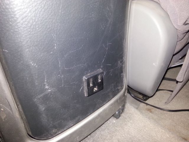

Can you elaborate on how you did the inverter? I've been contemplating that for a while.
Truck looks awesome man.
So i went and bought a power inverter from harbor freight, i think its the 200w inverter. i wanted it to be hidden so it looked clean, and since i never used the little storage bin things, i decided to place it in there. i ran a power from the battery and then a chasis ground through a hole i drilled inside the storage bin. then i got an old extension cord and plugged it into the inverter and ran it to the center console where i installed a plug outlet. its a pretty basic setup. let me know if you want anymore in depth photos of it.
and thanks

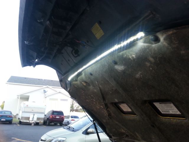

Hood LED Light Strip

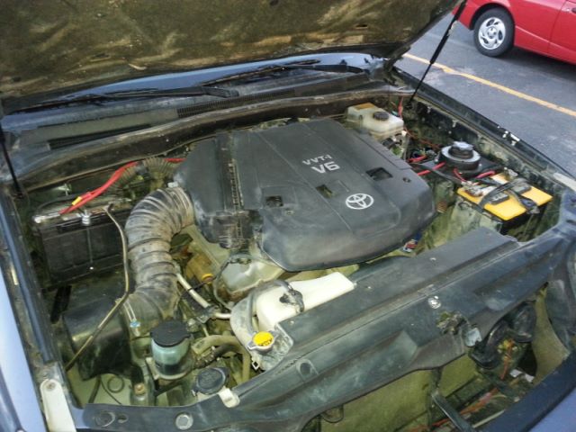

Dual Battery Setup/Engine Bay

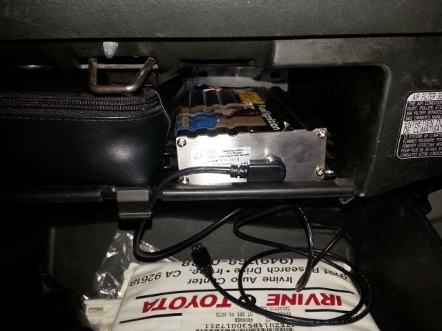

FIC 6 installed in the Upper Glove Box

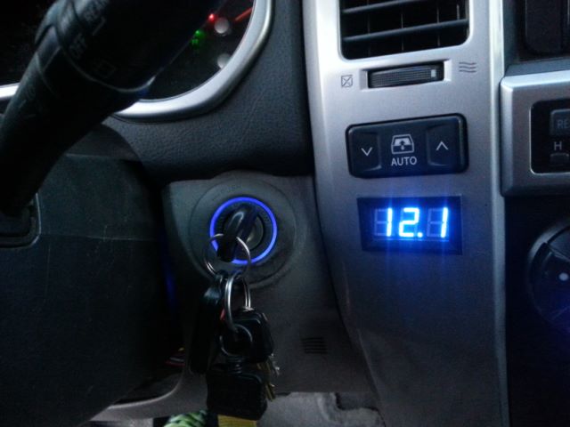

Battery Voltage Meter
RCA input plugs for my Pioneer AVH-2400BT

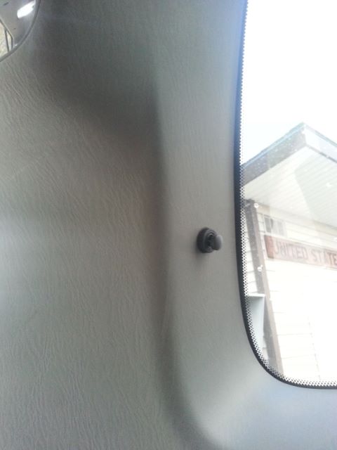

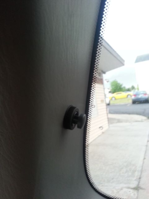

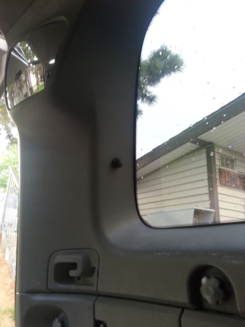

Since Im in college, that means there are partys and that leads to drunk people. Since Im the one with the suv in my group of friends, Im usually the DD by personal preference. Anyways, as i was saying, Im not a fan of people throwing up in my rig, so I usually put the super drunk people in the back of my rig (only when necessary) and the problem ive run into is that the person in the back of the rig cant get out until someone opens the hatch. so i decided to install a button to allow the person in the back of the rig to get out once the doors are unlocked.
All i did was wire in a normally open push button switch in parallel with the button on the tailgate. so when the button gets pushed it opens the hatch just like pressing the outside button. here are a few photos of the button installed and a video of it.
man nice build, I really like the rear hatch open button. genius.

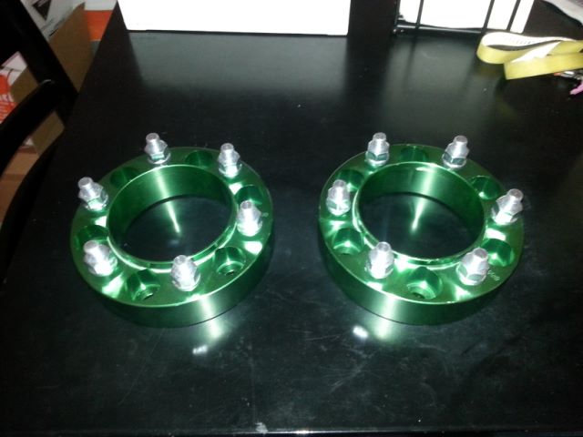

My ugly 1.5" green wheel spacers arrived today, now im just waiting on getting the rest of the wheels. Hopefully these guys will help my new wheels clear the massive front brake calipers that these 4runners are equipped with.

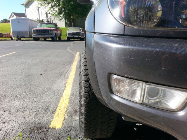

Finally got the rest of my wheels yesterday and I had them all mounted up today. The front have a 1.5" wheel spacer so my new wheels could clear the brake calipers.
Here is a side shot of the front tire to show the 1.5" wheel spacer offset.
I am waiting on my other 2 wheel spacers to arrive, then i wiil post some more photos of the rear wheel offset as well.

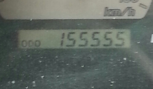

On the way back to Oregon from Idaho, I hit 155555 Miles on the odometer

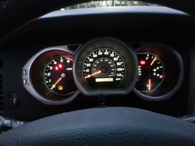

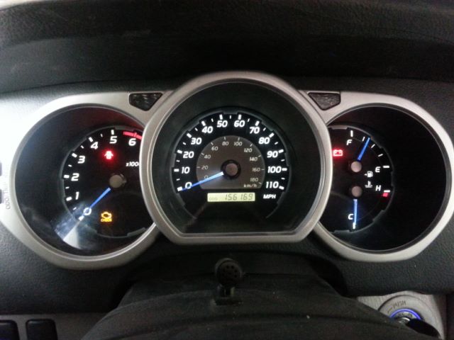

Changed My cluster back to white LEDs. It looks a little yellow in this photo, but it is actually more white in person
Changed to blue needles instead of the orange colored ones
