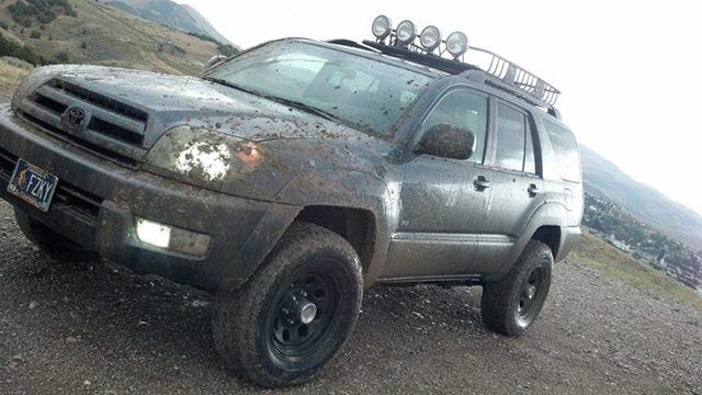

So last week Pocatello, ID had a massive rainstorm that flooded half the city, lets just say, it was pretty wicked. And when there is rain, that means there is most likely mud and massive mud puddles. So of course my friends and I didn't hesitate to get in our rigs and head out to the "playground". We found a small trail that had some decent mud there. After we got tired with the first trail, we headed to different trail. I had never been on the second trail before, but that didnt stop me. Im kinda bummed i didnt take my gopro this time, because the footage would have been pretty rad. Anyways, while on the second trail, there was a series of 3 massive puddles that were more like lakes at that point because of all the rain. The first puddle was about as deep as the top of the tires, so no biggy. Then came the second puddle, and let me tell you, it was no tiny puddle, it was seriously a lake. So before I submerged my rig into the "lake", I noticed a 04' dodge ram 1500 4x4 stuck right next to the "lake". And being the person I am didnt hesitate to go through the massive puddle/lake. little did i know, the lake was as deep as it was. when slowly enter the water, I soon found out it was way deeper than the first puddle. This time the water came up and over my hood and some then somehow during the process of getting out of the puddle, mud got flung up from behind my rig and over onto my moon roof. After we got out of that puddle came the third one which wasn't actually all that bad, it was probably the smallest puddle of them all. and after the last puddle was the end of the trail which led to a paved road. I'd have to say that was one of the best times in my rig. Kinda sketchy but at the same time, super rad.
Flooded Streets in Pocatello, ID
This is a Photo of the Flooded Underpass in Pocatello, ID
After Messing Around in the Mud
Another Shot After Messing Around in the Mud
Aftermath of the massive mud puddles and flooding

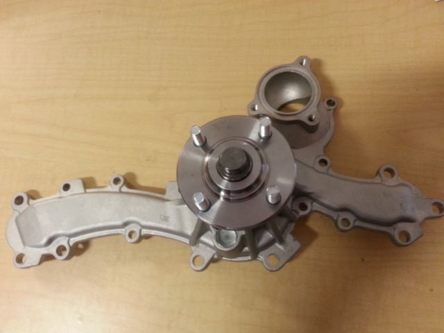

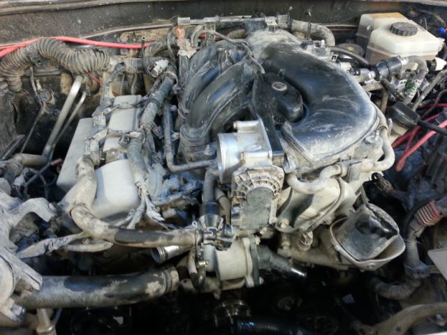

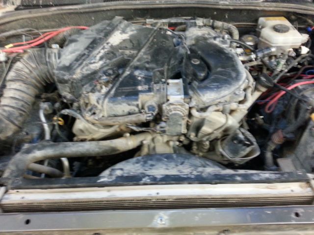

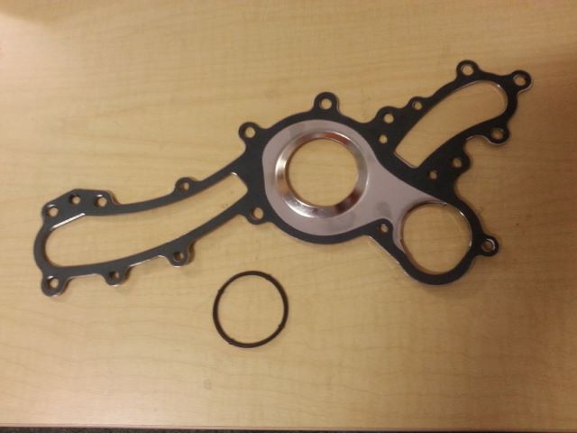

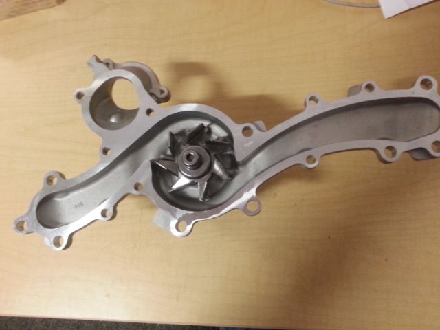

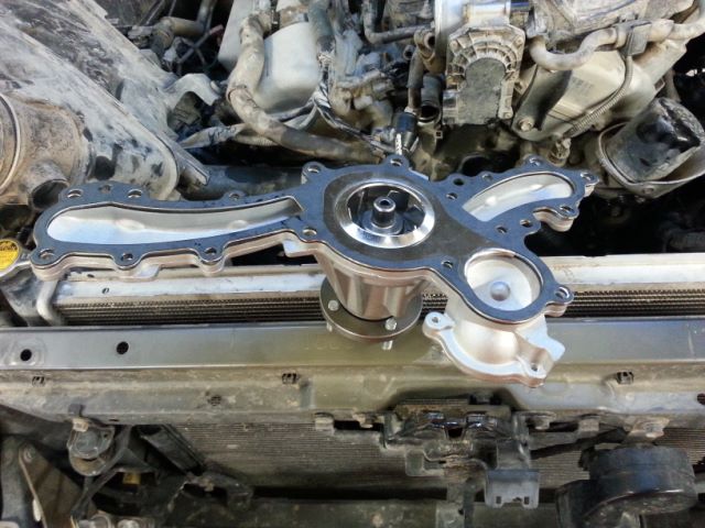

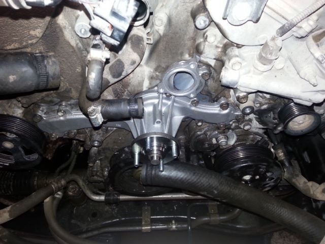

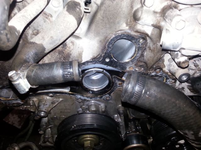

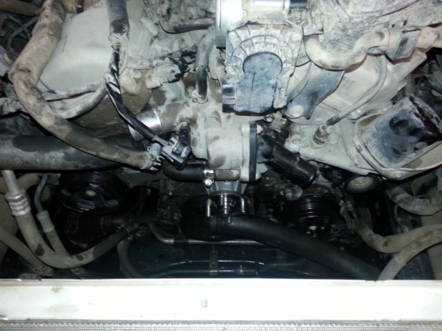

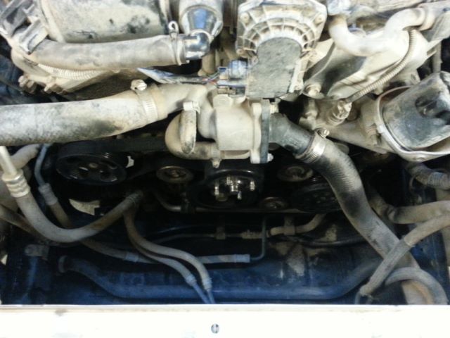

Water Pump Replaced

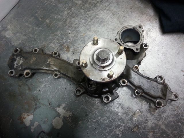

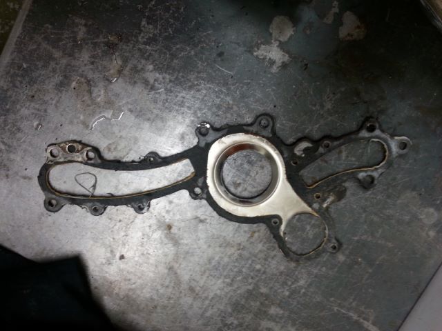

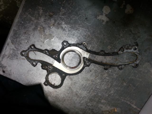

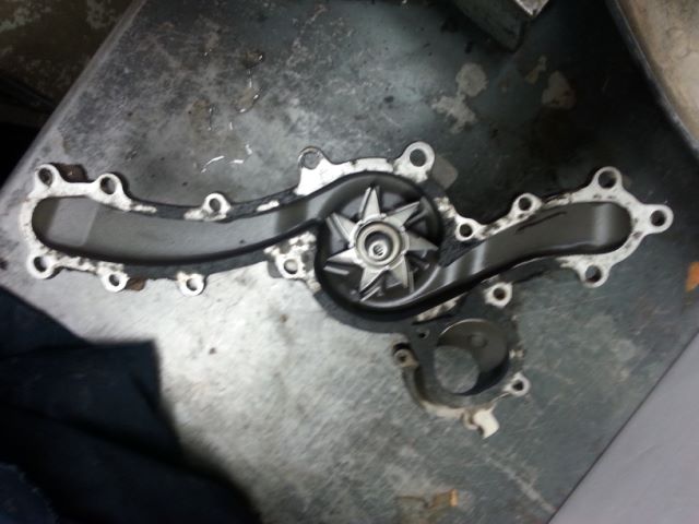

Installed my new water pump and gaskets today, only took me about 1.5 hours. it was pretty easy and i didn't run into any problems. I took a few photos of the process of removing and installing the water pump. The water pump itself was still in great condition, but the gasket was what went bad and caused my engine to leak coolant.

Here is the old water pump and gasket

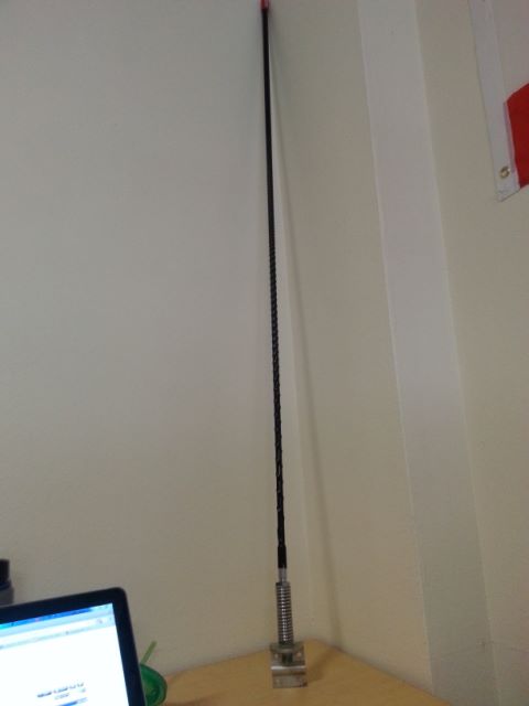

Free firestik
I got a free 6ft FireStik from a friend yesterday, so I now have a reason to install a CB radio. I don't want to spend a lot of $$$ on a CB radio, since I probably won't use it a whole lot, I will probably use the PA more than the CB part of the radio. I plan on just ordering the Uniden 40-Channel CB Radio (PRO505XL). Its only like $40 on Amazon.
