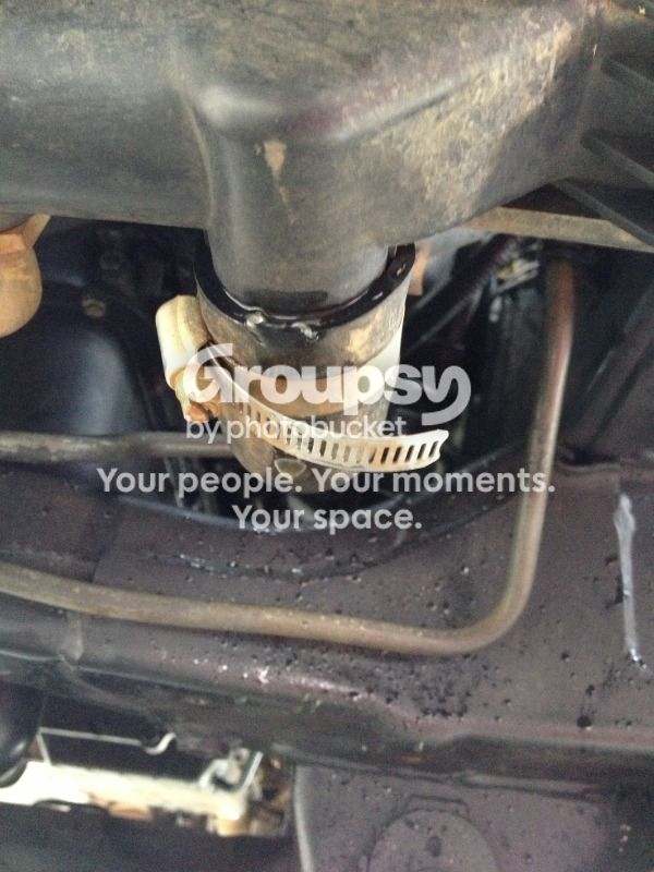

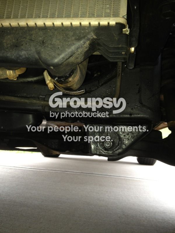

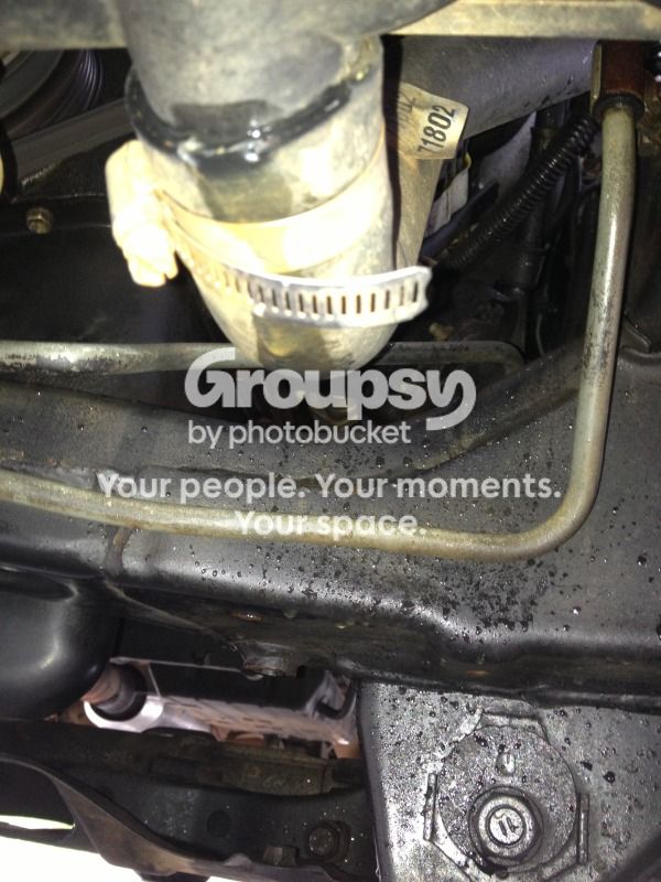

As you all know, temperatures dropped this past weekend. Because so, I ran the compressor today with the heat and noticed a new leak coming from the radiator hose:

I tightened the clamp on the hose but it wasn't that loose. Maybe that will do the trick?
Also, I bought this truck over the summer and this was the first day that I had run the heat. Could that have anything to do with it?
Running your heat won't have anything to do with it, coolant is always flowing through that hose, its the coolant return.
I might try moving that clamp closer towards the end of the hose, might give the clamp a little more bite
Since you bought this 4runner with low miles but it had been sitting for some time if I remember correctly, the hose may be dry rotted, to where there is a split in the hose. Or worse, there is a split at the radiator connector (although this usually happens up top) but not as likely.
If you have some radiator hose pliers, clamp the hose and pull it off for inspection without draining the coolant. Otherwise, bite the bullet by draining the radiator and then pulling the hose off.
Or, as Dous pointed out correctly, redo the clamp.

You're spot on. Don't know why I haven't had problems with this until I ran the heat today--weird. That's a lower hose, not upper, right? It looks original; I might just go ahead and replace it. I actually don't have any radiator hose pliers. Probably gonna just do that and drain the coolant. *Noob question--If I drain, the coolant is coming from the radiator itself or the reserve?

I'm gonna try moving the clamp first to see if I can get more bite out of it. Good point.

The coolant would be coming from the radiator itself.
The best way to drain it is to go to the opposite side of the radiator from the hose in question, where you will find a drain plug, it's a white plastic piece. Just loosen it and the coolant will stream out into your bucket
Hose is bad. You need a new hose. $12 -$17 from the dealer. If you tight it too much, you might brake the plastic!

Should I just go ahead and replace both upper and lower? Why not, right? Is one harder than the other to replace? I can reuse the same clamps, right? Anything else I would need other than the hoses?

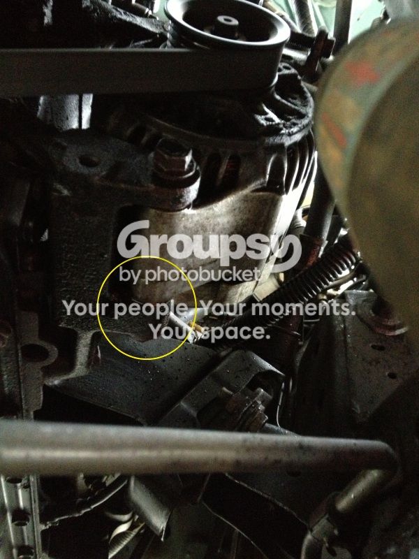

I did notice another wet spot (of course). It's not leaking but doesn't look that it's too far from progressing into a leak:

Did you circle the bracket that connects the alternator to the assembly? If so, theres nothing to leak from that area. Haha. It could just be leaking from the radiator onto that area. Or your engine cooling fan is blowing coolant all over your bay.
