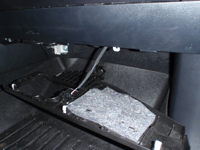

Here You go fellas. This is my attempt at a sp8ball/antman mod thread.....This is a thanks to CV470 as he is the one who figured it out, I take no credit for this.
First photo is the lower panel that houses the amber LED light, it just pulls out.

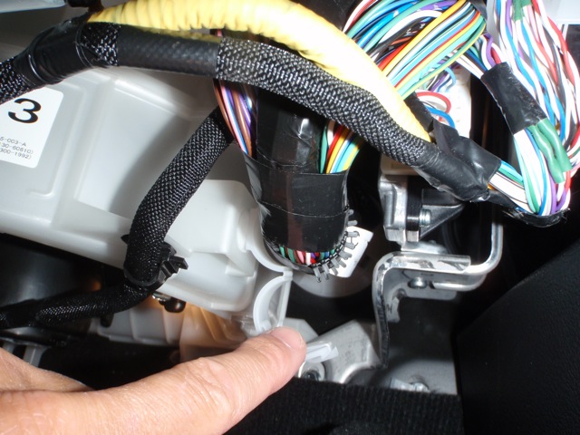

This is a look at the clip and all the wires, you cant miss it. Its right next to the A/C blower housing on the right hand side.

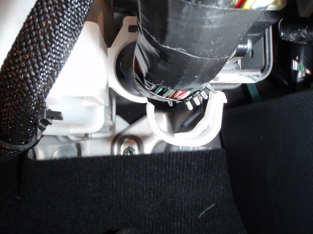

Simply unclip it and you dont even have to take the wires out they can rest in the bottom portion of the clip.

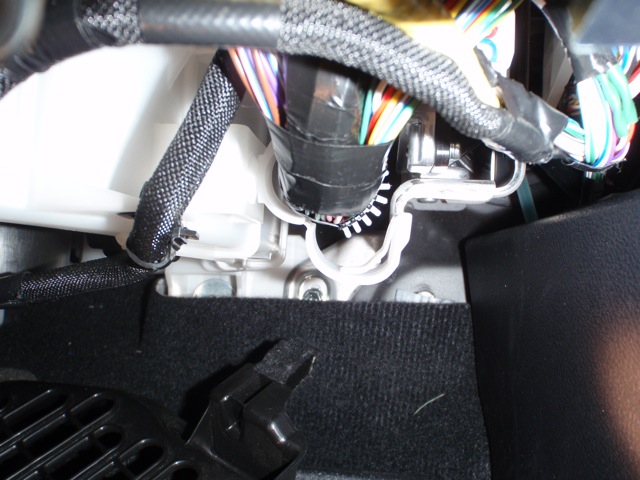

Last one. I just drove 40 minutes over all types of crap, stopped the truck on the side of the road with the a/c blasting to let the rpms get up when the compressor kicks on and its super quiet, not a peep. Sorry I dont know how to put all the photos into one thread reply.
