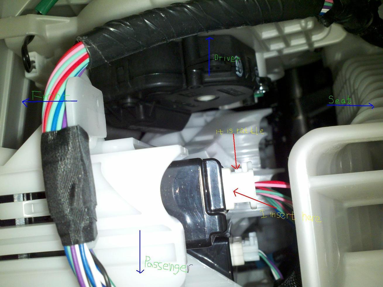

My second type of rattle occurs when my truck hits slight bumpy road, there is plastic vibrating sound. After I search around under the glove box. I think I found the cause. Pictures posted below.
Here is the description: There is a white wire harness plugged into wire housing on the side that close to the driver side. My head needs to go underneath the glove box to see it. But it is the lowest connector so I can still reach it. The male and female connection contact seems loose. If I tap/scratch it using my finger nail, it rattles/vibrates severely. I cut a small piece of from a small wire clamp and inserted it between the bottom contact of the male/female connection. Now the rattle seems completely gone. I also put a piece of cardboard between the housing to avoid shaking.
This picture show where it is:
attachment.php

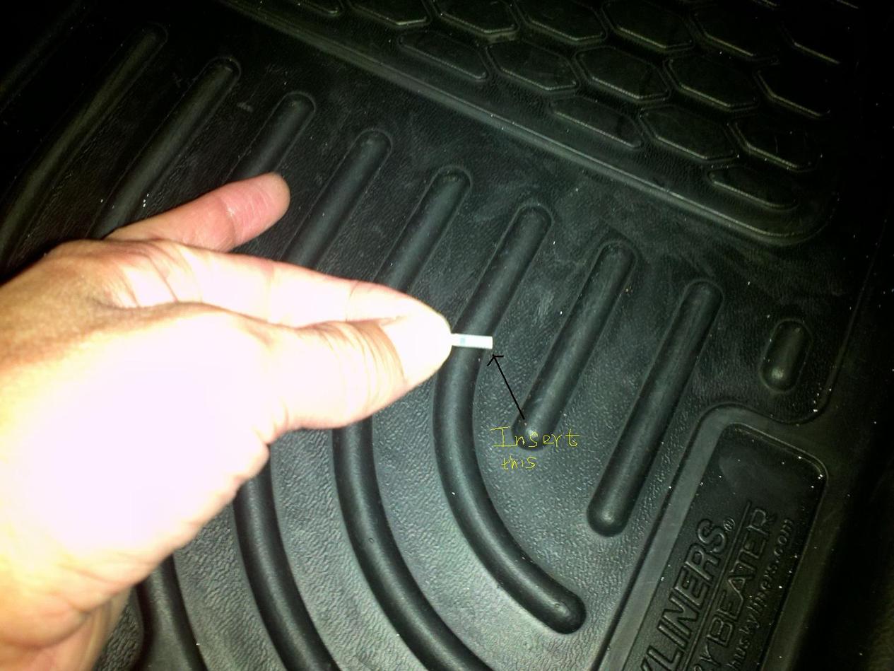

This is the piece that I inserted.
attachment.php

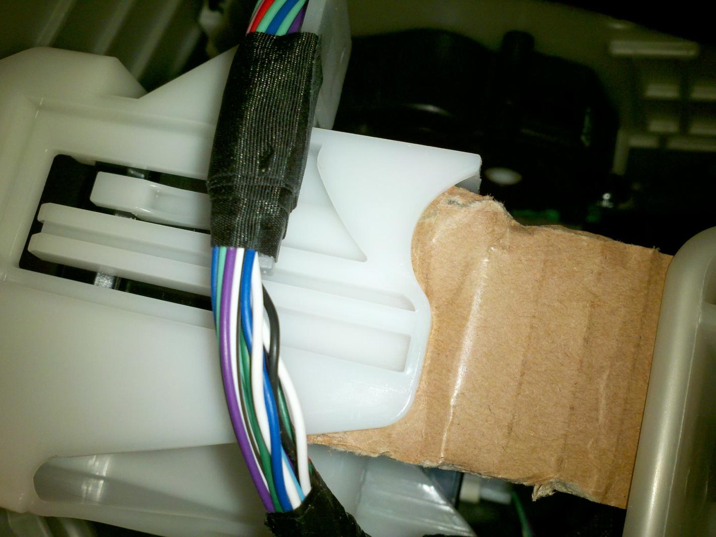

I also inserted some cardboard:
attachment.php

Here are the pictures again for resolving my rattle under the glove box.
Here is location picture:
Here is what I inserted:
I also put some cardboard:
