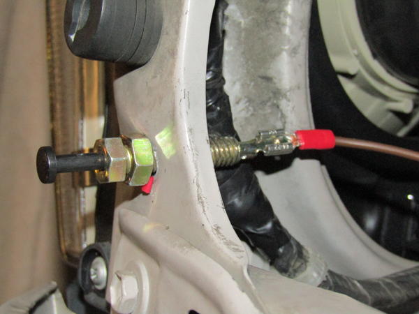

Well done! The conduit is a nice clean touch. Curious if you think you could have raised the pin switch to meet the hood rather than using the wood to "lower" the hood to meet the switch?

so the pin switch mounting plate is the actual GROUND connection to the car, that's how the switch works. I suppose you could raise the switch with a metal spacer but I didn't have one on hand.
That's how I did mine, you just get a threaded pinswitch that you can raise or lower as needed:
certainly a viable and well used option. I thought about this actually, but the only place to put a switch like that is on the core support (need access to the underside of the switch to tighten it into place). And to me putting something toward the front of my engine bay that sticks up and could be snagged by a shirt/rag/hand didn't appeal to me.
My switch is out of the way, just as easily removable, and gets the job done. win-win-WIN!

You are right about the snagging, I've done it more than once. Luckily, or unluckily, it came as a pack of 5 so I've got 4 more spares lol!
