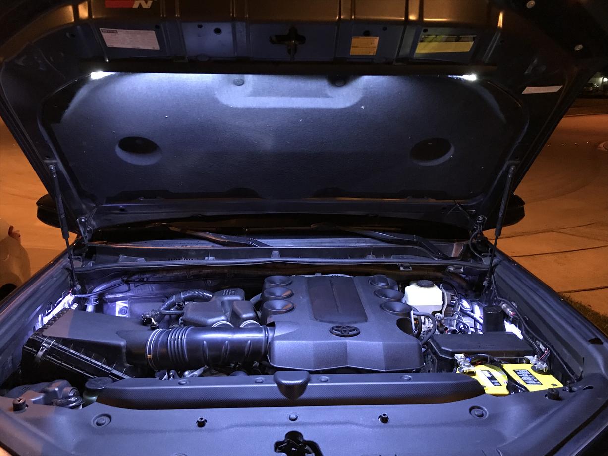

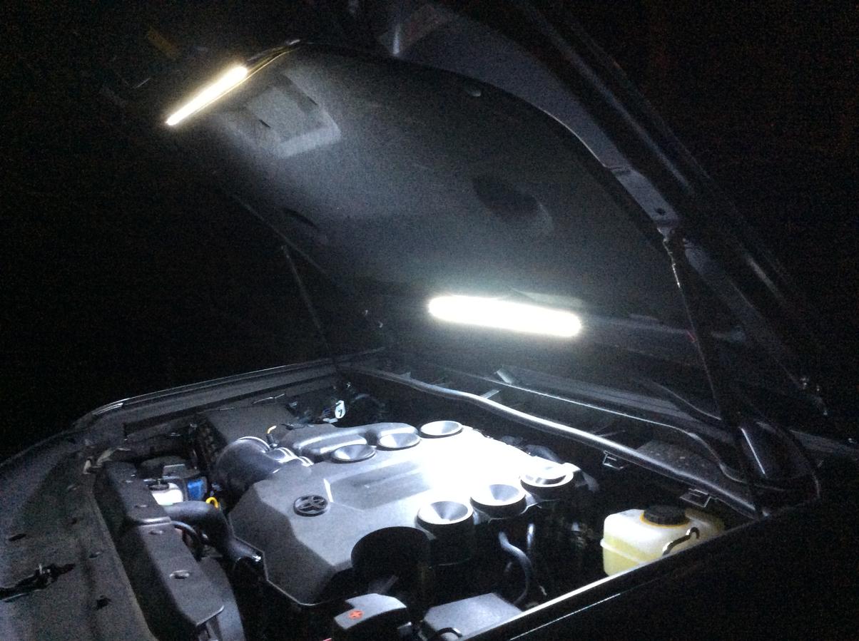

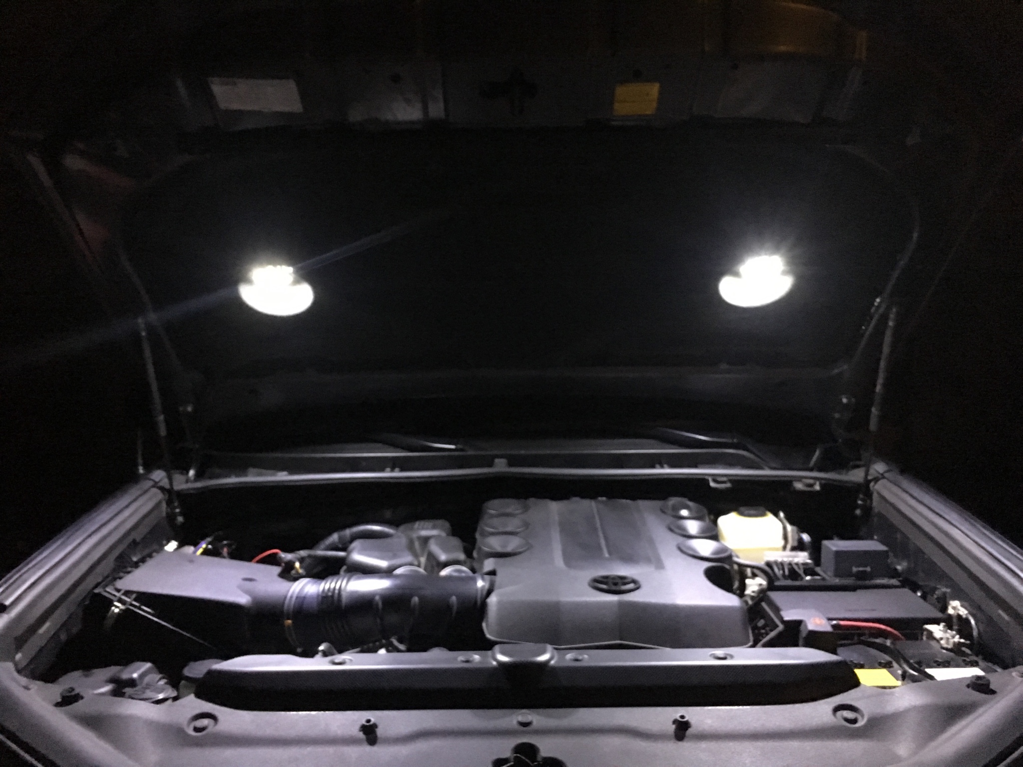

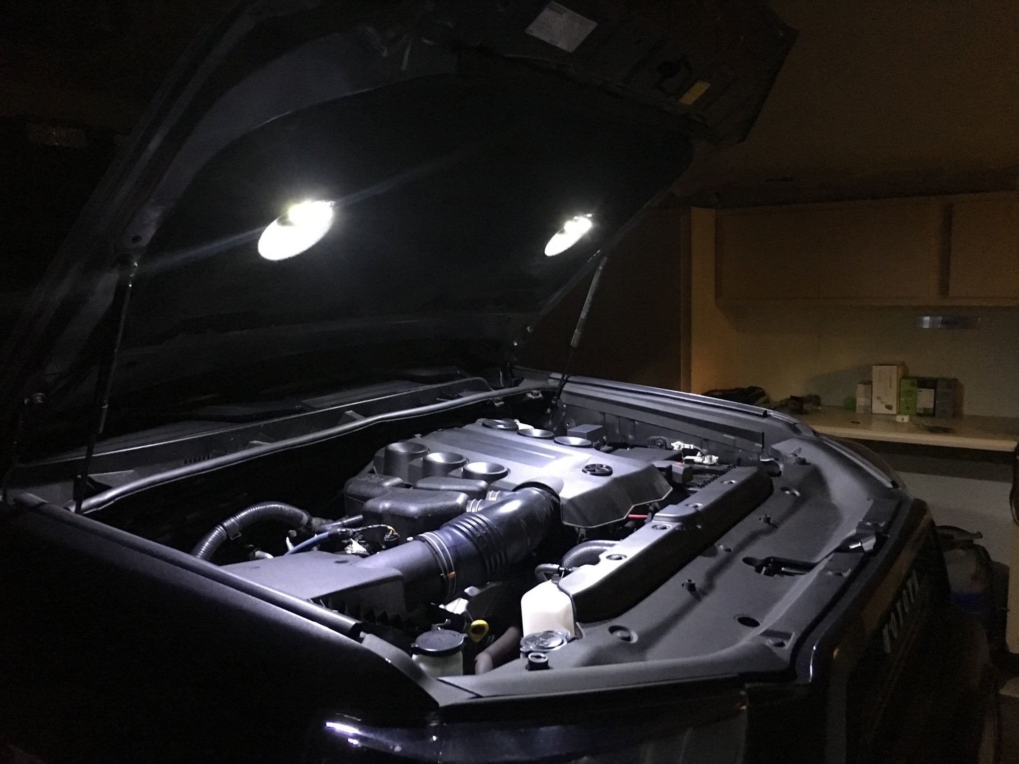

This is my light setup.
Made with some leftover led strips and a hood pin that I had
Did a upper and lower strip on the hood.

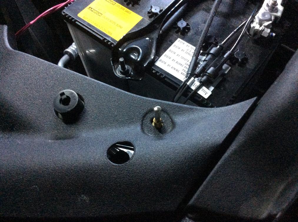

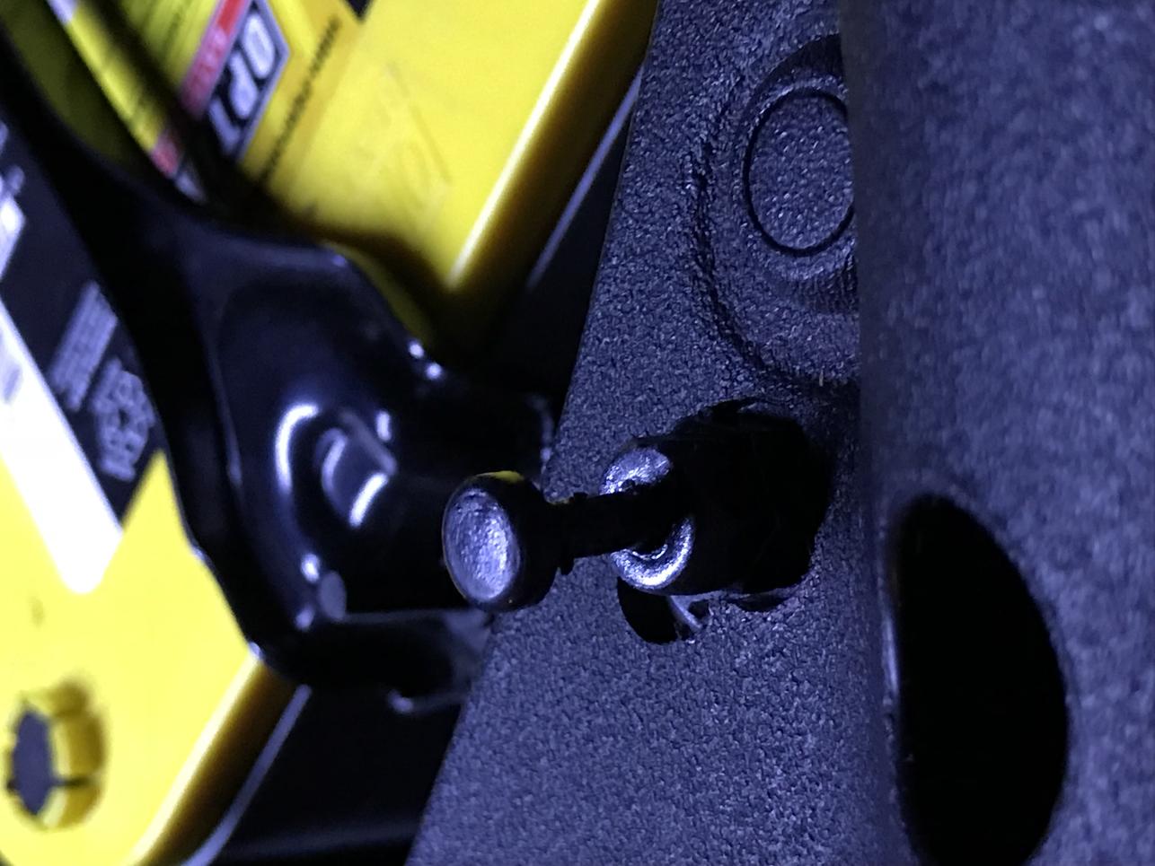

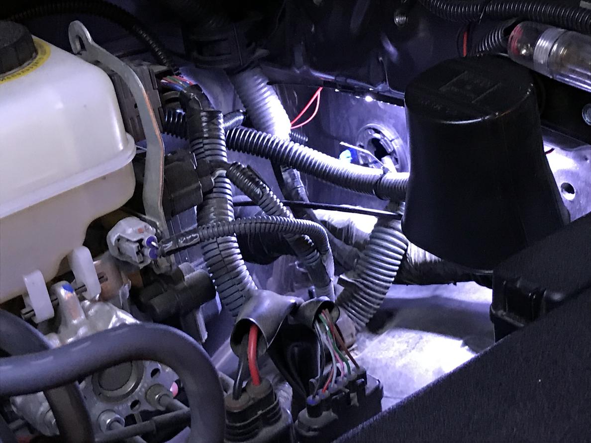

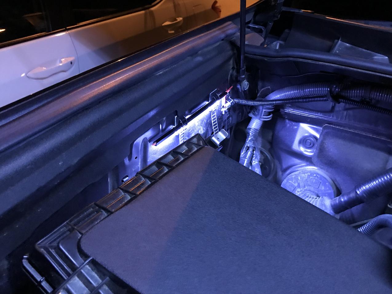

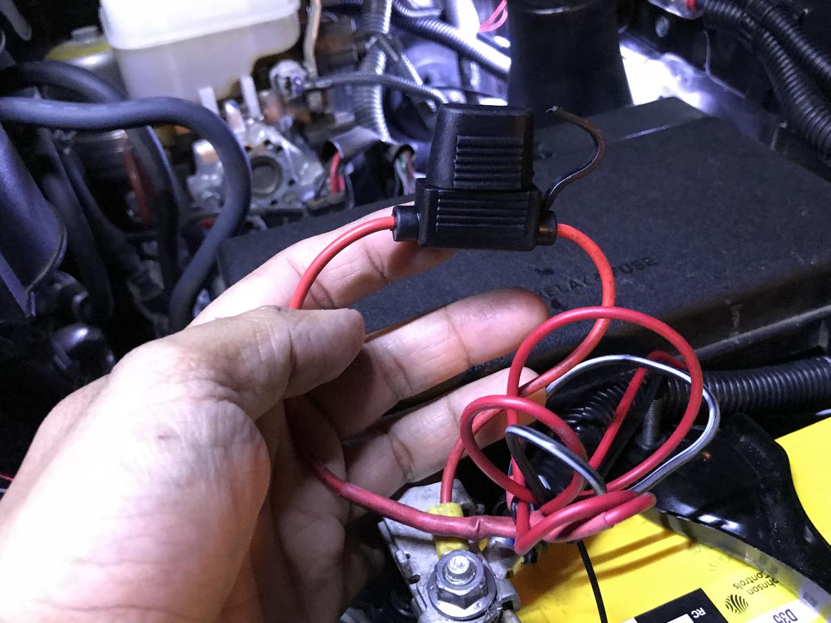

I followed quite a few but also always wanted to add some lights in the engine bay to illuminate harder to see areas. I bought the led strip from a computer place called ALTEX and decided to go with the inline fuse and run it straight to the battery since Im gonna want them to work when the cars on or off. The led in the bay are the water proof oznium strips. These are not flexible at all fyi.
I went with the pin switch, which I gotta say I'm not a huge fan of, but I ordered the mercury switch so I may try that later.
