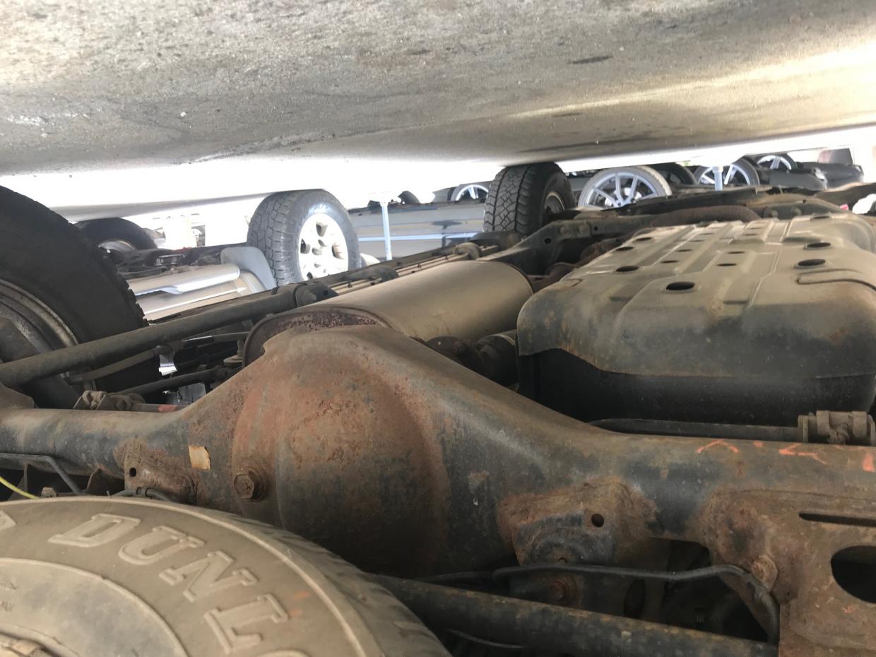

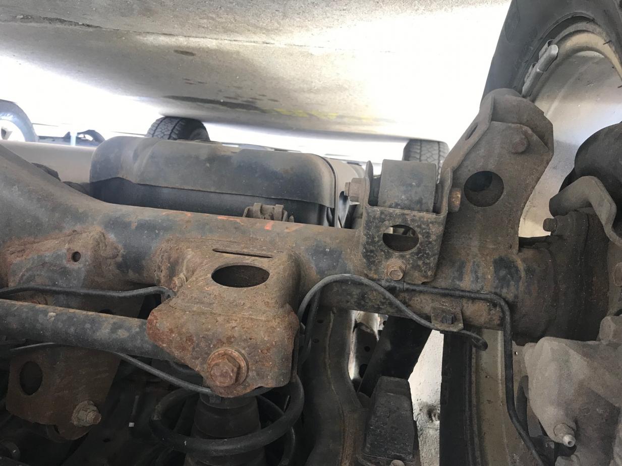

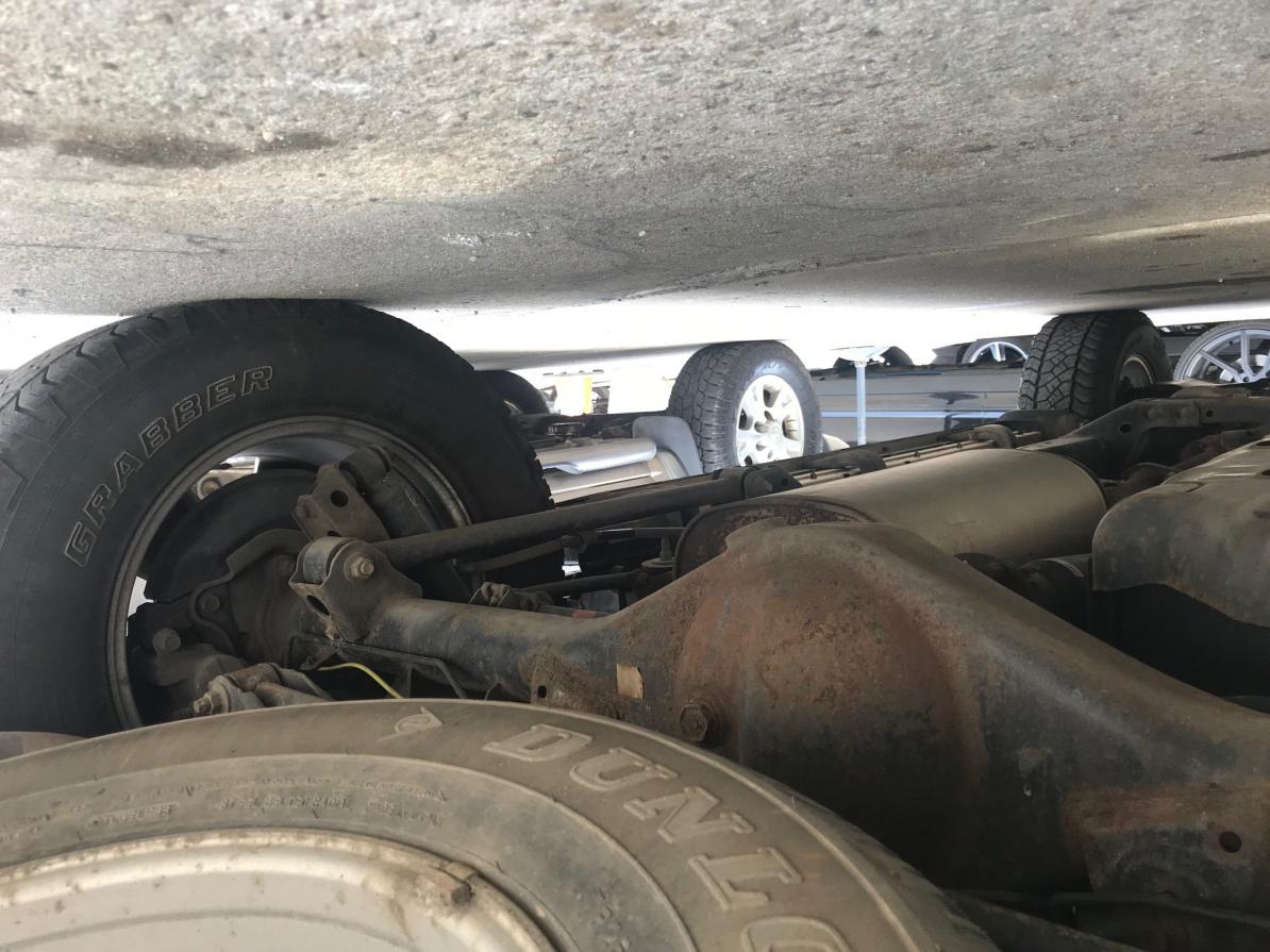

I went ahead and put a deposit down on the vehicle and then immediately regretted it because of the rust. I spoke to two people and they said it looks like surface rust and shouldn't be an issue, but I'd like your opinion.
How bad does this look, and what should I immediately do after purchasing the vehicle (if I do) to make sure I can get many good years out of it? Or did I just make a horrible mistake?

that does not look bad to me but I live in the salt belt. the CA guys will chime in and say it's terrible, it's not. if you want to help prevent further rusting... fluid film is my weapon of choice.
as long as there are no holes... usually things are fine but it's much more difficult to work on a truck like that. sometimes cutting or grinding off nuts and bolts is the only way to get them off.
don't feel bad that looks like a fine truck.
I think that underbody rust is manageable. You can see the rest of the frame and it looks solid.
Just will need a little attention in the way of scaling the surface rust off and applying some kind of rust encapsulator (POR 15, Eastwood). What are they asking?

That rust looks fine. For now just apply rust inhibitor and later on work on repairing some of the rusty spots like the diff pumpkin.
