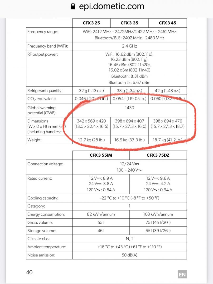

Concerning fitment:
If you want to cover your fridge then retract the cover to open the lid you’re limited to the height (about 18-19 inches). And the length of cargo hatch door to the cargo cover’s spool (about 27 inches).
It looks like the three smallest Dometics will fit properly. You might be able to go with a longer model if you incorporate a slide, and take into account its height off the floor. There’s enough slack in the cover where it will “stretch” a little over a ~20 inch height.
https://epi.dometic.com/externalassets/dometic-cfx3-35_9600024617_77453.pdf
Taking a look at Dometic, based on width dimensions, the biggest one you could fit next to two 68 qt plano trunks would have to be 15" wide or less and that's the CFX3 25. Each plano is 14.25" wide and the cargo area is 43.5" between the wheel wells. The 35, 45, or 75 should fit height wise under the cover. I have the CFX3 75DZ and it's the same height as the 45. Length wise it also fits in the cargo area with the second row seats up so that's a plus.
