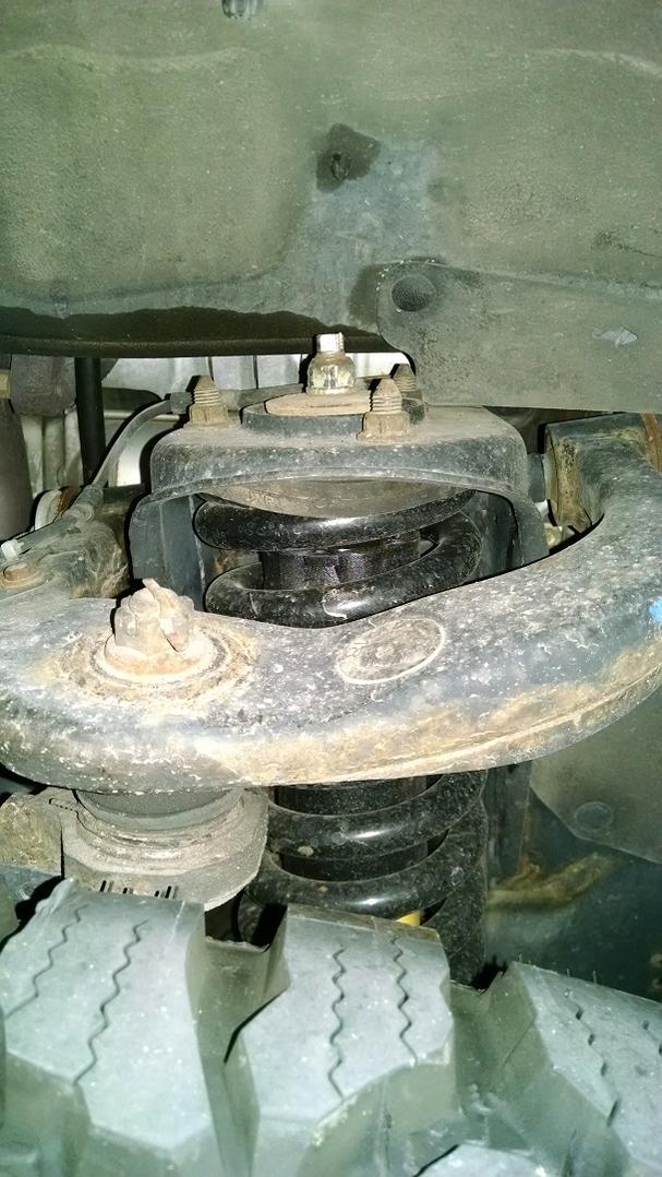

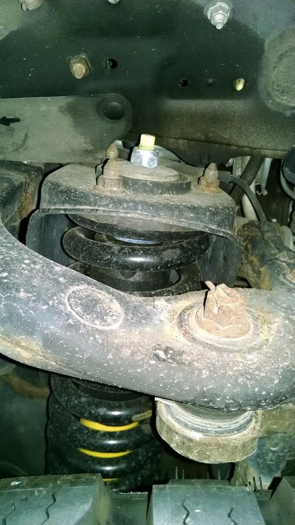

I had a shop install the following lift on my rig a couple months ago:
OME 881 Front w/ Nitrocharger Sport 90004
OME 890 Rear w/ Nitrocharger Sport 60028
Occasionally I have noticed that the driver side sits slightly lower than the passenger side. I measured today, and both the front and rear are sitting 1/4" lower than the passenger side.
I also noticed that the top of the passenger strut doesn't looke quite the same as the driver side.
Passenger Side:
Driver Side:
I am relatively new to the lift game, and really I just have two questions...
1. Does it look like the passenger strut was not installed properly?
2. Is a 1/4" difference in height per side pretty standard, or is something wrong here?
Thanks everyone!

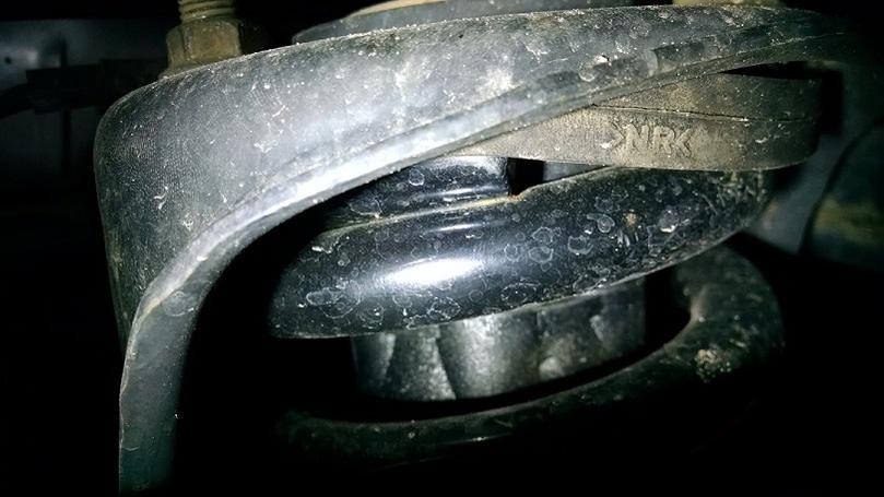

The top pic, the spring may not be seated all the way. Hard to tell from the pic though.
If it isn't seated correctly is there an easy way to find out short of disassembly?

The rubber insert don't look seated. That could be part of the issue.
I might have the shop that installed it take another look. Thanks!
