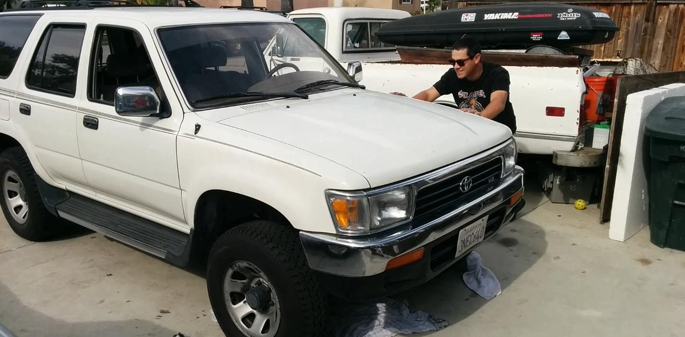

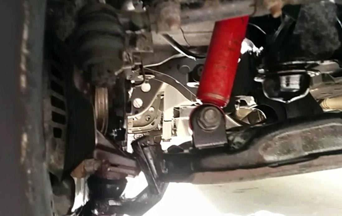

I have a 95 2wd 4Runner its been making thin creak lately while moving from side to side, there is no creak while it bounces up and down. I've replaced thee ball joints and have greased them, I've sprayed everywhere I can think with spray grease and still can't seem to get rid of the sound. The sound seems to be coming from just the front passenger wheel itself.
Any previous experience or advice with a sound like this would be much appreciated. Thanks

Lift that wheel off the ground and pull on the top of the tire and push and pull violently and see if you get the noise. If you do you need to replace your wheel bearing
