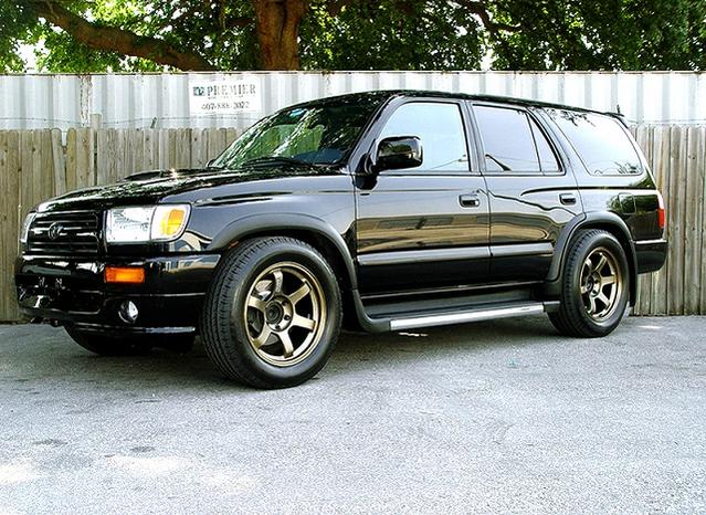

Dont get that excited, it's 22" spinners.
Wrong. If I'm gonna do something, I'm gonna do it right. 31" light up spinners or bust
Ch-Ch-Ch-Ch-Chaaaaanges! Turn and face the strange.:guitar2:
How did you get a picture of my truck so fast?
