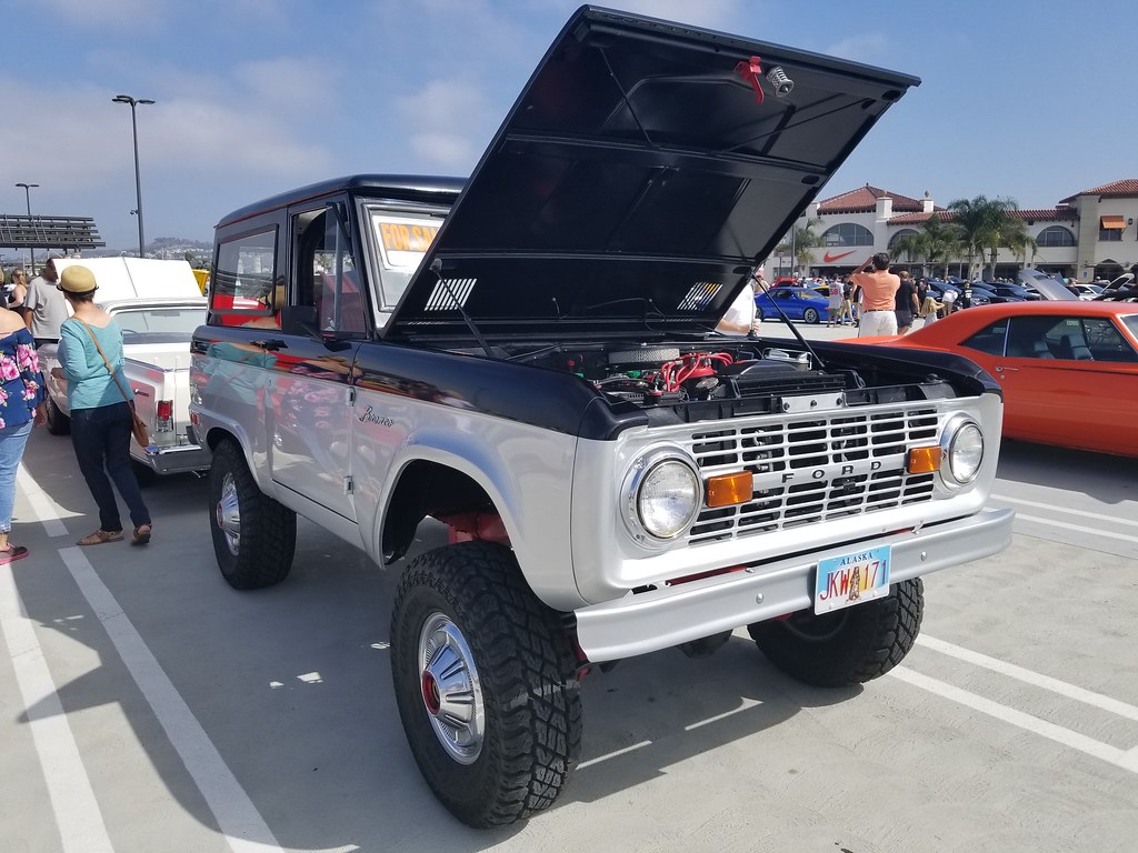

Saw this 3rd gen at cars and coffee in San Clemente. Anyone recognize it? Had Colorado tags.

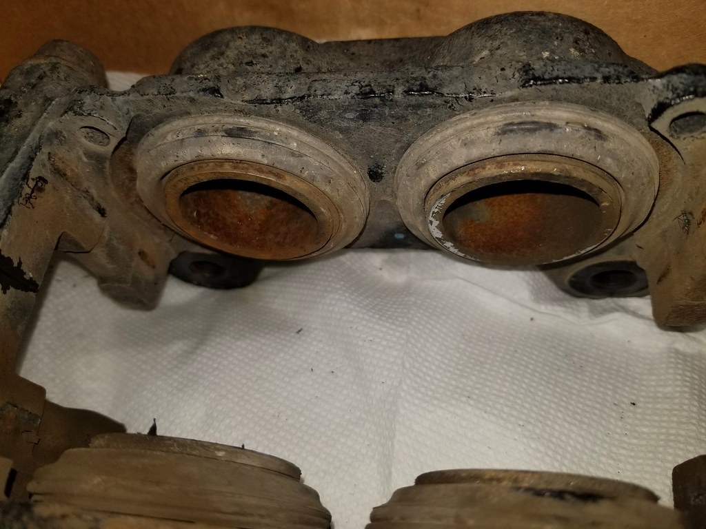

I recently changed the oil, and figured out the brake pulling issue I was having. Driving through the hills around Birmingham the brake pull got really bad, pulling towards the drivers side. I got out and checked the temperature of the wheels and the driver front was way hotter than the other 3 wheels. Coming back home later that weekend I was on the highway for about 70 miles without touching the brakes, so I pulled over to check and see if any of the wheels were hot. If the driver's side was hot then I would figure I had a bad wheel bearing, or a faulty new caliper. None of the wheels were hot, so I knew it must be the passenger side not doing it's fair share of the braking.
A couple days later I pulled the wheel and sure enough, the inner pad on the passenger side has a lot more material left, and the pistons wouldn't push it tight against the rotor with slight pressure on the pedal like they should. I got a replacement caliper from Napa and swapped them out. Make sure you check your part numbers, I told them I needed a passenger side caliper, but they gave me the driver side so I had to leave the truck torn apart over night and get the right caliper in the morning...
This was what I found on the inside pistons of the passenger side. A lot of corrosion for a southern truck that has never seen salt. The calipers were only 3.5 years old also. They had almost 100k miles, but that shouldn't really increase corrosion.
2018-09-05_10-45-56 by Unner Unner, on Flickr
The inner side of the driver caliper is also what was seized on that side, so that seems to be a common factor with the Tundra calipers. Hopefully this second set of calipers lasts another 100k miles, and if they seize I'll use that Napa lifetime warranty again.

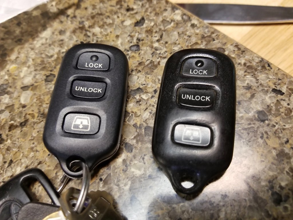

I also ordered a replacement key fob case from Amazon since mine was cracking around the key ring hole. For $7 I'm really impressed with it. Feels just like OEM, and everything fit perfectly. Nice little upgrade.
https://www.amazon.com/gp/product/B00KTHXYO8/ref=oh_aui_detailpage_o06_s00?ie=UTF8&psc=1
