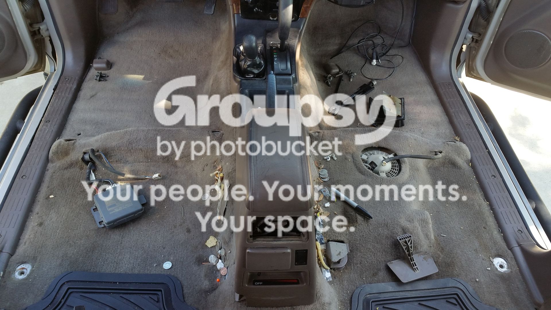

While we drove home to WA from CA we talked about the things we would do with it, well I talked, she read. Lifts, Mods, RTT, tires...for like 20 hours, nothing, just reading. Then out of nowhere, in the midst of a 14hr marathon to central OR she spits out, "This thing stanks!" She was not wrong, good lord it stunk. It had to be in the carpet, I was on my first mission.
**NOTE TO SELF - SHE THINKS YOUR NEW RIDE SMELLS**
The good news was I found like 9 dollars in change, along with Ruffles, a few Cheetos, french fries (from Micky D's I'm sure), Goldfish crackers, 2 types of pretzels and 3 empty packs of Swisher Sweets Singles....:repuke:
It does have 188k miles on it. The guy I bought it from had a couple young kids and I git it, but smoking Swishers with your kids around. HAVE SOME CLASS AND SMOKE BACKWOODS!!
Cleaned what I could with carpet Pet Stain cleaner and a healthy application of that sprinkle on powder shit for the carpet. Didn't change the smell much, but it LOOKS BETTER NOW! New carpet and pad are on the list...

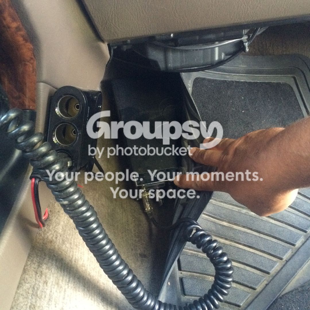

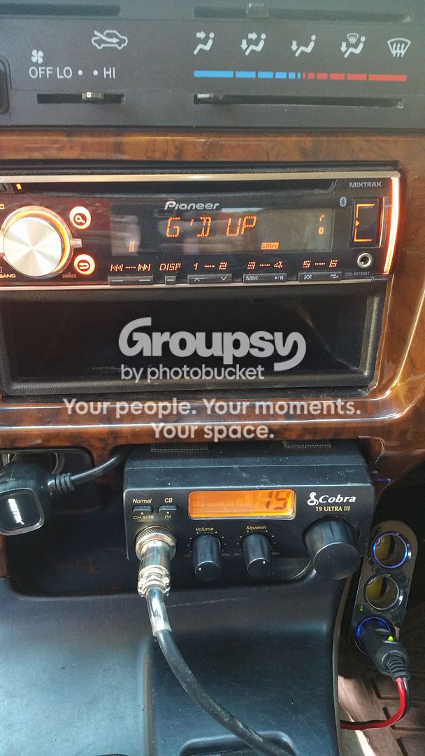

Decided to "remount" the CB (yes it was stashed under the passenger floor mat). The Cobra Classic 29LTD radio is nice, but big, and I couldn't really find a spot to actually mount it (prob why it was under the mat). I had an extra from our old J**p that was much smaller, a Corba 19 Ultra. Messed around a bit and came up with this...
Fit perfectly.
Pulled the ash tray out, push the radio in, and cut the sides of the dash trim where it hit until it was pushed against the heater fan motor? it was against something, that's where I stopped. Used a couple pieces of Velcro to hold it in place, there wasn't enough "meat" to screw the mount to.

It may be hitting on the stock radio amp. If you pull the center dash trim off it is two screws to remove. And since you have an aftermarket radio it is probably already bypassed. If it isn't already, bypass it. It's useless.
That may allow you to mount the CB a little deeper.
Good looking out. Will check it out this weekend. Thx

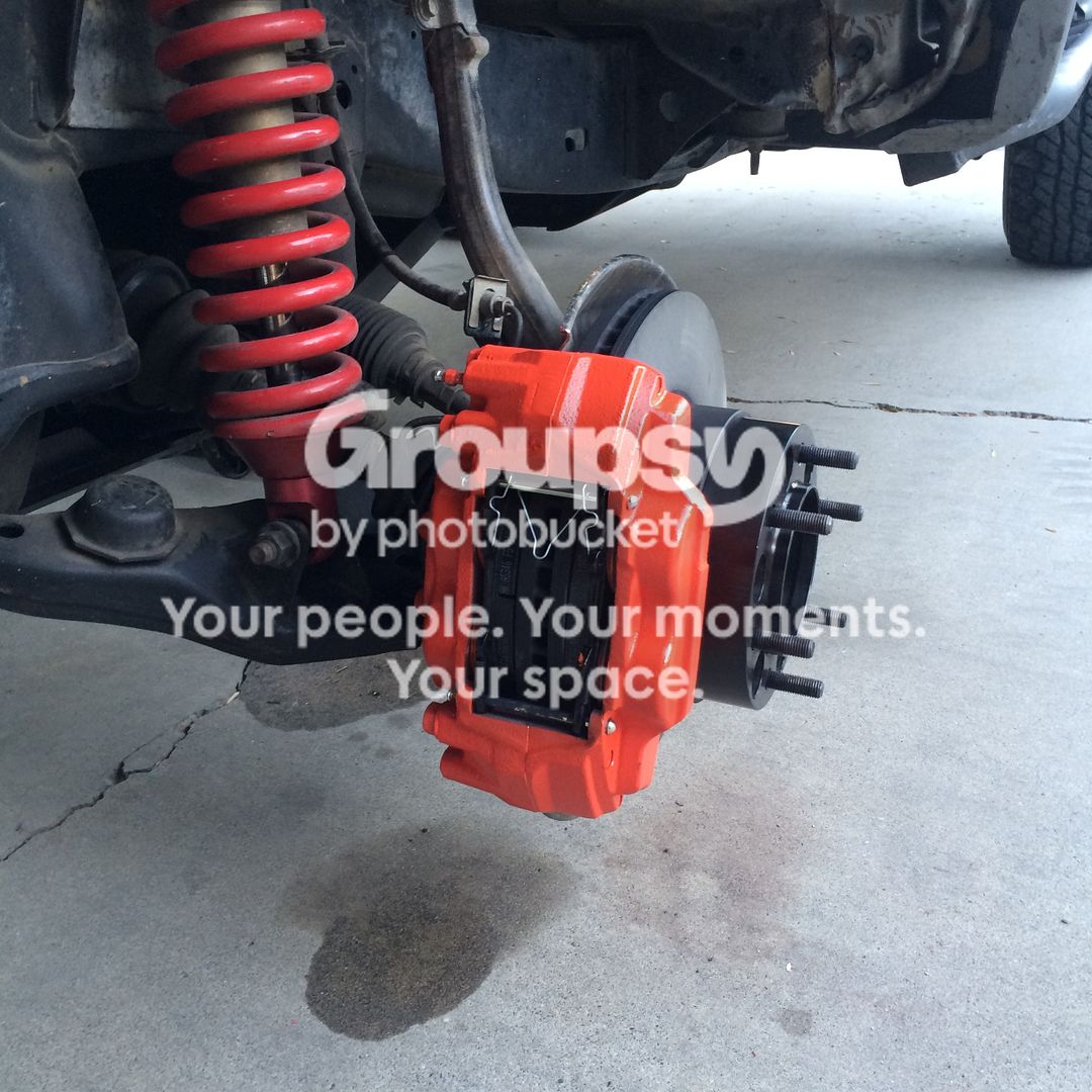

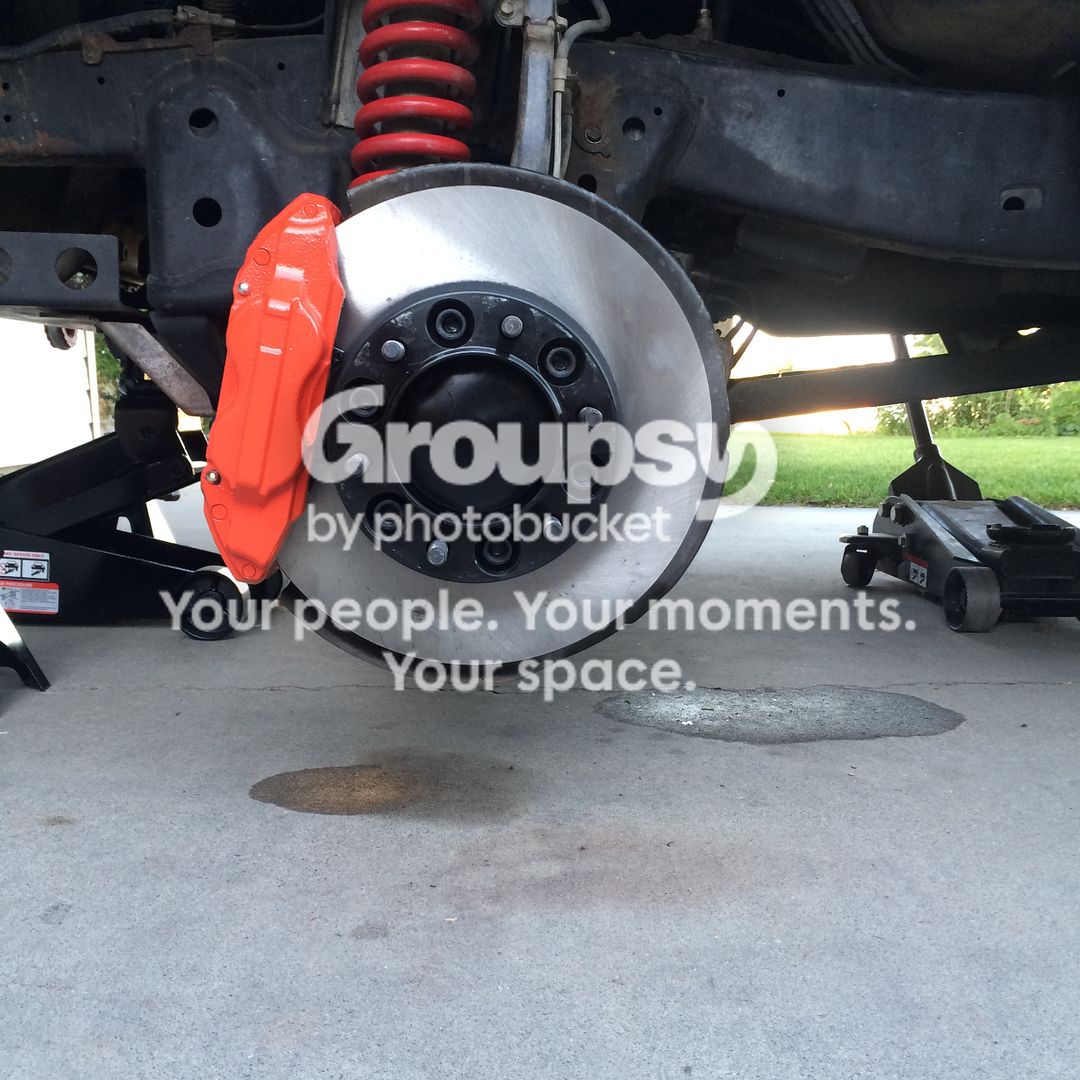

So, I'm not a mechanic, far from it. Diving into a project that I am unfamiliar with, or have little knowledge of, makes me very anxious. I do my best to research and learn things well before stating them (and sometime I'm never comfortable enough to start them). This project was no different.
First off I gotta give a big Thank you to [MENTION=44220]BigFishAllDay[/MENTION] . Without his write up on the TBU and those of you that contributed in the thread, I'm not entirely sure I would have started it (even with all the gear ordered and sitting in the garage). So thank all of you.

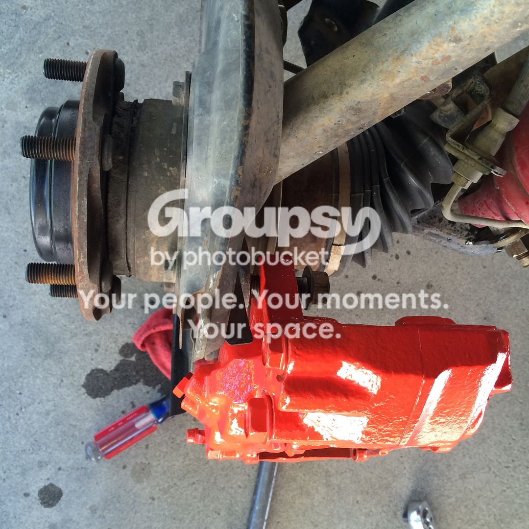

I went with Toyota pad and 231mm rotors for a 2005 Tundra. Bought my calipers from a local auto part store (I think the brand was Centric) and followed that thread verbatim. The only places a ran into anything that was different is with the shims. My pads only came with one set, but I carried on.
The one thing I did do differently (not a great pic) is when trying to determine where to cut the dust shield. I put the bolts into the caliper and mounted it behind the dust shield. Then I just eyeballed where to cut the shield, from the outside. Worked like a charm.
Almost didn't paint the calipers, but I'm glad I did now. Went with Hugger Orange to tie in the orange on the decal.
Turned out pretty decent IMO.
All buttoned up and ready to roll.
All in all this was a very easy and usable upgrade. For those of you that are hesitant about the difficulty, don't be. And man does this thing stop now!

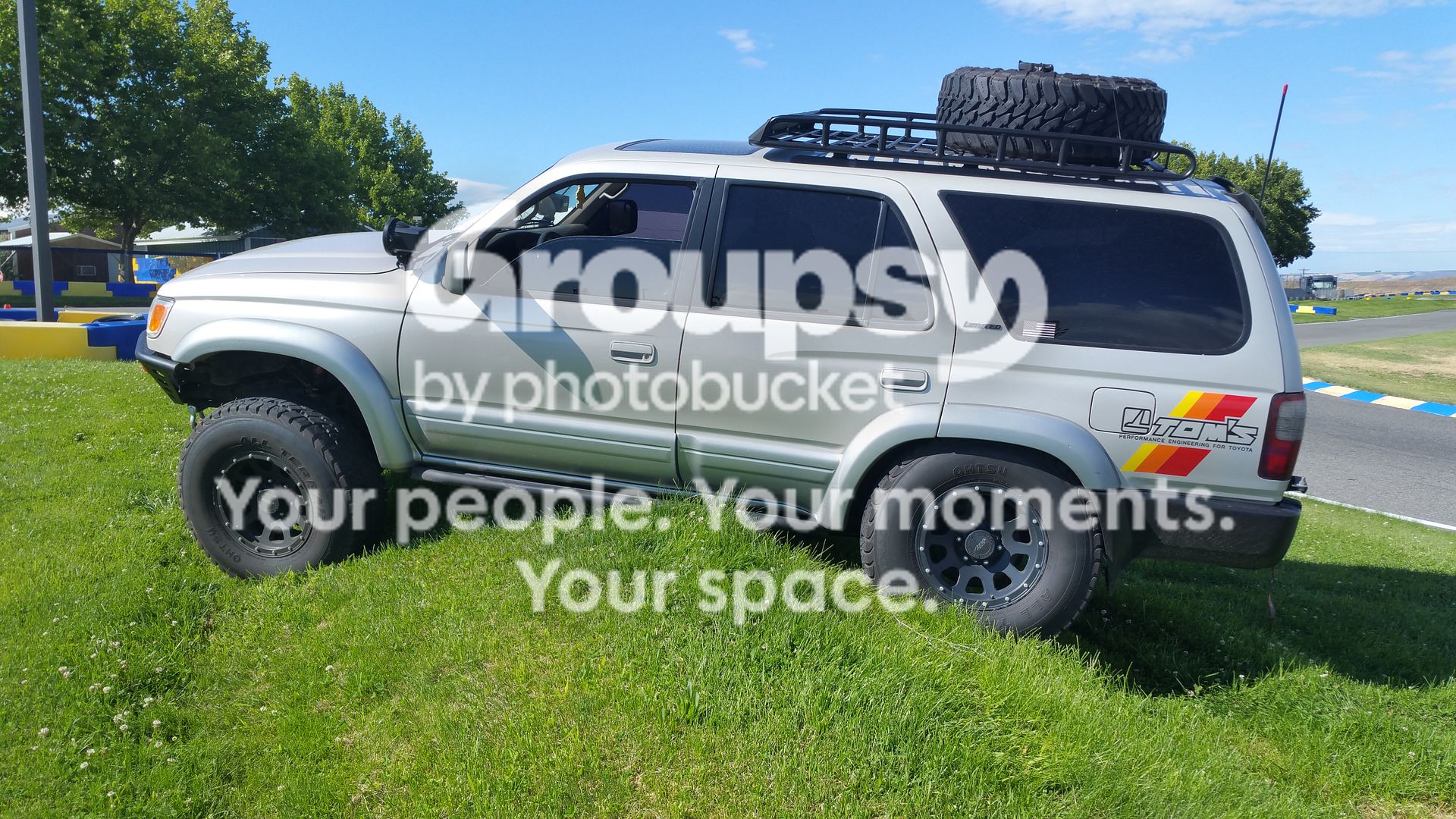

I wanted to see what kinda flex I have, so I snapped a few pics
Enjoy.
I pretty darn sure I could have got a lot more out of it. Suspension felt very pliable. Huge change from my Bronco which felt very top heavy. As close as I been to actual off road, that will change tho.
Still working on a few things, "custom" rack for the RTT and a few other odds and ends.
