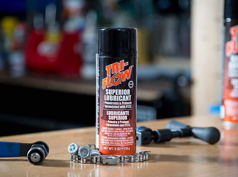

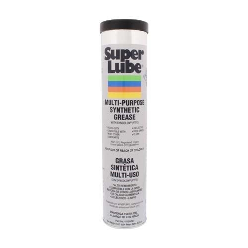

I think more of the squeaking issues are the urethane bushings. The UNIs are quiet when maintained. I use Triflow. Mine got pretty dirty the first several months I owned them, and I didn't take care of them. So one day they started to get hard to turn and were making a groaning noise. Read up about them and have been using Triflow for years with out any problems. Urethane will squeak and there is little you can do about it except grease them often, or get heims and they make their own noise in the form of clicking. Triflow for UNIs and Super Lube for Bushings.
