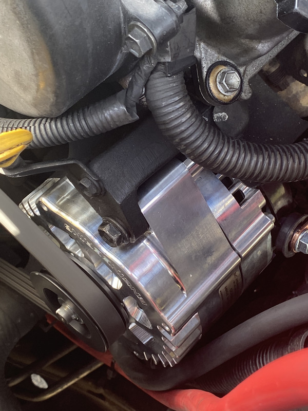

I recently installed a DC Power 270 Amp alternator, an Odyssey battery, and the Big 6 upgrade kit. I’m very happy with the results.
Installed DC Power 270 Amp Alternator, Odyssey 34R AGM Battery, and JeepCables Big 6
