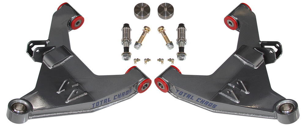

The lower uniball arms are available from Total Chaos as well.
TOTAL CHAOS FABRICATION
Not the cheapest but the best. Also allows for 2nd shock for the hardcore wheeler.
If you need for spring rate for your winch setup, try OME combined with the 5100 Bilstein. (Might have to bring down 1 clip in order to align)
