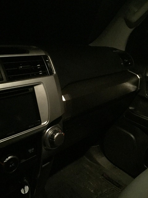

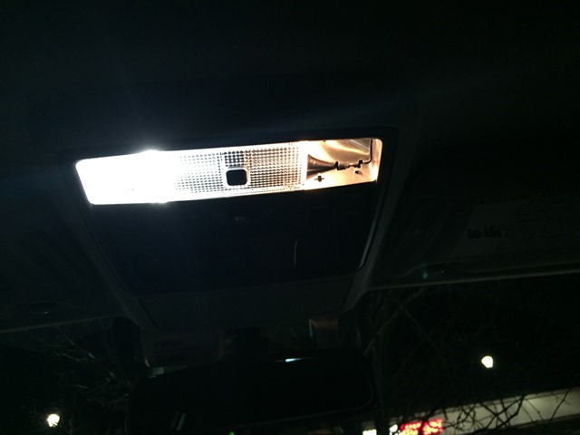

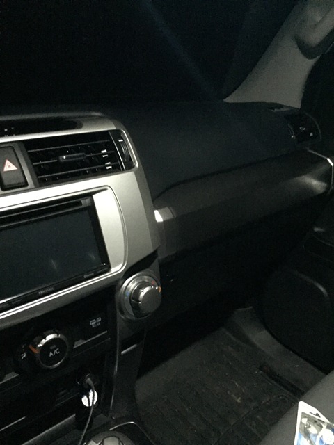

Not sure if the upload of the pictures worked. But I put in the Philips 194s last night and the difference is huge. I attached a before picture, an after picture, as well as one with the old and new side by side.
I also bought the reverse light bulbs, but it's too darn cold out to put them in just yet.
I read thru the thread and didn't find it. What bulbs go in the 4 doors and tailgate? What about the dome lights in the 2nd row and the trunk?
thanks
