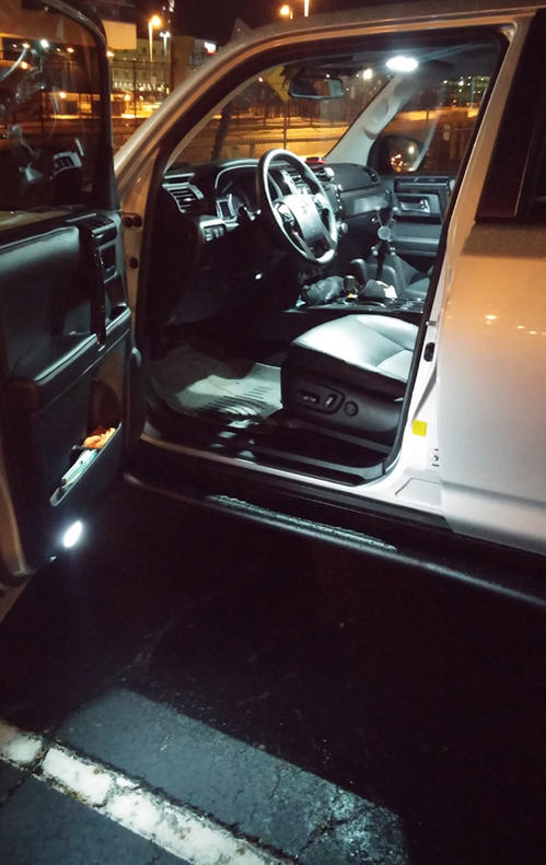

In place of that I'd suggest this JDM ASTAR DE3175. It is a little over-sized because it's a 31mm instead of 30mm, but a small bend of the flexible retainer and it fits and holds fine. For ease of install, bend the retaining clip before you try and shove the bulb in there. Because both the dome and liftgate lights lack a reflector behind the bulb, this should work better with all 6 LED's on the same side.
After having issued with the dome light I also ordered a couple of JDM ASTAR 194's to test. They are much brighter than the Philips 194's. While they are an exposed circuit board, the bulbs are housed very well anyway. Hence I returned all of the Philips LEDs and used the JDM ASTARs to do the whole truck. I forgot about the puddle lights and have to go back and do them now, but here's how it looked getting into the truck last night.
