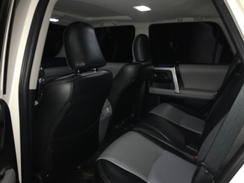

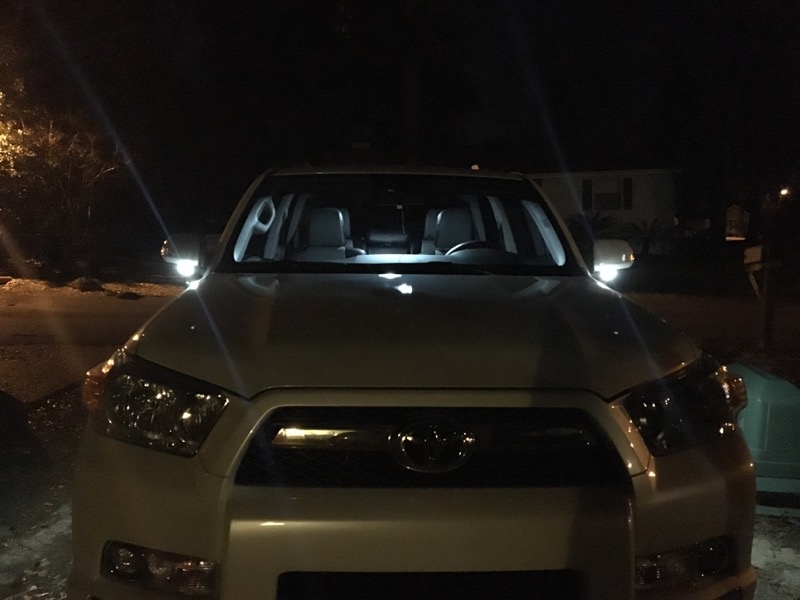

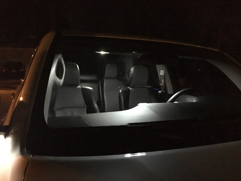

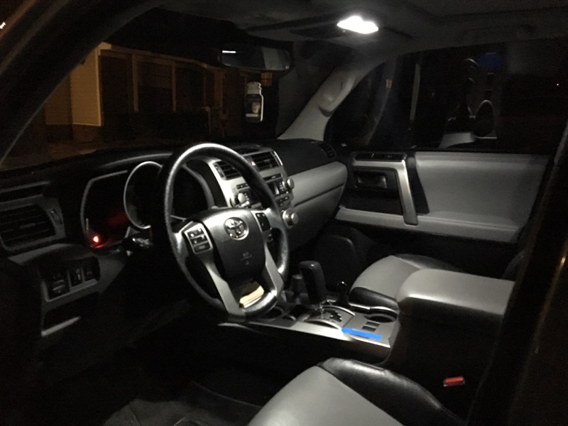

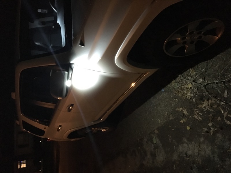

Do you have pics of yours set up?
[MENTION=132887]popey[/MENTION] The photos don't do them justice, but here you are. The photo of the rear dome light accidentally had the flash come on.
