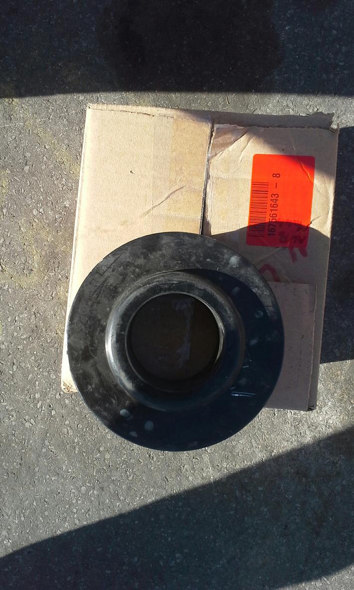

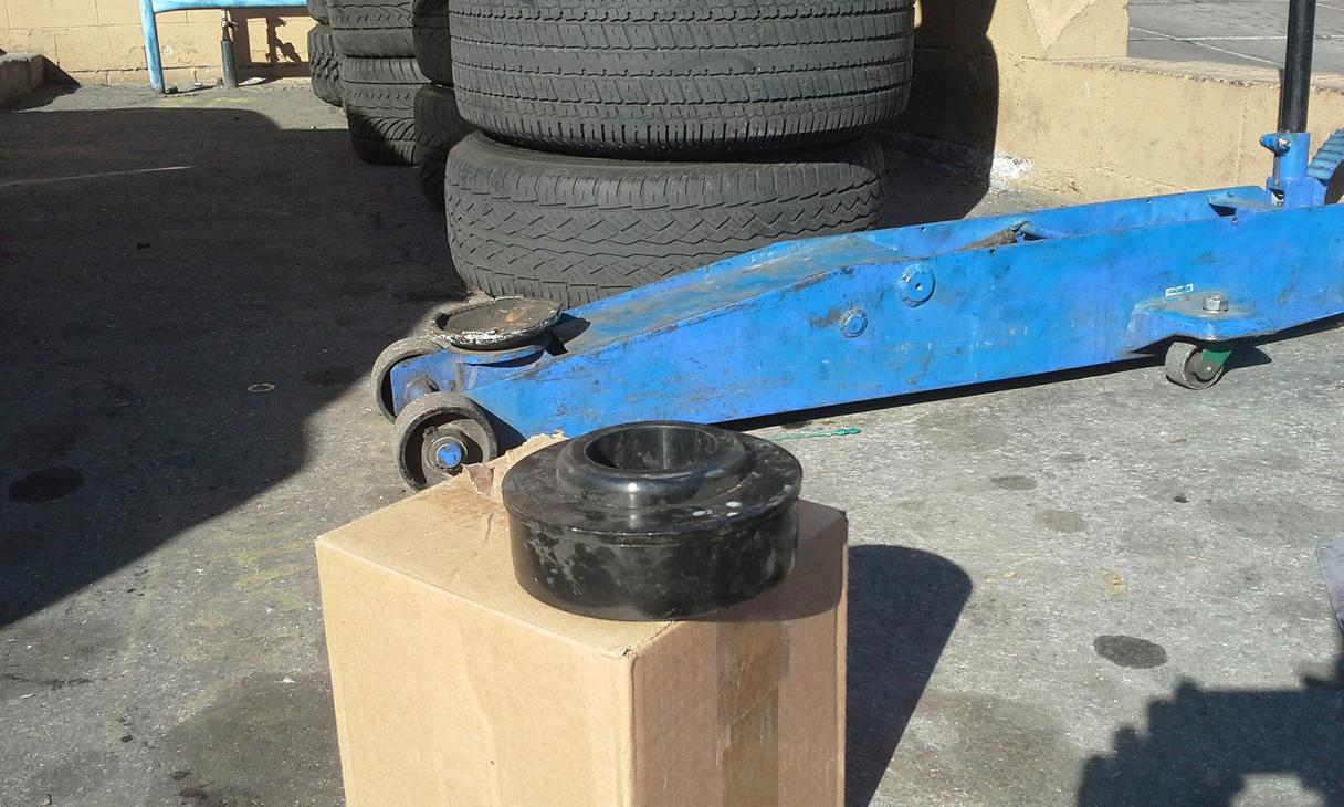

So these are what I was told were daystar spacers , anyone seen em before ? I've never seen them before & spent an hr looking at all the ones on amazon ! They came with the 4r when I bought it !
They look just like the ones I put on the rear of my 4th gen 4runner. I would need to see the other side though to see if it could be a front spacer.
After looking at the daystar site I do not think they are the rear or front top out spacers. They may be a preload spacer that goes on top of the spring on the strut assembly.
The daystar kit I had on my 03 4runner used a top out spacer and preload spacer. It looks like it could be the preload spacer.
No numbers these were in the rear . [MENTION=336]03_4x4Runner[/MENTION] yes they do look a liitle like that but nothing like any daystars I've seen . There is no cut-out for the spring to sit in , they just sat on top of the spring isolater ?
Yes, see if they are the same dia. as the spring. They may be from an old 4th gen kit. Daystar discontinued the old preload/top out kits and just use top out kits now as far as I know.
Must be for 4th . I took em out put in some ranchos I had that were 1 1/4 perfectly level now ! Those that showed had the rear jacked up bout 1 1/2 inch higher looked weird .
