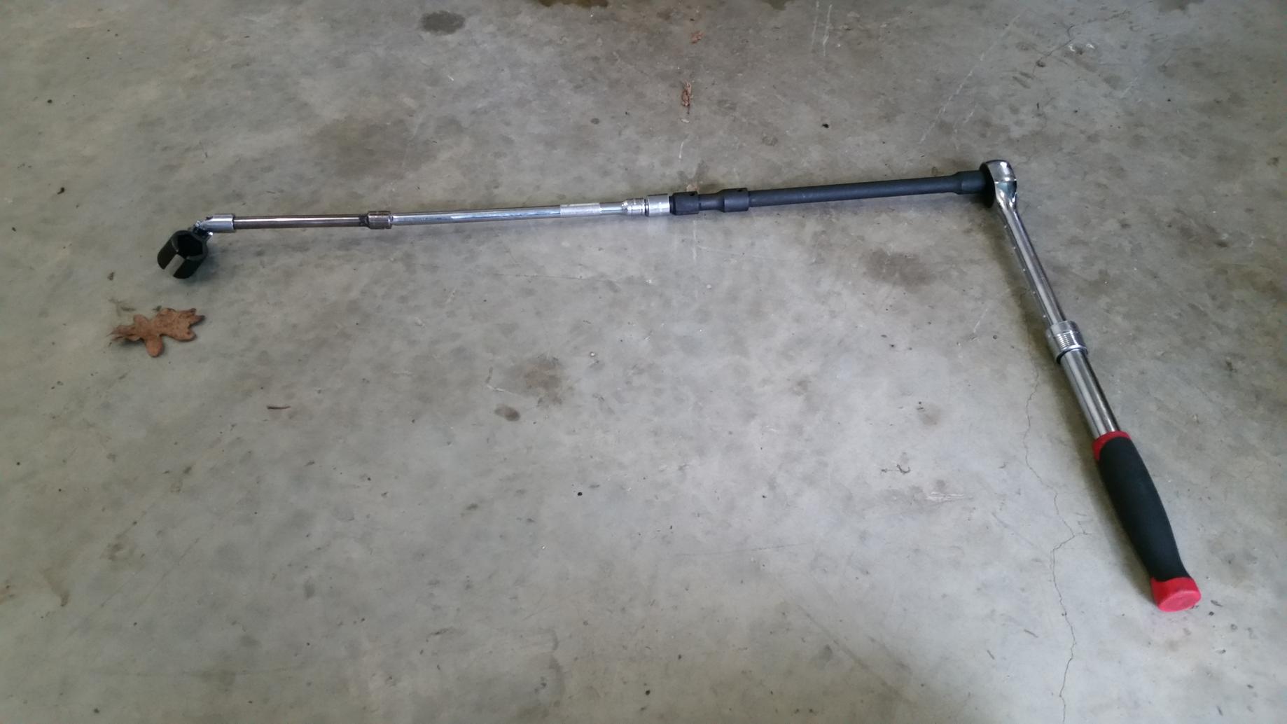

Finally got the drivers side off and replaced. Started out an adventure, ended up a quest. ( I'm Really stubborn). Now P 0031 code is showing up.
A/F sensor
Here is what I used.

I used a crow's foot wrench (similar to the picture shown, just not as deep) on my V8, coming through the wheel well. It actually worked pretty smoothly. The hardest part was getting enough hands and tools in there to release the electrical connector.
