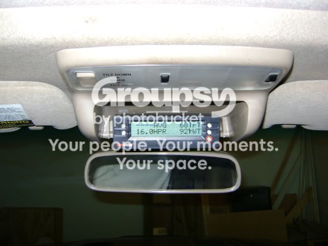

I used the little overhead cubby for my ScanGauge II. I never used it for sunglasses, and I wanted a heads-up display for the gauge. I made some little 'L' brackets and ran the wire under the headliner and down the pillar to the OBD port.
DSC00448.jpg~original

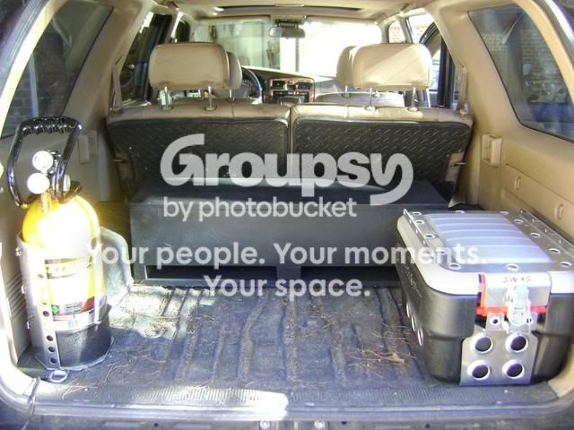

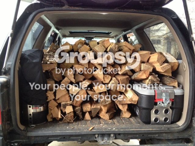

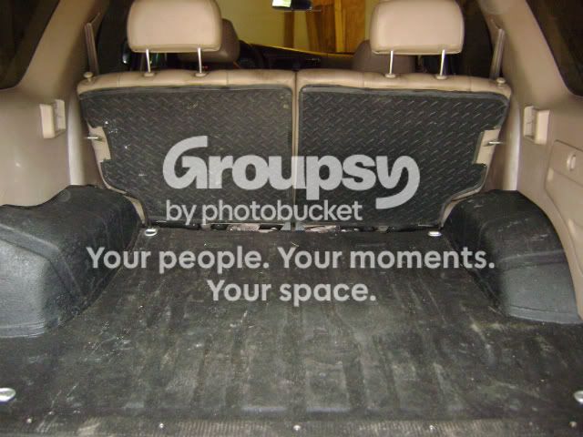

I sprayed the cargo area with bedliner. I removed the cardboard/carpet seat backs and replaced with treadplate. It is not uncommon for me to have a load of firewood, stone, or dirty bikes in the back. Carpet had to go.

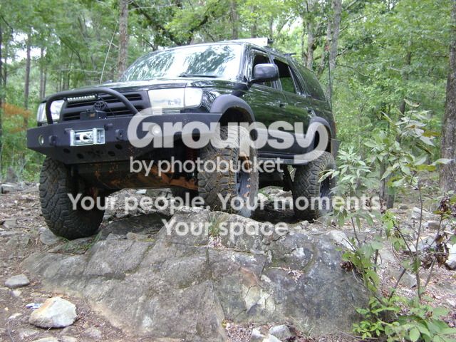

My take on the 2x2 square slider. Thanks Dirtco. I double angled the front end of the slider. 30 degrees down and 30 degrees in. Front of passenger slider in pic. Welded scab plates to frame, then sliders to plate. I used 4 legs which was overkill. If I had it to do over again, I would use 3. I over-engineer everything.

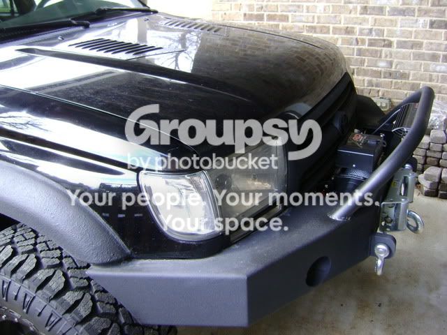

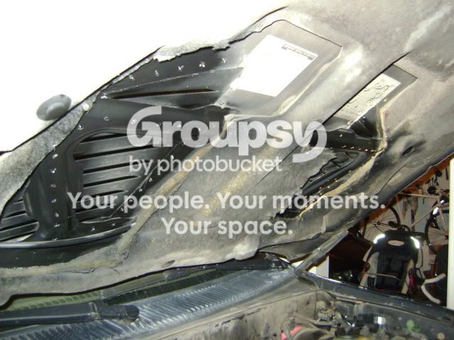

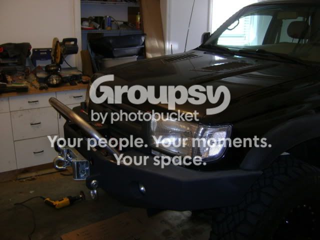

I placed some louvers in the hood. Yes, they are functional. One of the first 'real mods' that I did. I didn't want a fake or functional hood scoop for my V6. Though, every engine can benefit from running cooler. I love them, though there was a moment of trepidation as I stood over my hood with a whirling cut-off wheel. Also, in this pic you can see the Hella DRL's which I fab'd into the little trim piece below the headlight. My parking or clear corner marker light now houses my amber LED turn signal. Again, a little spin on another Dirtco idea. His builds haunt me and keep me up at night. The bed-liner fender flares are also visible. Used "Bed Armor by Duplicolor" sprayed with an undercoating gun from Harbor Freight at 90psi.
DSC00458.jpg~original
DSC00478.jpg~original

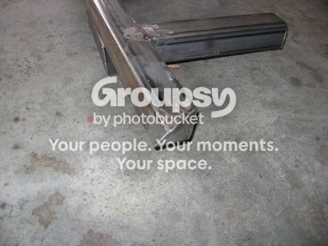

Cut off front 2" hoop, bent up 1.75" tube and installed with more angle.
DSC00428.jpg~original
DSC00442.jpg~original

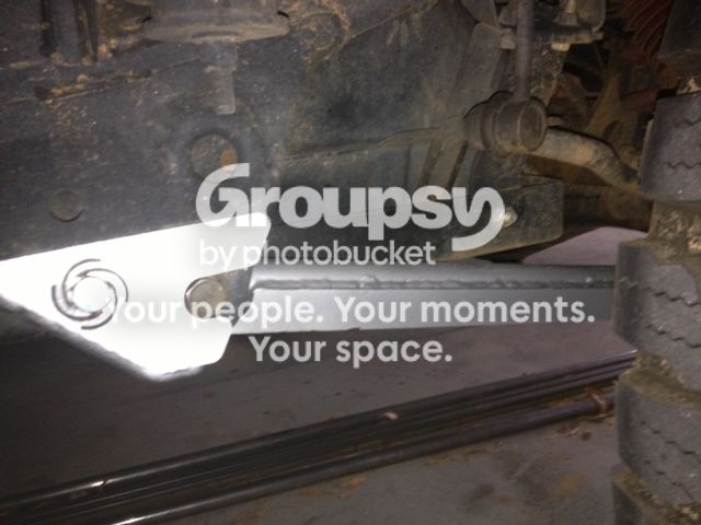

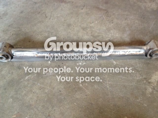

Picked up some heavy scars on the lower links from wheelin' trips like that. Added the Toytec armor for peace of mind and protection:
link2.jpg~original
link1.jpg~original

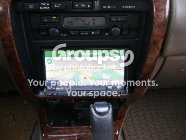

And for entertainment purposes:
DSC00522-1.jpg~original

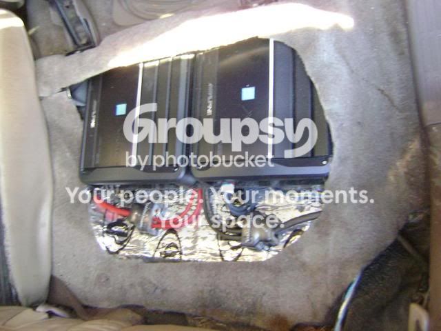

Amps under backseat, in place of factory jack:
DSC00520.jpg~original

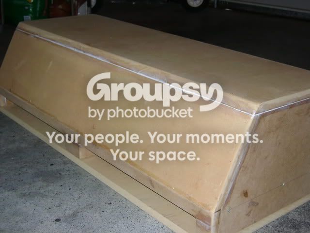

I made a downfiring sub box to protect subs from all of my cargo
DSC00452.jpg~original
Beefy enough to stack things on top:
DSC00521.jpg~original

Yea, I'd say you were long overdue.. I was too so no worries lol. 4Runner looks great! Love the louvers in the hood. Do you get a lot of water, debris or junk in your engine bay now?

Great build! Nice co2 tank too, how's it working for ya? Is it the one from Powertank.com?
Thanks. It is. Love it. It is one of their scratch & dents. Their website has a link for those, which are cheaper. You just don't get to choose options (i.e. color). I was hoping for anything other than yellow, but....beggers can't be choosers. Local beverage company refills it for $10. Can't beat it.
Thanks! Maybe a bit, but really haven't noticed too much of a difference. The louvers are angled and have a little channel that keeps a lot of stuff from running in there.

How much extra sound is there now with the lack of carpet in the cargo area?

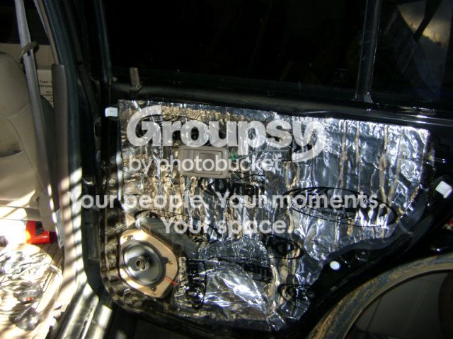

Thanks! There was a noticeable increase in road noise initially. I'm used to it now, so don't notice it. When I did the stereo stuff I put dynamat on all doors and floor in passenger area. This helped considerably and road noise is now probably close to stock.
DSC00506.jpg~original

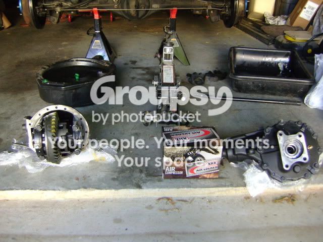

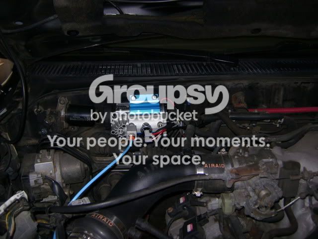

Are you locked up front as well? Didn't see that mentioned but noticed the shiny new looking compressor and blue air line :D
I am locked and loaded. I took that pic right after the install about a year ago. I use the front locker sparingly to protect all the bits, but it has come in handy several times and made all the difference.
A pain to install though:
