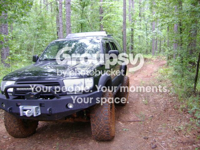

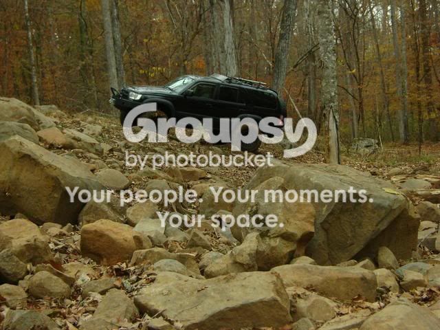

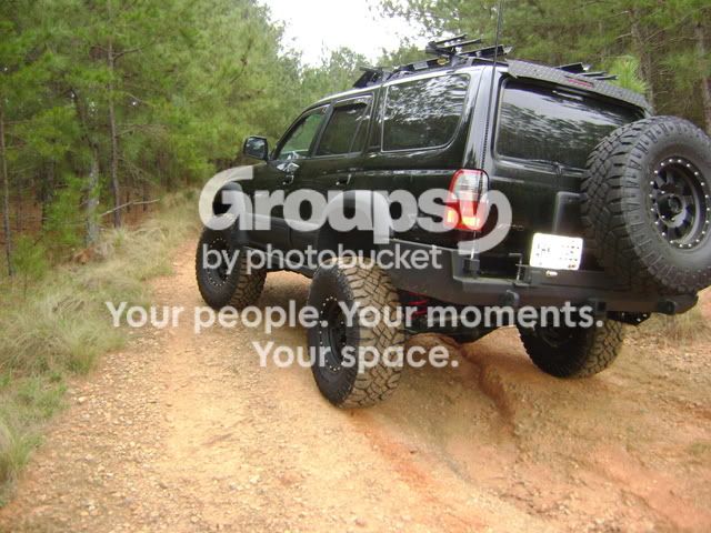

I started reading this and was like wait, why am I reading this again??? But just realized its posted today. And here now instead of yt. T4R is much better in my opinion! Where's the wheeling pics though????

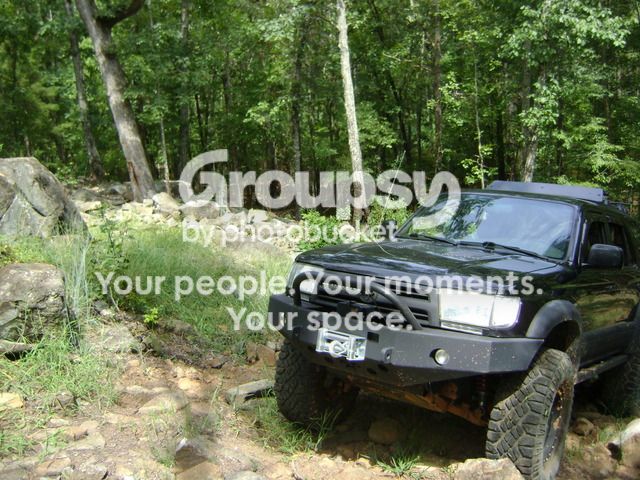

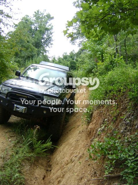

Yeah, there will be some duplicate pics until I am up to speed over here. I posted a couple of wheeling pics on page 1 but will add a few more. I will have some new ones next weekend.

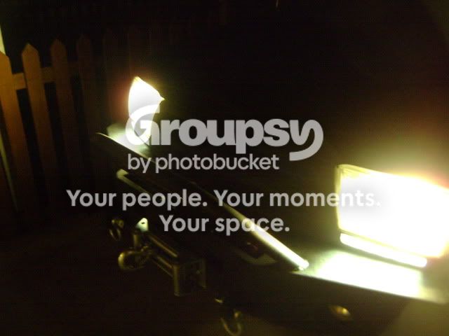

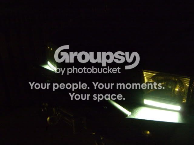

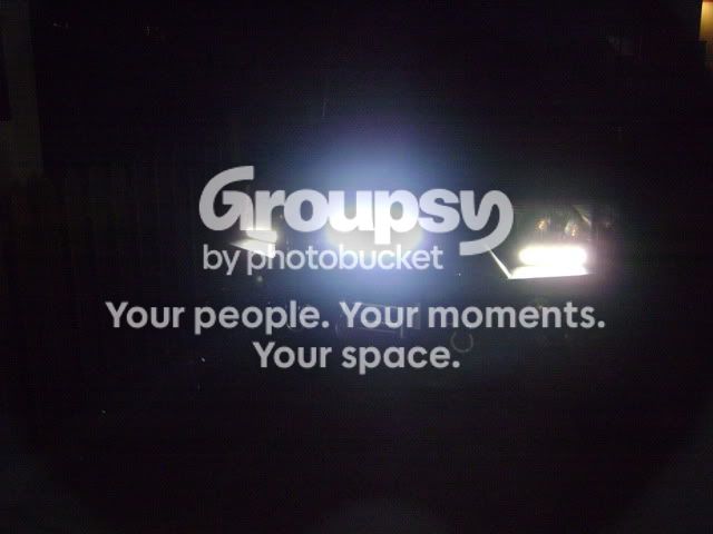

Thanks!! Yeah, it seems I'm a late arrival to the party. I'm really happy with LED DRL's. They are Hella's and are pretty bright. Could almost be headlights.
DSC00468.jpg~original
DSC00469.jpg~original
DSC00470.jpg~original

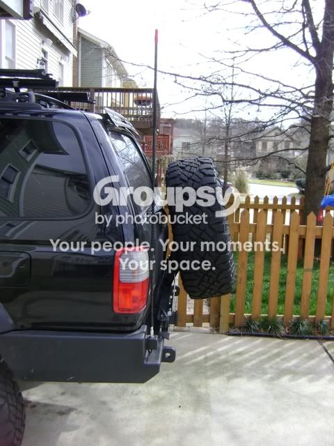

Thanks Nick! I dug up a few pics but don't have too many. This is how it looked when I picked it up. I knew right away I would be changing it.
tag1_zps6ee55695.jpg~original
I don't mind customizing to my likes. In hindsight I should have been more detailed when I ordered the bumper. This was my first bumper purchase, and as with everything, a learning experience.
I cut off the mounting plate (sorry no pics of that). I shortened about 6" of the 2x2 square tube and played with the angle to match the body line. With the plate cut off, I simply rested the tire on the stubby 2x2, angled the tire to match the body line, then scribed a cut line onto the tube.
DSC00440.jpg~original
I left a little bit of room in case I end up with different rims, wider tires, and to make sure it doesn't contact the tailgate with vibration, or while closing.
I later went back and added some additional gussets between the plate and tube. I cut out these little biscuits from 1/4" plate
DSC00528_zps4756e4d2.jpg~original
Welded them top and bottom of mount:
DSC00531_zps2c99bf2e.jpg~original
Hopefully that helps. I am much happier with it now, and it is much more solid than before.
