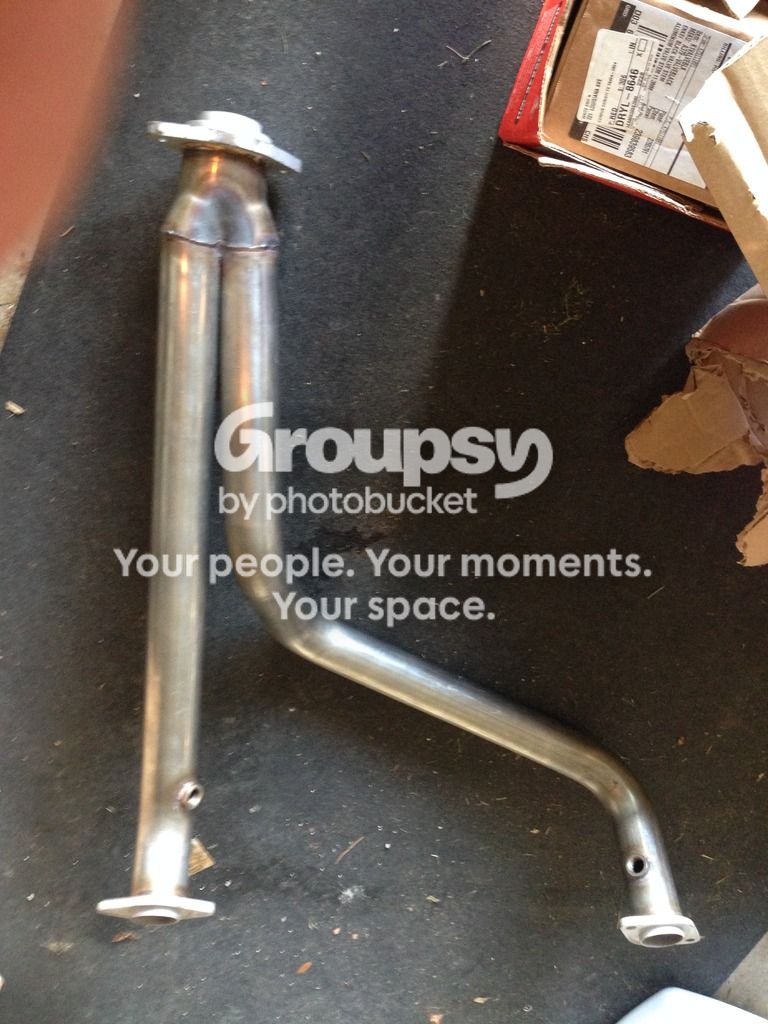

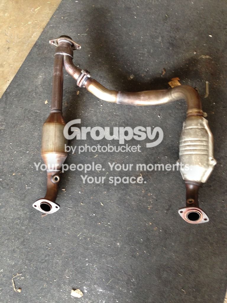

Here are some pictures of the factory Y pipe vs the URD competition Y pipe. The factory Y pipe is less than 2" O.D. in several spots on both sides before and after the cats. Also both pipes are crushed before going into the collector.
The URD competition Y is mandrel bent 2 1/4". This truck is not my daily driver but I have already seen an improvement in gas mileage but cant say I am surprised to say the least..
