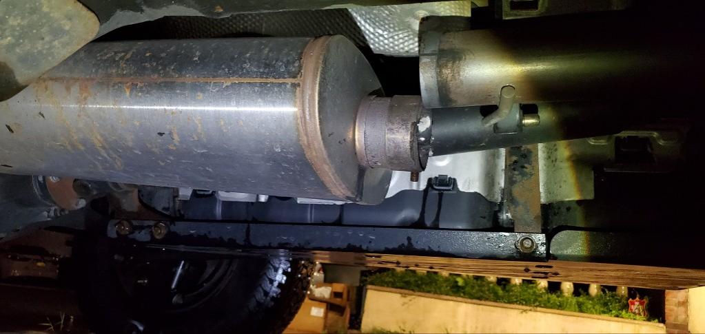

debating some 3" lap joint clamps
Hit a puddle too hard during the thunderstorm. And I found out my exhaust probably wasn't clamped tightly enough. Waiting for new clamps

Debating some 3" lap joint clamps
That sucks, but had it happen to me with a pothole. I had tried some 3" lap joint clamps, they stretched a little quicker than the URD provided ones. I'd suggest just having a shop weld the muffler on both sides, then you'll not have to worry about it.
thanks! will try to find a place.. the sizing on the muffler and the sizing of the rest of the system... makes it impossible to clamp it down perfectly
even the part that mates to the stock Y pipe.. seems so big that the donut isn't working well enough.
ordered a handful of clamps..
worse come to worse, i have the borla s type system in my garage... waiting to be installed.
replaced one exhaust clamp, to realize that 2 others have leaks and soot from them.
only the final clamp to the tailpipe looks good
i have the mark3 with the exhaust clamp with welded on exhaust hangers.. probably screwed if i tried to touch this clamp, not even replaceable.
