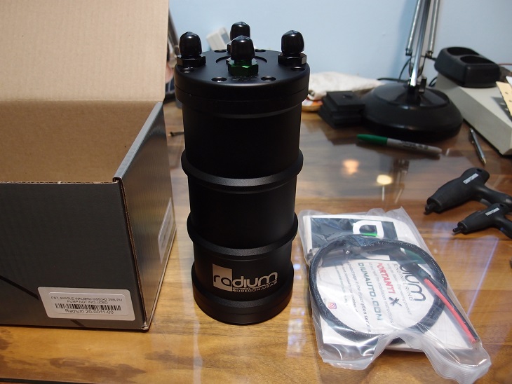

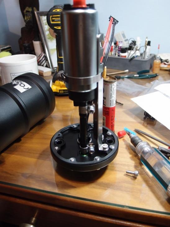

I received the surge tank and it was what I had expected. A nicely machined product which I hoped would work with the URD kit supplied Deatschwerks 9-201-0766 fuel pump. I anticipate a horizontal mount just in front of the fuel tank. With a horizontal mount it is important to have the fuel pump pickup located at the bottom of the surge tank. The Radium tank 20-0011-00 is set up to work with a Walbro GSS342 pump. Well the Deatschwerks could have been made in the same factory. The intake lined up with the outlet. Even the Plug matched so I didn’t have to put in a splice. My only problem was the Deatswerks had a fuel sock/strainer that was not orientated so that it would fit. Fortunately Radium sells a fuel sock that will fit in the tank and on the Deatswerks pump. I did clock the pump to line up with the holes shown on the the Surge tank and I will have to fab a bracket to attach the surge tank to the frame.

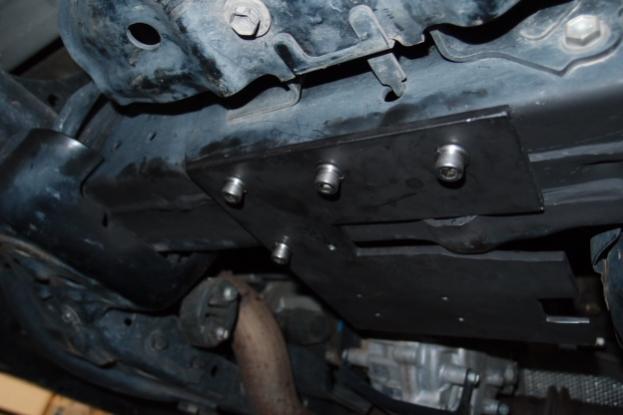

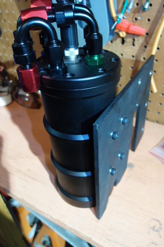

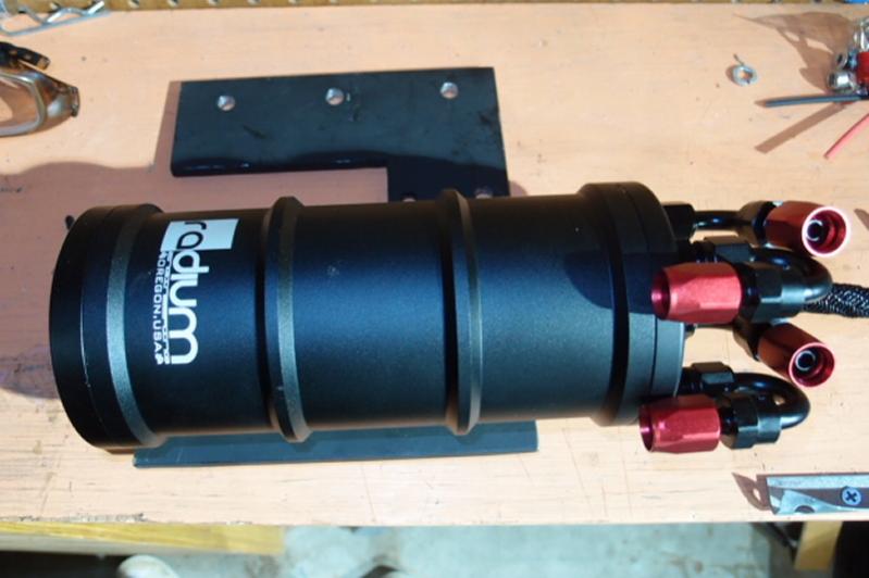

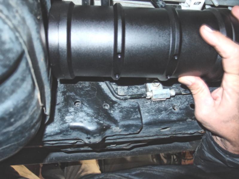

So I have now fabricated a plate that attaches to the frame and holds the surge tank. I used a cardboard template and brought it to a local guy that does art stuff. He charged $45. I ground down the worst bumps on the frame with an angle grinder and hit it with a rattle can of POR-15. I drilled the plate for the holes and then marked the frame for further drilling. The plate was overkill at 1/4 but then I am a noob. I had to come back and cut a notch in the plate with an angle grinder because the surge tank has a round bottom which prevented it from fitting flush on the plate. I used Rivnuts to thread the bolts into the frame, I guess you could tap the frame as an alternative. I wanted bolts so I could get in there if I needed to.
