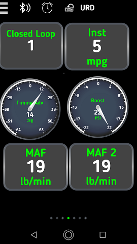

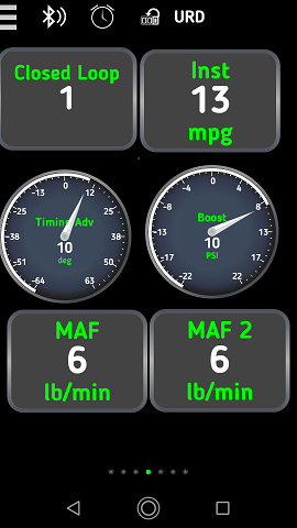

So I went Xmas tree hunting in the Forrest today. Took some screenshots of hill climbs. I do not think the Closed Open loop is registering correctly.
I thought someone indicated you could roughly calculate HP from the Mass Air Flow. I wish there was a Fuel Air or Lambda that worked for this app. Temp was 36%, Elevation 3750 ft. :nerd:
Light acceleration up the hill, Moderately heavy acceleration, Heavy acceleration
Thanks for sharing more info. The "Boost" sensor must be in Manifold Absolute Pressure. So, whatever it reads, subtract the atmospheric pressure (~14.7 psi or a little less since you are in some elevation).
So, you are actually still at ~-4 psi vacuum in first shot, and +7 psi boost in the third. This aligns. I agree it should show open loop at full throttle, weird it shows closed.

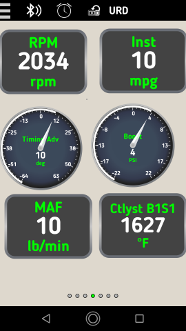

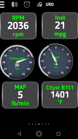

6k update.
City driving MPG 18. Feels a little less than what I was getting prior to the mod. Some of that is due to driving in the snow/slush which killed me.
Did a quick trip to the coast over two Mtn Passes. Blues and Snoqualmie. Prior MPG prior to the URD Supercharger it was 20.11 to 21.22 MPG. Post Mod was 20.51 MPG. The MPG post mod was more consistent.
The rig seldom down shifted unless on a steep grade. Below are some screen shots from Ultragauge blue during the trip. All photos are Cruse control set to 70 MPH. The first is level ground. The second is on Snowqalmie prior to kick down and the third is post kick down on same hill. Note the RPM to MAF (Mass air Flow). HP is 10 x MAF or so I am told.

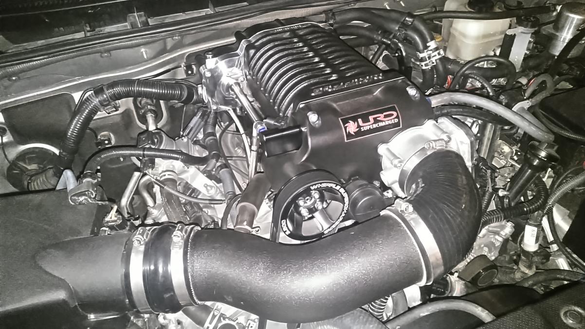

I thought I update what the top looks like. Not sure if you can see it but it also shows where the seventh injector sits. It is the black box to the left of the URD Supercharged label.

The Magnuson units do tend to be more available. I think the issue may be the adapter between the Whipple W140AX and the 1GR-FE Heads. When I got mine it appeared to be machined out of a solid block of aluminum as I could see some tooling marks. The remaining parts all appeared to be off the shelf type stuff that is available on the open market.
