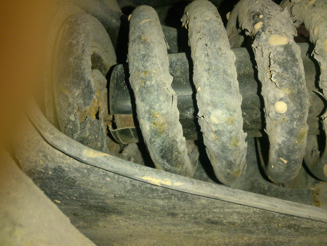

i really want your help my 4runner 2001 front shock and munt is broken but i did not found it here in my country so can i use tundra front shock and munt??????

Is the bottom of the mount or the top of the mount broken? Can you post a pic?
this is the picture
I don't think it's the same, but I could be wrong. Either way, I think it would be easier to fab up some metal and weld it up top instead of trying to replace the entire mount itself.
no the shock absorber is broken u can c that in the tip of the absorber
my question is can i use tundra 2001 shock absorber its look the same??????? that is because there is no spare parts for 4runner here in my country

I would say no. And even if it did somehow fit, you'd also have to do the other side too. You'd have to use Tacoma or Prado parts. If you find a Tacoma, you could get away with doing one side. You'd need to use both sides of the Prado though, I'm pretty sure.

Yes a 2001 Tundra shock will work, but you will need to use the 4runner top hats. I would replace both sides while you're at it though.
