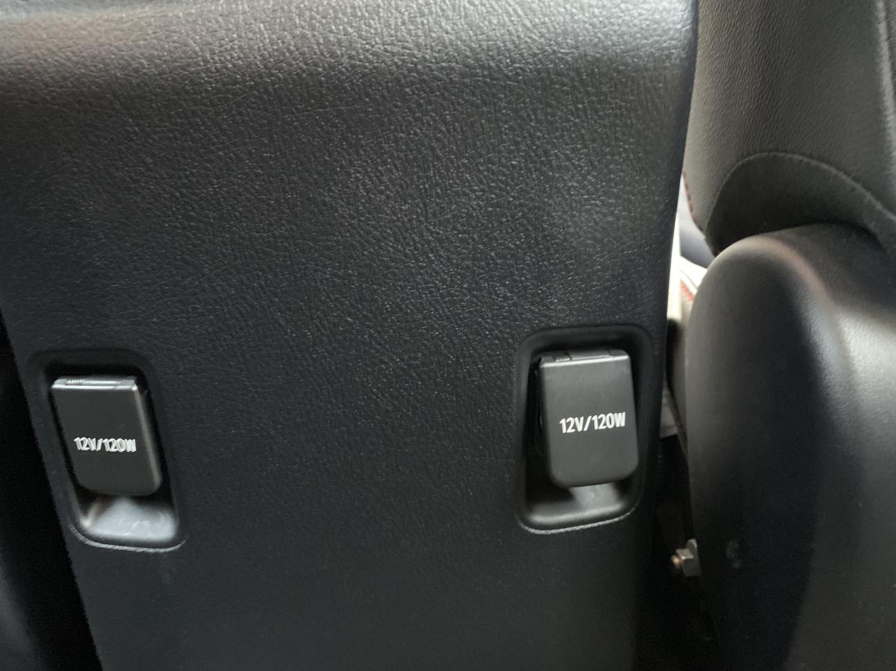

I see southeast region 4Runners with 2x 2nd row USB ports along with seprate 2x 12V outlets. Anyone have any information on how to get the panel like this? I can’t find it in the Toyota parts catalog.

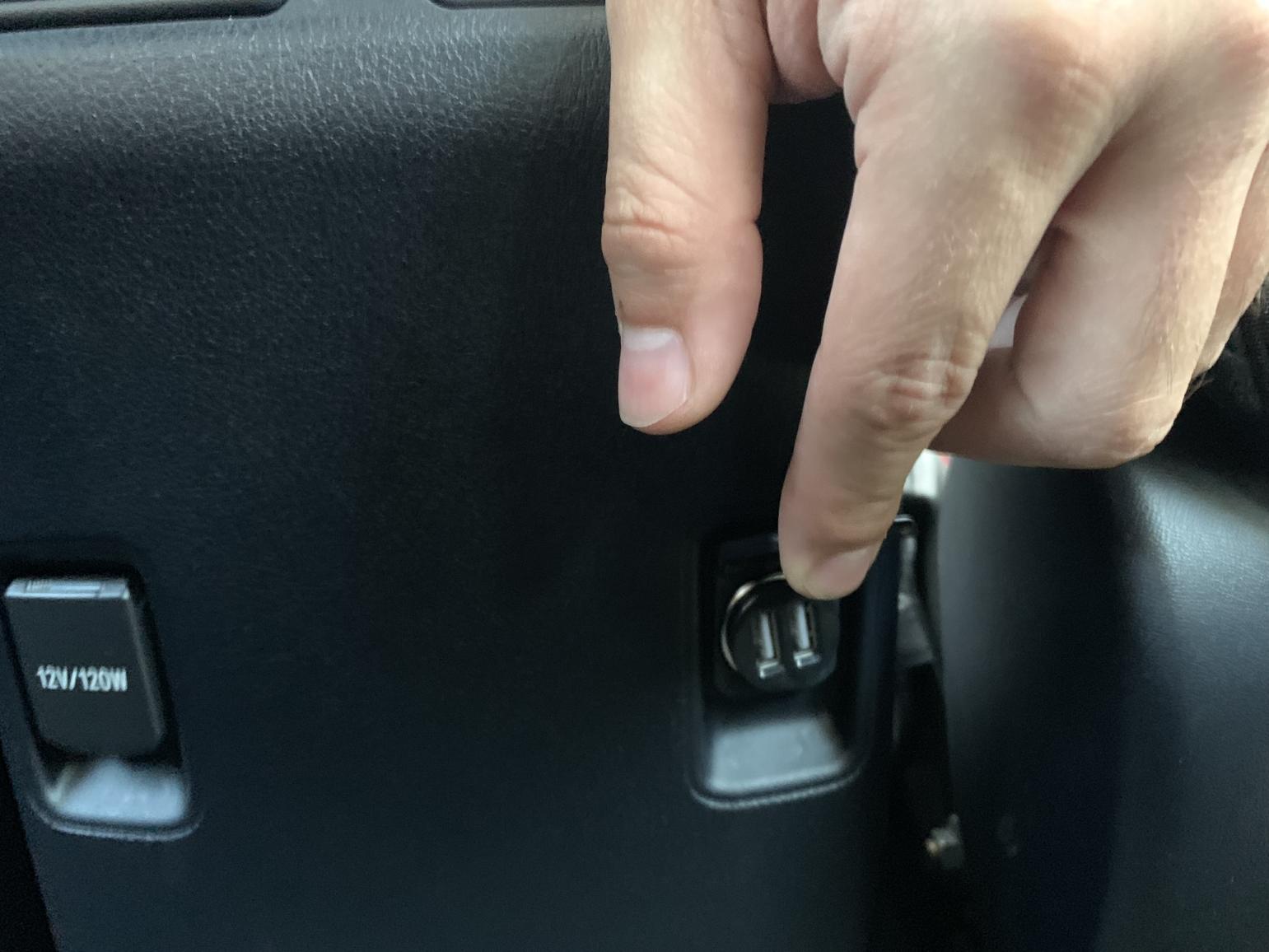

I shoved one of these in the port:
Does the cover close when not in use? I bought a similar "flush" unit but it still interferes with the cover thus the cover sits up a bit and catches my kids feet when they slide across the seat getting in/out. If this fits under the cover please post a link to where you got it.
It doesn't fully close but it closes enough to not be in the way. I don't have kids but haven't had any issues with adults in the back.
I can get a picture later.

Pics attached...

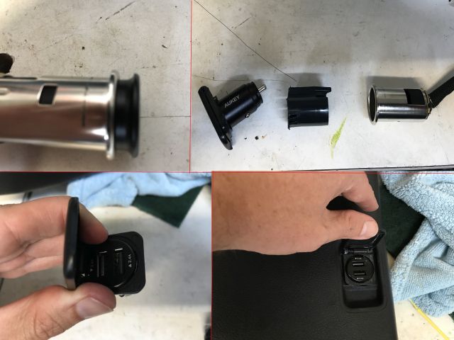

I worked on this over the weekend and wanted to pass on what I did.
I pulled off the back cover from the console, pulled out the plug, then pulled out the spring loaded cover which is all one piece with the sleeve (barrel) that the outlet is slid into.
I bought one of the hardwired dual USB sockets listed in this thread but when I got to looking at it, it was just too big to install and keep the flip up cover that the truck came with. I could have installed it flush mounted like others have on this thread but I kind of wanted to keep it stock looking.
I went back to the idea of using a plug-in adapter in the original 12v socket. If you look at the top left photo, this is how deep the Aukey brand socket fits. (I got this off of Amazon, its similar to the Griffin one someone else posted) It sticks out an 1/8" preventing the little door from closing when its in the factory socket.
Since it has the same lip and is roughly the same size as the 12v outlet it fits nicely in the base of the cover.
What I did was used a Dremel to cut the "barrel" portion from the cover. (See top right of photo where I have the aukey plug in the faceplate and the barrel cut off) Then I mounted the faceplate with flip open cover to the console using a dab of epoxy. I put the Aukey plug in the front of the cover and used the original 12v outlet slid in from the backside to hold it on place. Then I slid the original "Barrel" that I cut off over the 12v outlet from the backside of the console and epoxied it back together. The Aukey plug fits tight in the socket so it held it all together while the epoxy dried.
When I was all done the Aukey plug is flush mounted where the 12v socket used to be and the spring loaded door still closes all the way. Plus since I'm still using the original 12v plug I didn't have to cut or modify the wiring. Oh and if for some reason I want to go back to stock its just a matter of taking the Dremel to the epoxy and putting it back to stock and gluing the barrel to the faceplate.
Hope this helps someone who wants to keep their outlet stock looking.
