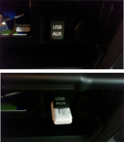

Love the 4runner, hate that the usb is in the glove box. I actually thought about taking the dash apart and swapping the locations of the usb and aux connectors. But i came up with this quick fix instead. I took the panel off the inside of the glove box and fished the usb cable through to above the aux jack and under the flip down door.

Then i notched the plate for the cable.
b7706c9722bd7ccd4b48ba09ae64b98a.jpg~original
The cable can be rolled up and stored behind the door when not in use.

Pretty cool idea. I toyed around with the idea of purchasing another OEM USB port through my dealer...price was around $100 so I scratched that idea pretty quickly. This looks like it might make a good alternative other than swapping the ports with each other entirely.
