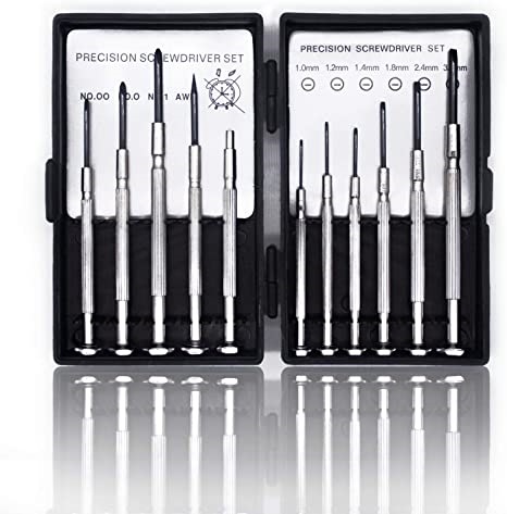

You need a small flat tip screwdriver set similar to this. The terminal removal kits on Amazon are junk. I installed an aux fuse box from a '04' Grand Cherokee in my '18 Runner to avoid changing main box.

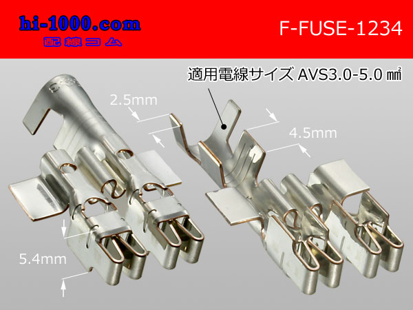

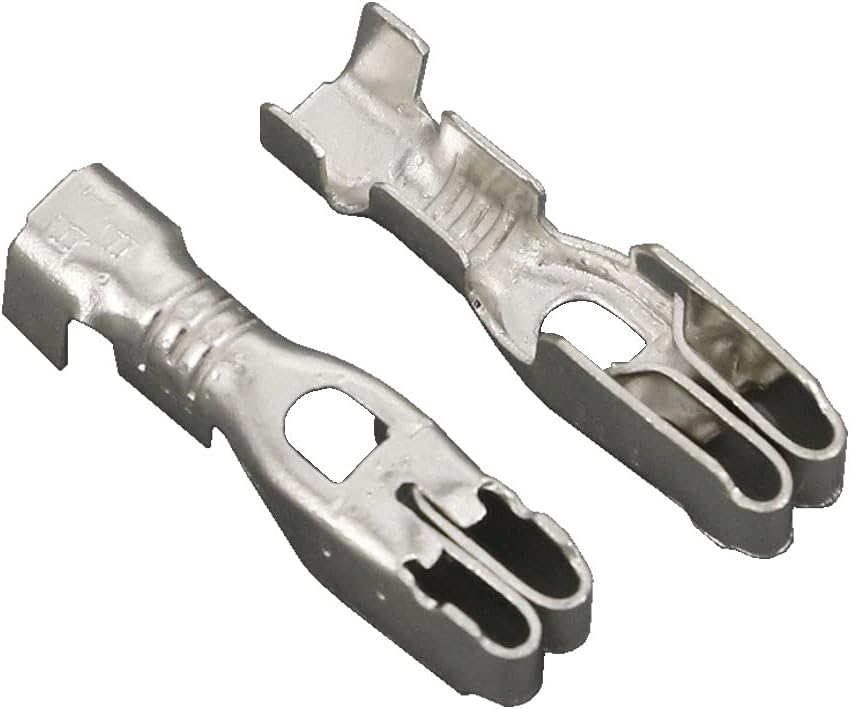

It's been a while since I did this project, but I believe that the terminals you linked will not work.
If you look closely, you'll see that they are missing the small "step" and the "wings" that Toyota terminals have, as do the ho-1000 terminals. I think both are needed to properly snap into place in the fuse box. But I could be wrong.
