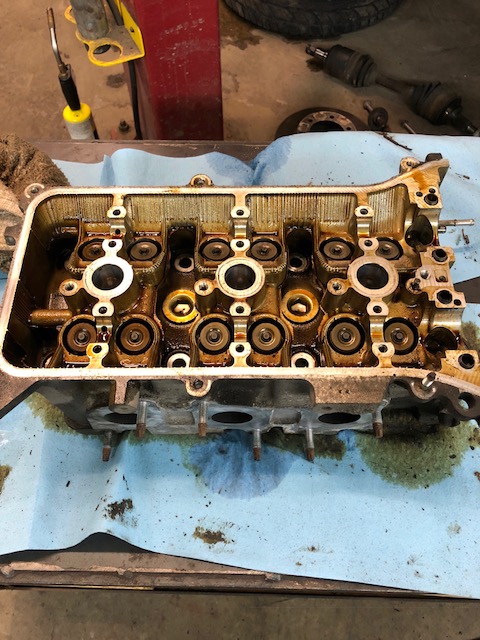

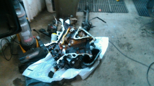

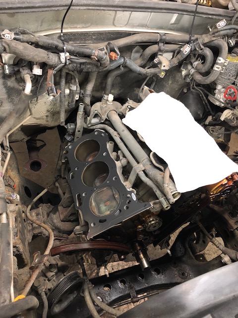

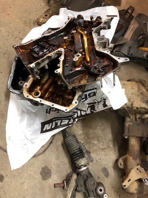

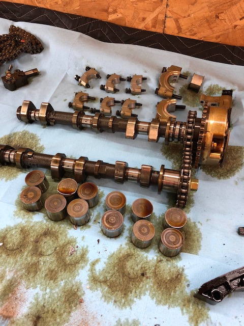

2006 Head Gasket
2006
4x4
161,000 at time of repair
Passenger side
I brought my car in for state inspection and found out that the passenger head gasket had been gone for some time. I noticed it was draining the coolant reservoir months earlier, but the head gasket didn't cross my mind so it was bad for at least a couple of months!! It was about a 22 hour job and one of the worst/hardest jobs my mechanic has ever done.

2006
4x4
Passenger side
I assume they replaced both sides and not just the passenger side? Hoping 22 hours what I'll be looking at and for doing both sides. Mine is parked in the shop parking lot waiting to get looked at. Mine is driverside, assuming the information is correct that I got here and cylinder 4 is middle driverside.
