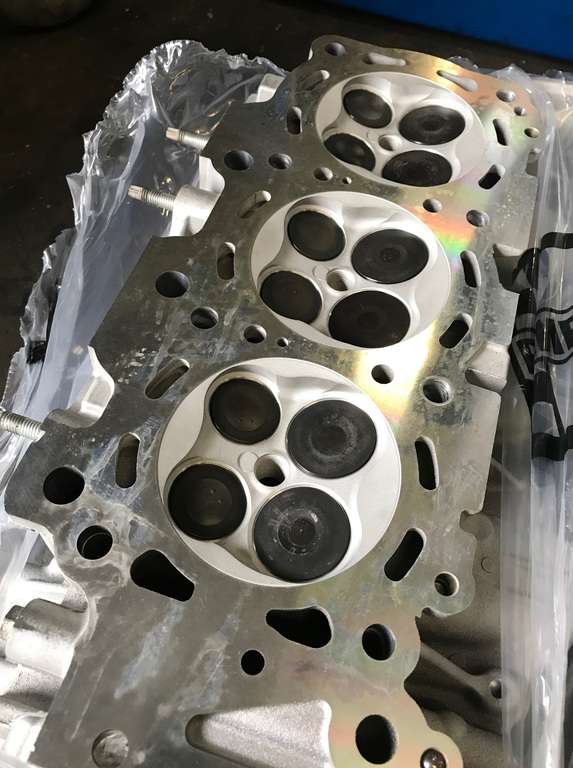

Started Rough, then ran OK. Decided to do the job myself. Ended up pulling the motor out for various reasons.
Has anyone ever measured the head and the block for warping? Sure sounds like the head needs to be milled to get everything back to flat. A warped head will just continue to blow gaskets for all time.
When replacing these head gaskets the heads should be checked by a machine shop for being true and or machined so that they are, any shop that doesn't do so is incompetent, the block rarely warps unless the engine was extremely over heated.
My mechanic did. The block was straight. The heads were off by like .00001 mm so they got a light re-touching and had the valve seats and valves cleaned.
