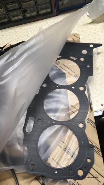

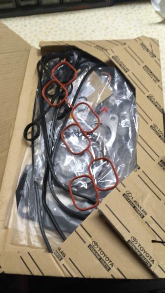

Thank you, I ordered the Parts off of Amazon, but the way they were packaged (some labeled, some without, and the box not being able to be closed) led me to question if they were OEM or a knockoff vendor.

Wow. No way would I would trust that.
This is a big job and I would be buying all the parts right from the local dealer or camelback toyota.
At least if you buy local, you can go back to the parts counter and complain face to face if needed. Not so much with some ghost online vendor.

So I called Amazon and they said it was sold by Amazon and they listed the vendor as being purchased from Toyota. It still seems sketchy, but I was hoping that someone who had bought them before could chime in on what they remember seeing.
Those are 100% oem gaskets...
The giveaway is the burnt orange intake plenum gasket ....only made that color from Toyota OEM. .
All after market ones are either a blue, black etc etc but none have copied that exact burnt orange color. You ever wonder why they make some gaskets colored like that.... while the rest are black.
