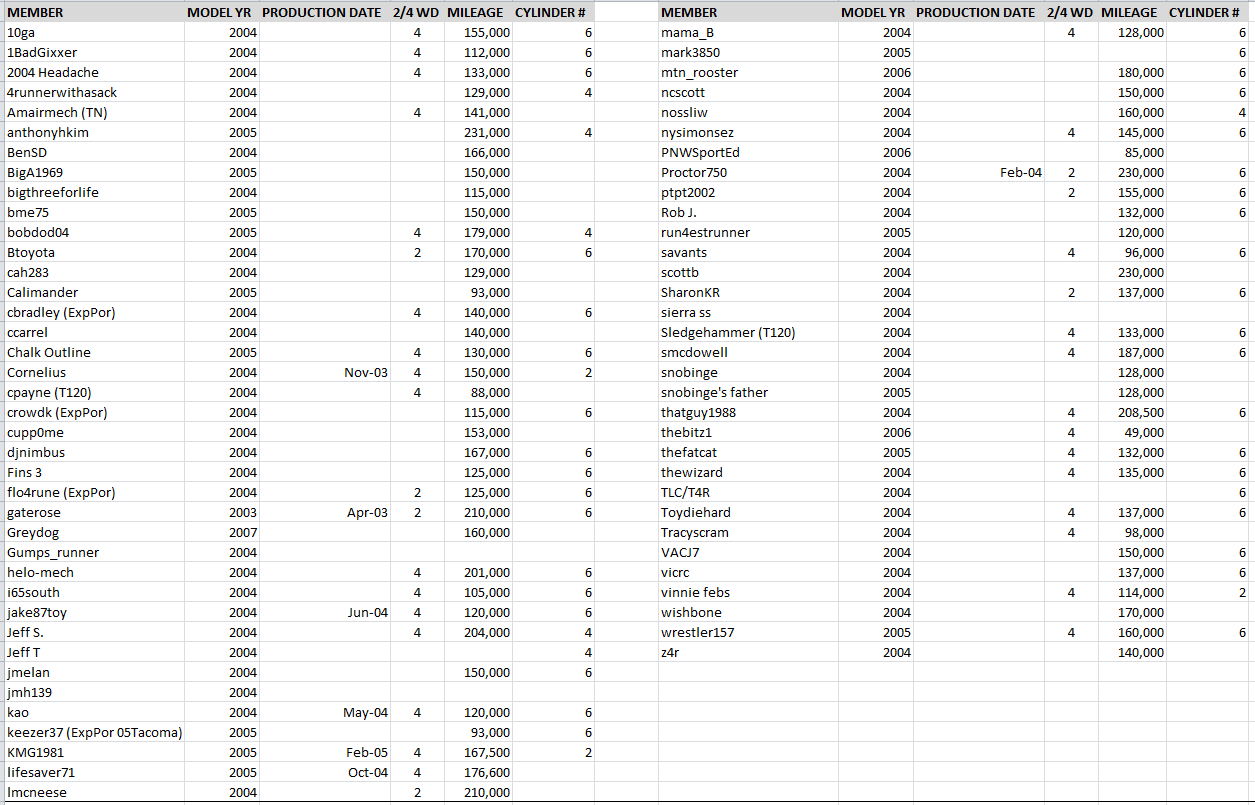

Updated List:
I wonder why there's not many 2003 models on the list? Mostly 2004 and 2005. I sold my 2003 4.0 last year with 175,000 miles and never had an issue with it.

There isn't enough data to make any sort of correlation or conclusion about the HG issues some owners have expereinced. While it's unfortunate, the failures reported on this site are less than .01% of 4runners sold in 2004 (the most reported year). I wouldn't consider that a problem even if the actual number of failures was 100 times worse at 1%. So while this thread is a good summary it's pretty much pointless for the intended purpose to try to shed some light on correlations or conclusions if those members who have experienced this failure don't share all the requested information. The production date of the vehicle really doesn't matter because the engine could be assembled at a completely different time and not installed sequentially. What I'm really interested to see are the EIN's seeing how this is a potential engine issue, vehicle production date can't technically be correlated since we can't confirm engines were sequentially installed off the production line since they're assembled seperately, shelved, and then pulled for install to the vehicle at a later date.

If you still own the 4Runner and you're willing to share, please reply with the missing data about your head gasket failure
Model year
Mileage at failure
Cylinder,
Production Date (on driver door jamb sticker),
11th digit of VIN (This denotes the plant of manufacture from link above) (0=Tahara, 8 or 9 = Hino)
EIN (Engine Identification Number) Is found on rear passenger side stamped into engine (next to VIN plate on engine).
Model Year = 2008
Mil at failure = 46,713 (before my ownership)
Cylinder = 6
Prod Date = 03/08
11th digit of VIN = Ive counted 10x it my 11th digit is 'K'
EIN = 8K024165
Hope this helps
Model Year = 2008
Cylinder = 6
Prod Date = 03/08
EIN = 1GRFE
Hope this helps
thanks. I overlooked the possibility of "K" sorry for making you think you were crazy. haha... the EIN is not 1GRFE though.. that's the engine identifier.. the EIN is on the plate of the engine passenger side by cylinder #5. you may need a mirror to see it after wiping it off.
I fixed my post above (EIN). The only digit I am not 100% certain of is the 'K', will try to take a better look at home tonight.
thanks... I believe the EIn should be 7 numbers (no letters) but your 4Runners seems to like "K's" so who knows... haha

plant of manufacturer was inferred from this attachement... it's for a different recall on the 1GR-FE.
2005 Sport 2WD V6
Misfire on 6 cyl around 168,000
Head Gasket!
Sucks it happened because when we tore it down the internals looked brand new..
I don't have all of the requested particulars handy, but here is what I have:
2006 SR5 4WD.
Started with misfire on #4 almost a year ago at ~ 140,000 miles.
Mechanic couldn't confirm head gasket even though I suspected it based on symptoms and he did pressure test and bore scope.
Milked it for about a year until I got two misfires within weeks on #6 at 156,000 miles.
Owned since new.
I reported it by phone to Toyota Customer Care and received a confirmation or case #.
Our family has been bitten by the head gasket bug again. My other son has a 2004 4.0 T4R and found out today more than likely the head gasket is shot. It started about 4 days ago. He started it up and it started missing and shuttering and the check engine light came on. Took it to a friends and it says misfire on cyl #4. We swapped the ignition coil out and cleared it. Did the same thing this morning and same code and same cyl. Also loosing coolant in the coolant reservoir tank. We're going to take it to the dealership to confirm and then for the sake of principal, I'm going to start my campaign to have something done about this problem from Toyota. Will it do any good? Doubtful but I'm going to try everything I can. This is the 2nd head gasket on a 2004 4Runner in the last couple months for us. What's the chances?
You can add me to the list. I've got the parts from various places online and my son is going to start on it this week.
2004 v6 4x4 170k, misfire and leaking coolant into #6. Same symptoms as everyone else. Overflow tank draining and coolant verified in #6 with borescope. Never overheated so I'm hoping heads don't need milled, but I'm having them inspected and pressure tested and getting new valve seals at a minimum. I'm looking at $700-900 with zero labor.
Add yet another to the list.
My 2003 4runner SR5 has the head gasket leak on the left cylinder bank. We bought the car about 2 months ago with 127,500 miles on it. It drove great and was in good physical condition. It had no starting problems that day. The next day it showed its problems. It has been all over the place with PO300s and PO30x DTCs. I used BlueDevil Head Gasket Sealer based on this and other forums but it didn't work for me (or it caused the problem to move from the more vulnerable Cylinder 6 to 2 and 4 as confirmed by an auto repair shop). Taking it to the local dealer as the shop I took it to didn't want to do it. Hope to have a good vehicle for another 70,000 miles.
I had added myself to the thread Head Gasket -Survey- Specifically V6 previously. I don't know if everyone in that thread is accounted for here or not.
My vehicle and problem
2004 V6 SR5 4x4
approximately 171k miles
coolant in #6
11th digit on VIN is 8
Don't have the other information handy now.
Rough idle at startup, at first occasionally, then after a few times, it would happen every time the vehicle sat for a while. Noticed coolant disappearing from overflow tank. Radiator test did not indicate exhaust in coolant. Leak verified with borescope. Well maintained and never overheated. I also called and reported this to Toyota.
My 2005 Toyota 4Runner Sport Edition V6 4WD was leaking coolant at #4 cylinder. The check engine light came on and stayed on. On a cold start up, the engine would misfire for about 30 seconds to about a minute before smoothing out.
I never lost a lot of coolant and the engine never over heated. I think that I caught it just when it started to leak.
The dealer said that it was the head gasket causing the problem. So, at 125,000 miles, I replaced both sides.
