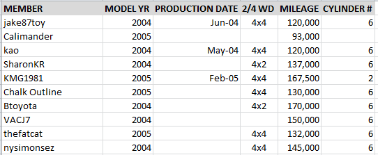

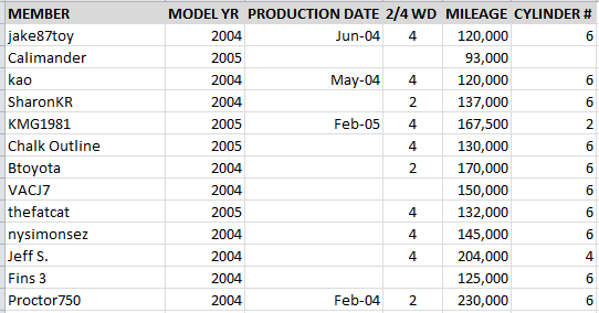

So far not 1 03' is on the list. I wonder if something changed between 03' and 04'? Mine is an 04' but built and purchased in 03', all the others in the list (from info given) are 04's and 05's built in 04' and later. Interesting and I will keep updating the spreadsheet when I get people to post new info.
I am really curious about the build date which many are not posting.
