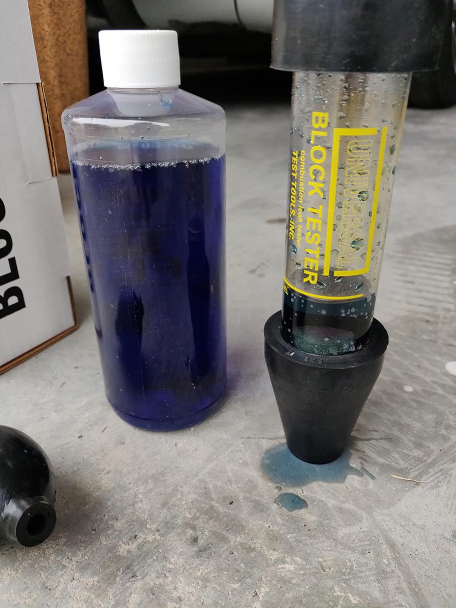

I'm the new owner of a 2004 V6 with 170k mi on it currently. I'm also getting waterfall behind the dash so I went ahead and conducted a chemical combustion test today.
This test comes with dark blue liquid. If the liquid stays dark blue, your engine block is sealed and good. If it turns green, there's probably a slow leak. If it turns yellow, HG is blown.
Mine came out blue, kinda teal. That means I probably have a slow leak and will probably have a blown HG in a few years. I recommend everyone with a 03-05 V6 do this.
Currently I will do nothing and test again after maybe 8-10k mi. My plan is to add Blue Devil before it blows and I think that will do the trick.

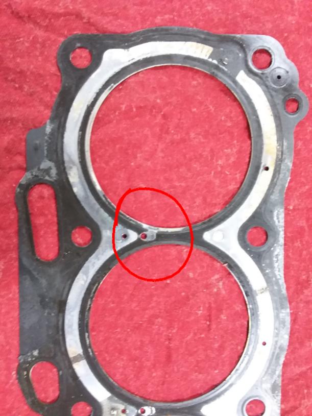

05 V6 at 248k developed cylinder #4 misfire. Scoped and confirmed head gasket. Debating now on repair vs. sell and if repair then what else to replace while in there like timing chain, water pump, injectors, etc. and get another 250k out of it.:shrug:
Get the gasket kit for like $200ish, it has all the gaskets you need (including both head gaskets). I didn’t need a new timing chain or cam shaft chains or timing guides or tensioners. I did replace my vbelt and water pump. And the pulleys for the v belt are easy enough to change at a later time.

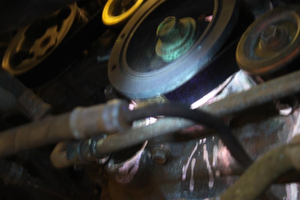

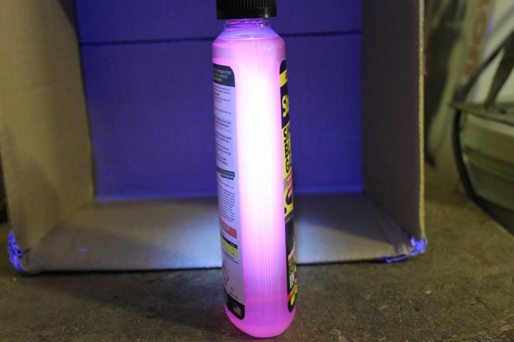

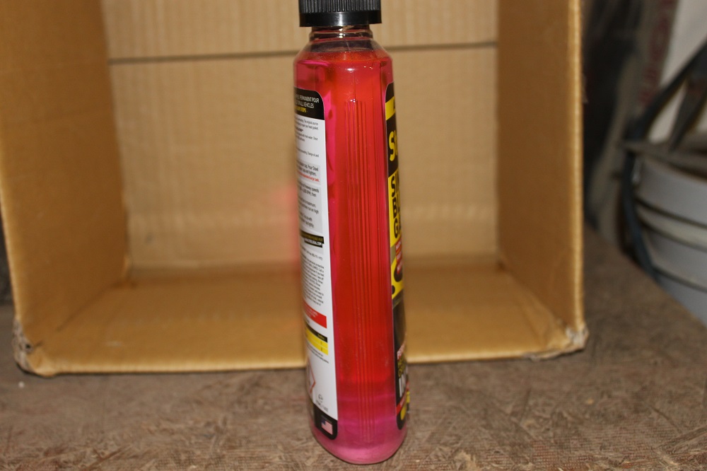

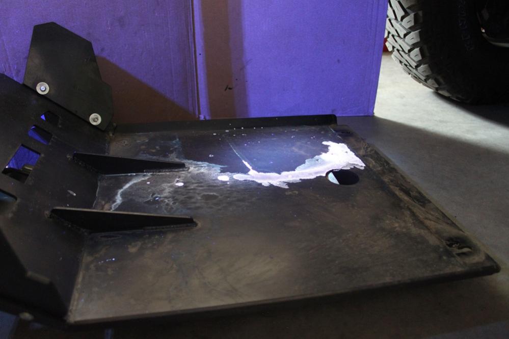

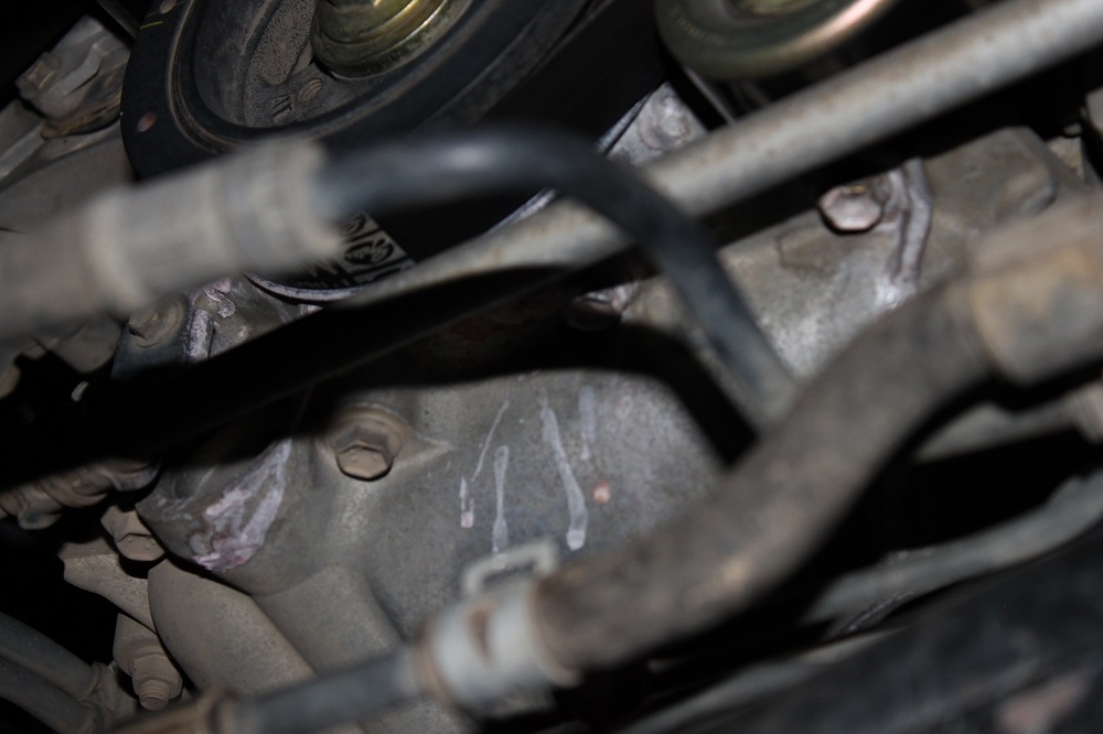

Bought this krazy UV flashlight... UV Beast v3.
Waved it around the engine bay... DAMN, NEON GLOWING antifreeze is all over, looks like the water pump... again.
Either i did a piss-poor job the first go or was a bad pump from the get go, seems unlikely.
I am going to dig into this over the next couple days.
I will add some UV pics, pretty amazing...:fear:
So this is another water pump for me.
More of a recent looking leak.
If i had looked closer i would not have needed the UV...der.:rockthrow:
Had my front skid off not all that long ago and didnt see this.
While not exactly head gasket related it maybe a good way to rule out leaks like the water pump, hoses, t-stat or other...
Phosphors in the antifreeze glow neon pink under UV light.
No additives just the coolant.
Waved the UV light around a 2014 GX460, not a speck of glow.
Just antifreeze in first 2 pics.

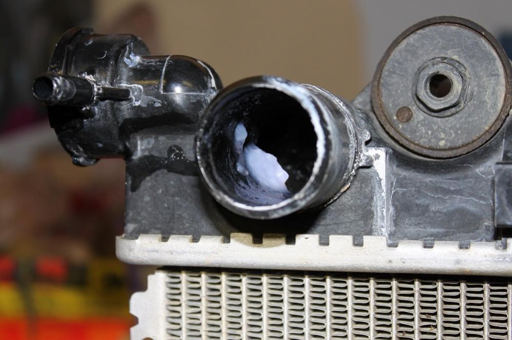

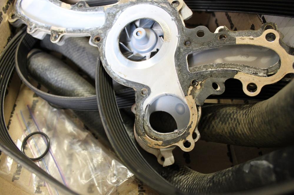

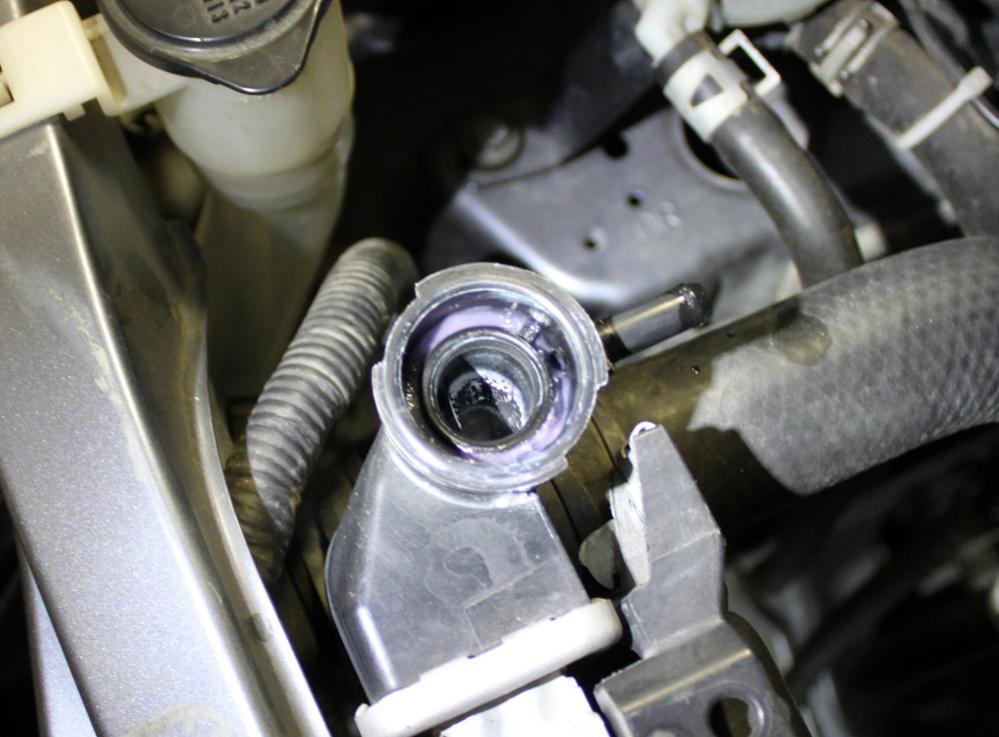

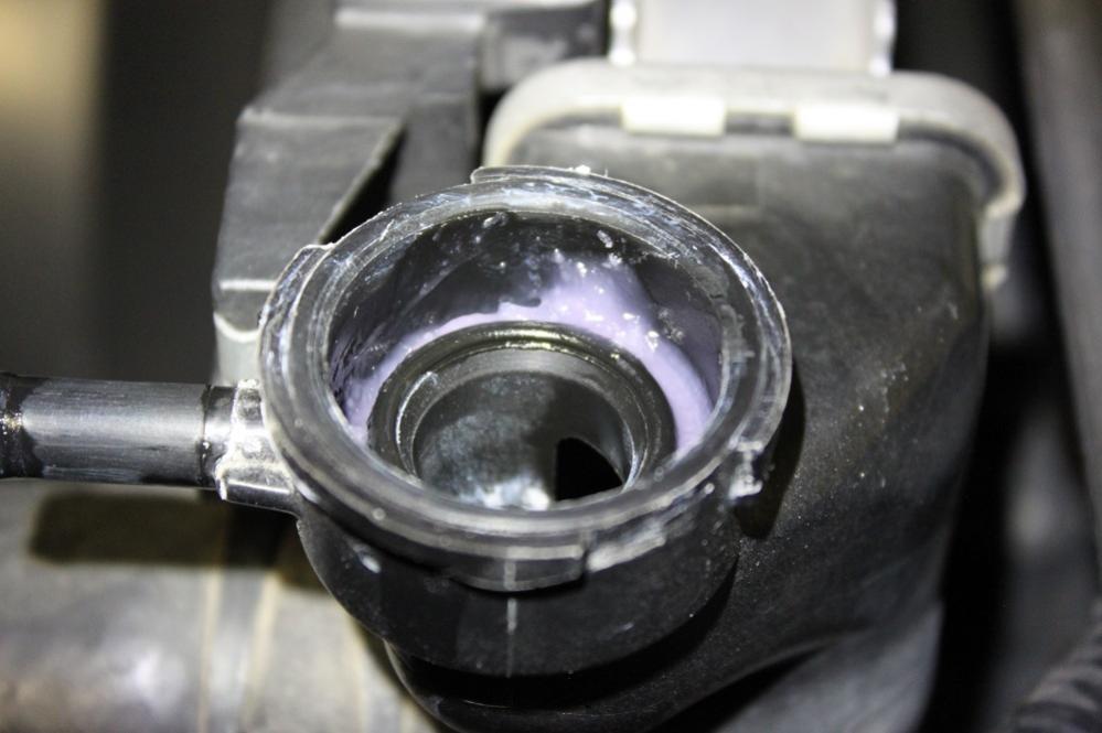

Cheap water pump gasket looks like it maybe the stuff i thought was HG material...a few post back.
...SteelSeal is BAD.
Turned into a vaseline like consistency and gummed up the radiator and who knows what else. :caked:
