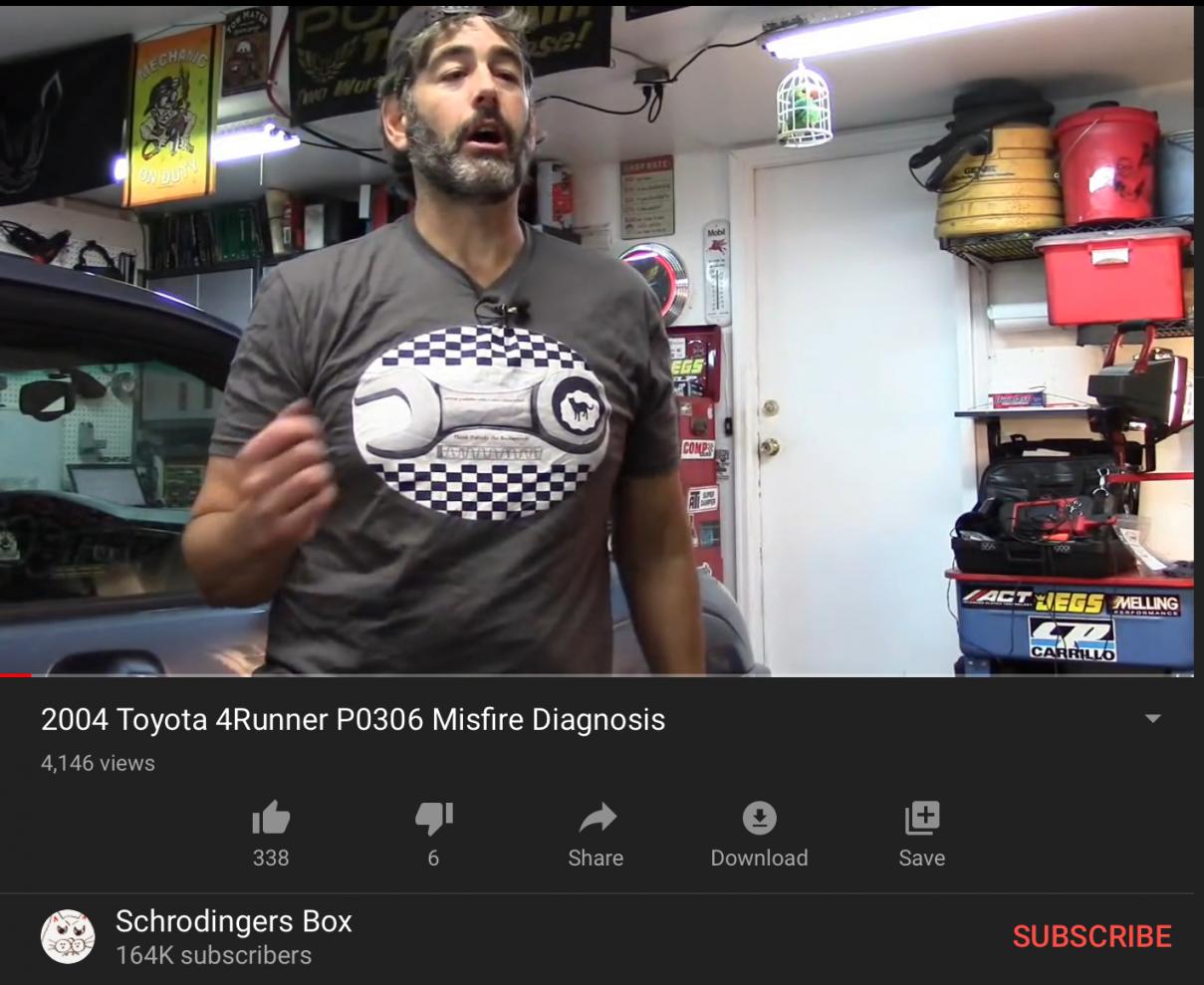

The waterfall sound that's related to a bad head gasket is usually heard coming from behind the glove box not the steering wheel, so I think you most likely have trapped air in the cooling system.
Look up this video that was just posted on YouTube.
Food for thought...
Food for thought...
While I like his diagnosis process, I would have loved to see a follow up confirming the intake coolant leak by fixing the issue, because a bad head gasket could produce coolant in that cylinder so there would be the same results he came too with the coolant system pressure test.
Food for thought...
Complete rubbish. How does coolant leak past the intake manifold when there are no coolant jackets in the intake manifold?
"It's 100% definitely not a head gasket". Well then, how does coolant get into cylinder? Either a blown head gasket, cracked head or block.
