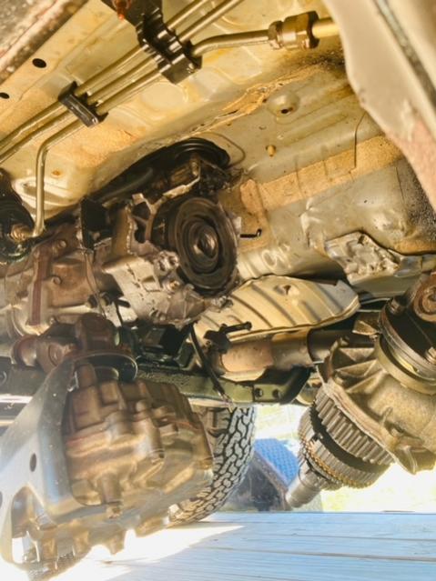

I bought a 2000 V6 with a manual transmission and j-shift transfer case last weekend for a good price, but the catch is the transfer case blew up in it. That is not an exaggeration either. Anyways, I've sourced a used j-shift transfer case, but I cannot find any used (or new) OEM front and rear driveshafts for a V6 manual. Unless I can find some used ones in good condition soon I'm going to order some custom ones from Tom Wood's in which case I will need measurements.

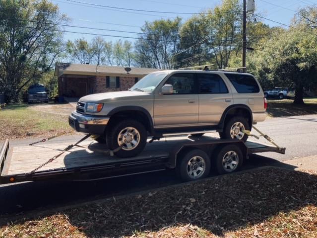

Here's a photo of her and the carnage that happened.

Looks great. Good find. Hopefully some one can provide you with the correct measurements. Have you already tried ebay for used ones?
I didn't think about checking ebay. I checked car-part and they wanted a ridiculous amount for used ones with 200k-300k miles on them. Thanks!
The interior is in amazing condition. The only wear is a small pinhole in the passenger interior door panel and the shift knob. It even still has the 3 step piece for garage door openers!
