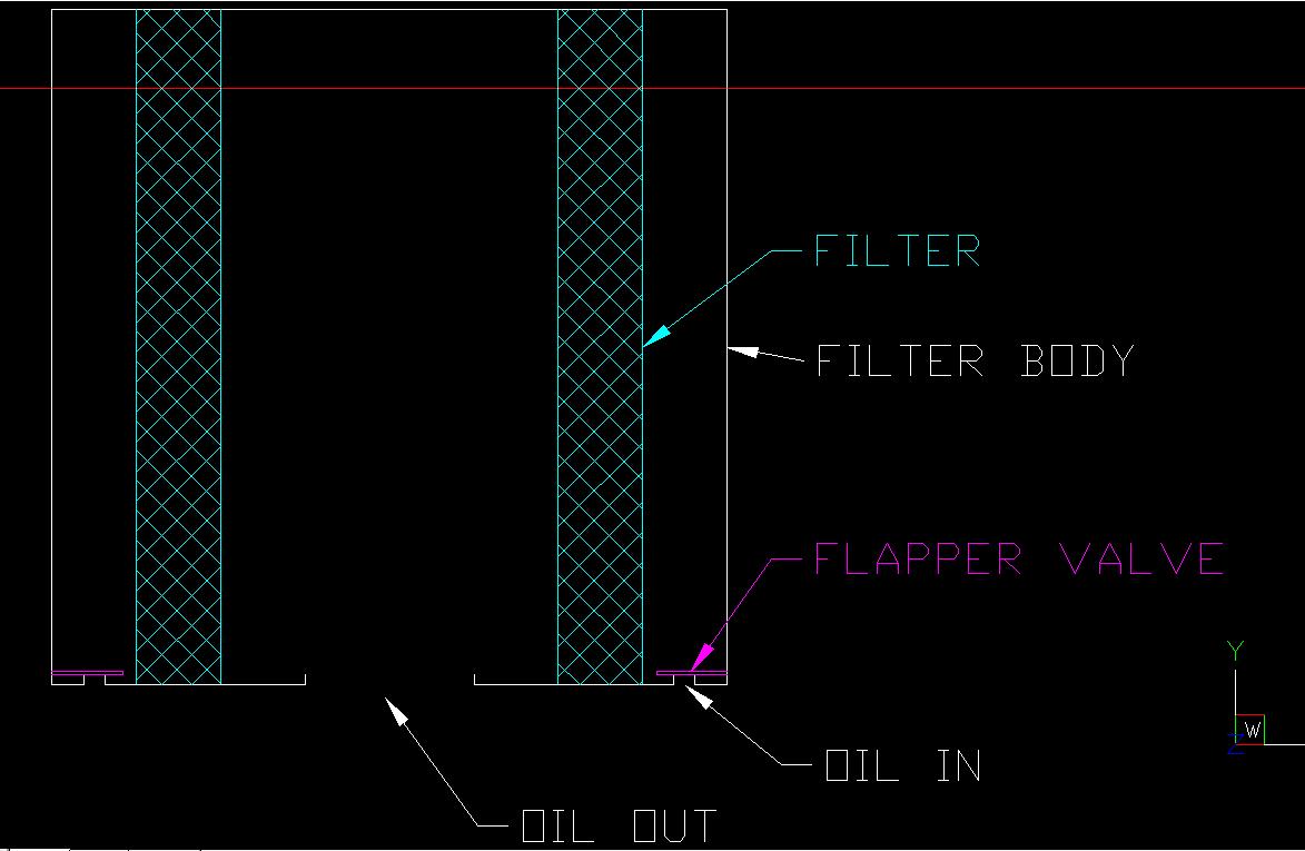

Ok kids, this isn't complicated. Oil fills the filter body, soaks into and through the filter material when you fill it. If you just fill a dry filter once, most of the oil will soak into the filter material and the center will look empty. If you saturate the filter material you will see oil standing in the center, nothing to keep it from flowing out if you flip the filter over. Oil outside of the filter element can't readily flow out past the rubber flapper valve, but can flow through the filter element into the center and out the outlet hole.
I'm not sure about a valve in the center outlet pipe that keeps oil in the filter, I'll have to look down there next oil change. I'm wondering if I pop a hole in the housing to let air in, will the oil flow out the center while I'm doing other things? I've done that on boats, helps keep oil out of the bilge.

You're right, this isn't complicated. An anti-drainback valve is a piece of silicone rubber that fits over all the small holes in the filter. It usually is pressed against the holes via spring tension. Oil pressure overcomes this spring tension and allows oil to flow. Once oil pressure stops, spring tension causes the seal to hold the oil in the filter and not flow out of the small holes and back into the engine. Very simple and very effective. And that's exactly why I can remove my oil filter without spilling more than the few ounces that were in the very center of the filter.
If oil continues to drain from the filter in the time it takes to remove the filter (as some have claimed) then you either have a filter that doesn't have an anti-drainback valve, or you have a filter with an ineffective anti-drainback valve. I don't want my oil filter draining itself every night while my 4Runner is in the garage. Over time, that can cause accelerated engine wear.
