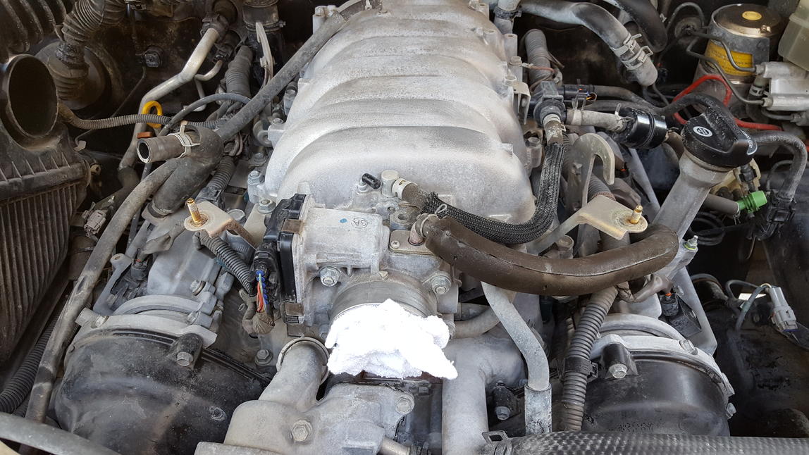

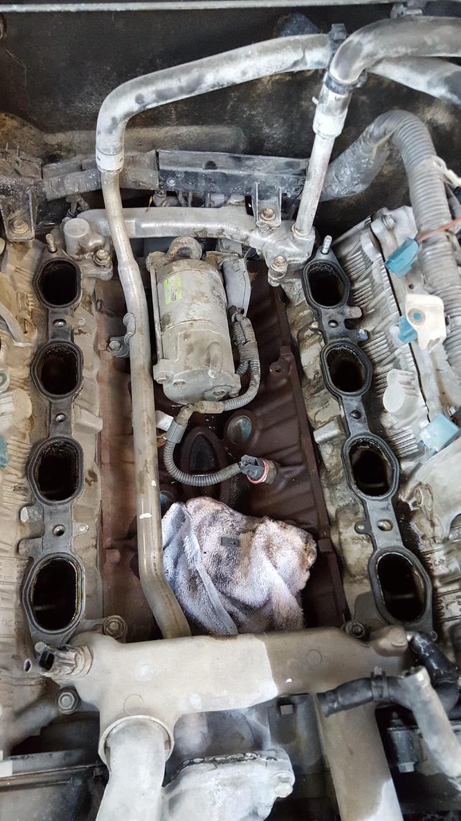

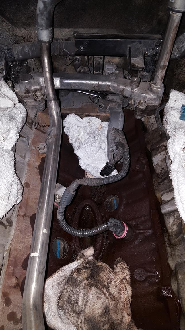

I feel your pain bro! Mine was under the intake manifold and I had about 2 inches of space to get those 2 bolts out. Man, I was spread out on the engine, back hurting and cuts on back of my hands. I remember looking at the youtube starter removal. Not much space there as well. Hopefully the liquid wrench will loosen it up for you. You probably looked at this already
https://www.youtube.com/watch?v=2A3mjWpsQR0
Check out my pain!

Check out my pain!
Dang Mike that looks crazy! That's crazy you need to remove the intake manifold to replace the starter.

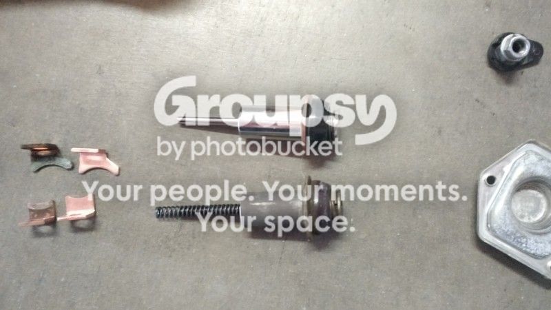

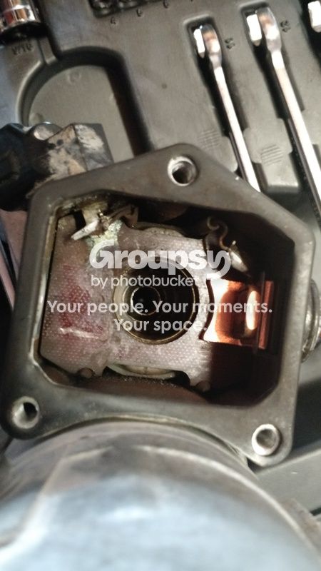

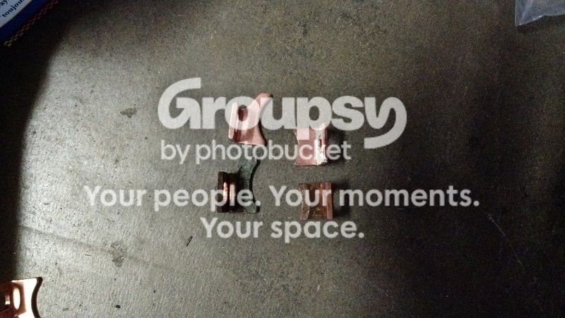

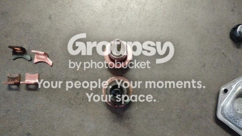

Here are some pics of the internal contacts. I was expecting worse but after some copper corrosion cleaner and new contacts/ plunger this starter should fire like new.
Thanks for sharing! Your photos are not accessible anymore. Would you please re-upload them, probably somewhere else?
