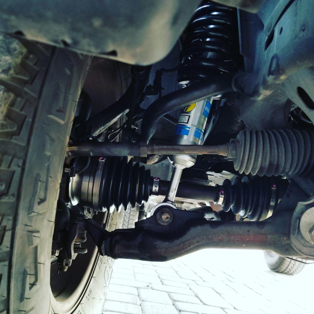

Ready to start, I have the ADD front 3.73 from an FJ, with new half shafts & hubs assemblies. I bought Bilstein 5100's and FJ springs to install while the front end is apart. Looks like with the diff drop I will not need to notch the V8 oil pan. I've done the twin stick mio to the FJ transfer case & have V8 4runner 4wd crossmember, driveshafts and hardware. I believe everything will be a bolt in except cutting the shifter hole & modifying the levers to properly fit the coin tray.
Front end done

Nice work. Would love to hear more about the different components you used and any issues you ran into.
The front end is all bolt on, very straight forward. I've put ~1000 miles on it with the ADD axle & my fuel economy hasn't changed measurably.
