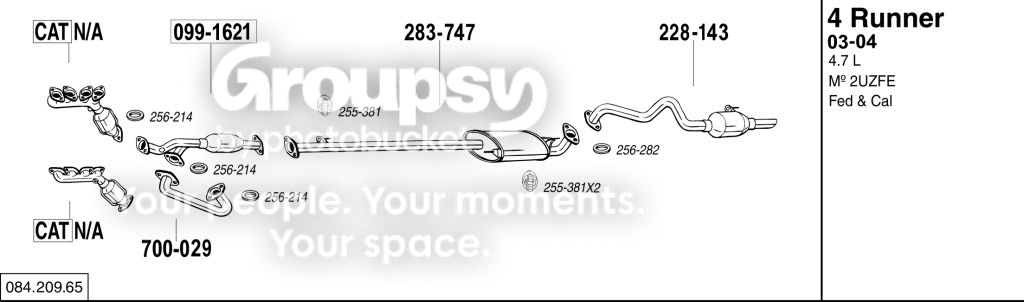

my truck is at the dealer right now, and from what I understand they're replacing at least one of the cats under the sulfur odor TSB. I also definitely have the 'tick', and they're looking to see if one or both manifolds need to be R&R. so if it's the upstream cat, from that pic, it looks like the cat/manifold are the same piece.
4runnerexh.jpg~original
that is an 03-04 model. I know the newer V8s have 4 cats, because there are 2 of them (though are they just resonators? i doubt it) under the body before the Y-pipe. so maybe that's the catalytic they're replacing under the TSB. hopefully I find out today..
