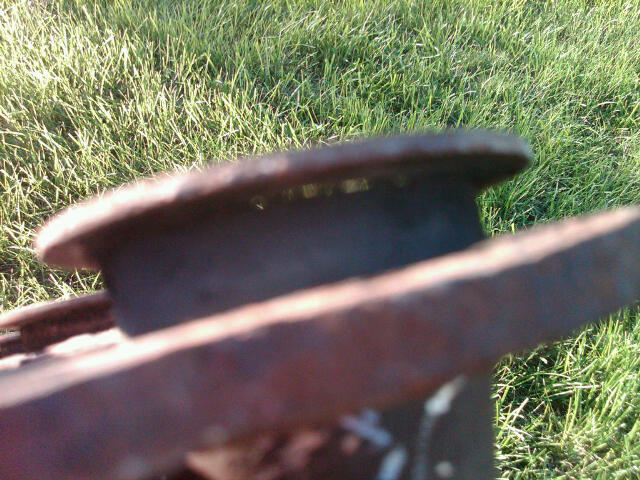

Well it took me quite some time to finish this little project with vacations, work and shear laziness standing in my way but it's finally all back together.
I was really hoping for the "leaky" gasket but in the end it actually was cracked right where I expected based on pics posted by others. It does look like it can be welded but I chose to just end this fun and get a new one.
Here's a pic of the outside crack:
