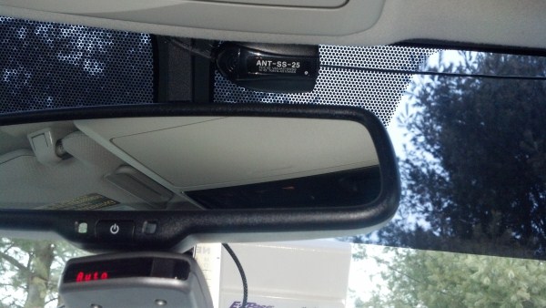

BlendMount makes a quality bracket, but it's pricey. Installed an Escort with Mirrortap harness, easy install, wires just slide into back of Auto Dimming mirror plug (power & ground) on back side of mirror. Can't remember wire colors, but a volt meter will verify. Slick setup! Sorry I don't have a better pic.

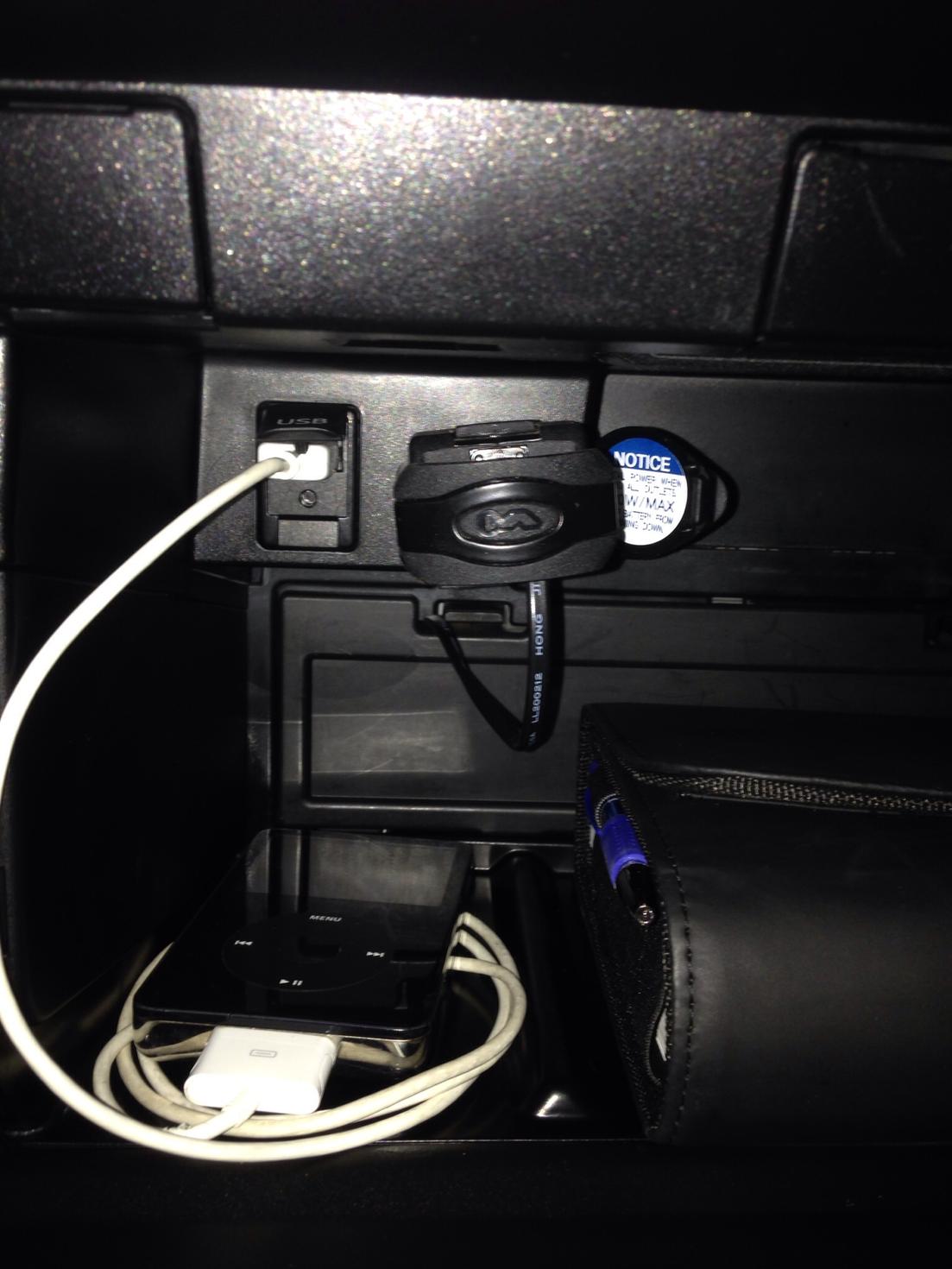

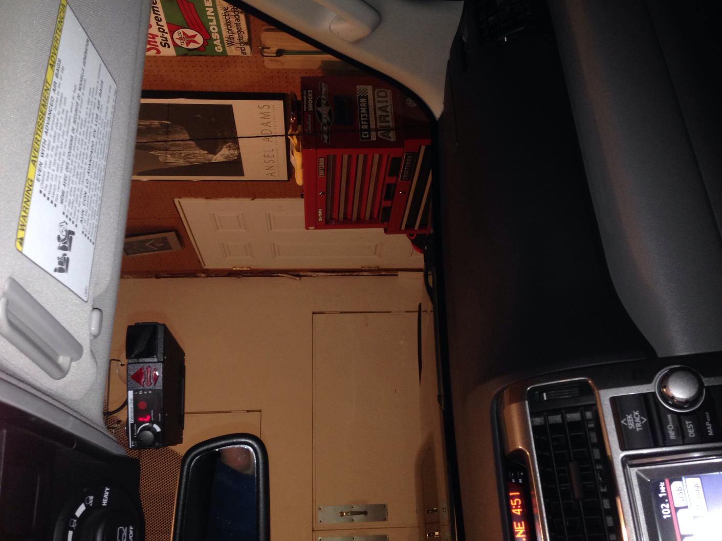

I just did this in mine. I have a V1 and just used a phone cord (make sure the cord works with the detector before you start) and ran it between the windshield and molding on the top, over to the A pillar. Down the side under the curtain airbag molding into the underside of the glovebox and plugged it into the 12 volt outlet in the glovebox. It looks permanent but is easily removable. You don't have to splice wires or anything. You did ask for the easiest way. It took about 5 minutes. Hope this helps.
