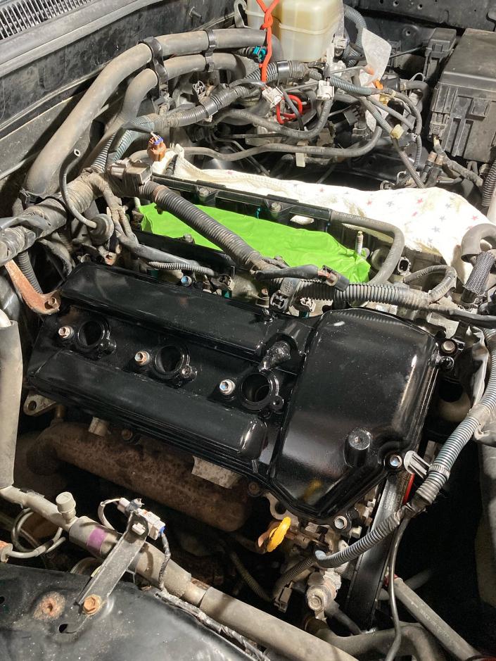

I've done it on my 2004 and it's really not difficult. If you download the FSM from the sticky on here and find the section about doing the valve cover gaskets, it should be straightforward. I agree that time is going to be the reason shops want to charge a lot.
I just replaced mine when replacing the exhaust cam timing gears. Probably plan on approx. 3 hours with taking your time. Make sure you run a sealant a directed for the seam towards the front. To be safe I added a thin bead all the way around (didn’t want any leaks).
I used the Toyota FIPG seal packing gasket sealant but a lot don’t spring for that. If you’re anywhere close on maintenance you might as well replace your plugs while you have it apart since they’ll be exposed anyways.
Passenger side is super easy. You need FIPG or black rtv to seal two joints on the front of head. Can be done in 90 minutes.
Important note: do not over-torque the cover bolts. The cover bottoms out on boses on the head cover. If you over-tighten it, the cover will crack.
